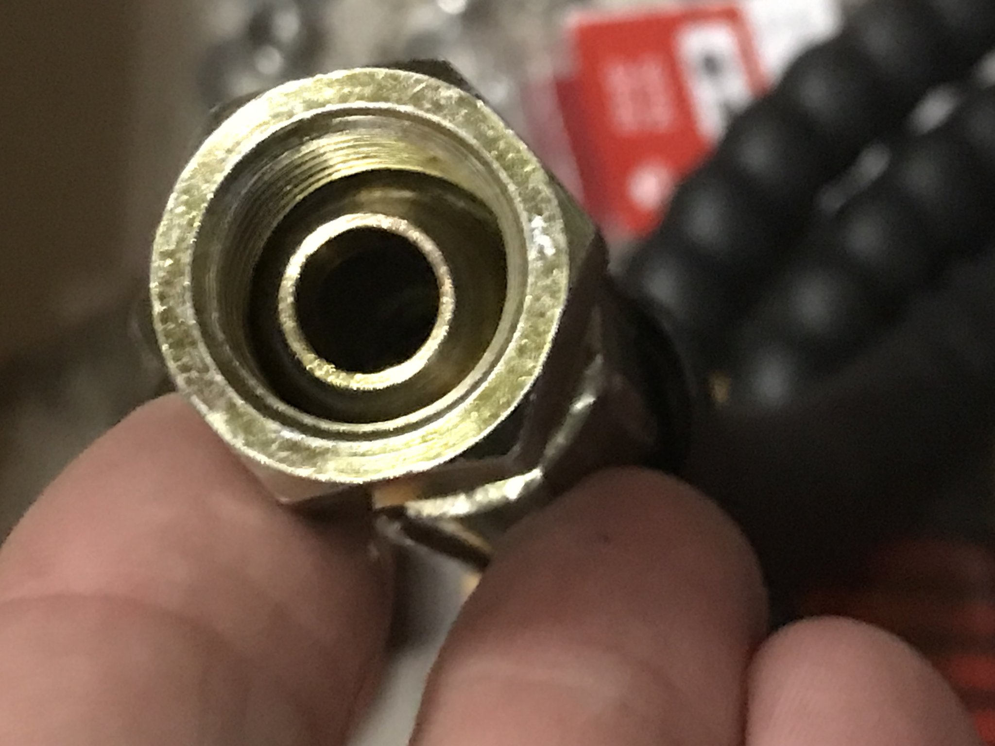

Hey folks, I recently (last month) purchased my first tractor (larger than a “garden” tractor), and found new things to do with it. So I purchased another loader attachment (my wife is still okay with me.. so far!)
this is a tree/bush puller. It arrived, looks okay (I would have covered the hoses), but I immediately ran into an issue…. My Kubota l3902 uses 3/8 flat face, and the implement came with 1/2” flat face. Being in the boonies, I ordered a set of the appropriate connectors. They arrived today, but… I can’t put them on. Turns out there is a male nipple from the hose to the the quick connect, and the one on the hose currently is a 3/8 to 1/2.
I think I finally identified the connector as a JIC to NPC fitting…. But I can’t find any to purchase? My semi-local dealer said he hadn’t a clue, of course.
the fitting has an inverse flare on the 3/8 side (which means it’s jic, right?)
any help would be appreciated!

That is possibly NPTM ( National Pipe Straight Mechanical) not JIC:
Look on the bottom of the page for a cut side look at the threads.
FEMALE PIPE SWIVELS (NPSM)
National Pipe Straight Mechanical (NPSM) fittings are similar to NPTF, except they have a parallel thread and seal on an internal 30° seat. A properly chamfered NPTF male fitting will mate with a NPSM female.
It could also be a Metric or BSPP thread, hard to tell by a picture.
One way to tell is if it's NPTM it will thread into a female NPT fitting easily.
This will help you figure it out:

Ahh…. Thank you very much! Okay…. a Standard pipe thread will not screw into the female… the 1/2 inch does thread into a standard pipe coupler, so that one is figured out. And it does match a standard thread gauge.
but the 3/8 side only goes in a couple of turns before it binds. Metric? Hmm.. no metric thread gauge.. (image that! Brief switch to Amazon….)
I thought about replacing the hoses entirely, but the cylinder fittings are the same thread, so my option is limited to cutting the one end of the hose end off, and hoping my local shop can crimp a new end on…. I’m hesitant to do that, as it seems to be a one way/one shot try. They weren’t sure either…
I can’t tell if this part:
is what I need. It doesn’t have a diagram of what the ends are. It looks like NPTF on one side, and standard pipe on the other…. which is what I need..
Any thoughts?

Are you trying to go from the hose (male "flare fitting") to an adapter, to the flat face?
A photo of the hose end would help if so.

okay, here is the hose end, and the fitting assembled as I got it, with the 1/2” flat face connector. I naively thought I could just order a 3/8 flat face connector, and pick up a different bushing. Silly me.
on the assembly, you can see it goes from flat face to bushing to hose. I’m “just” trying to replace the flat face with a smaller one.
Thanks for all the help!

That looks like a BSPP male and female connection
see this link to see if it helps

The smaller end is not JIC. Looks like standard male NPTF. The cone seat is used to mske the seal when a female pipe swivel (NPSM) id screwed on to it.
The larger end has PTFE tape on it so its most likely tapered pipe (NPTF).

Nothing silly or naive. - thats all you need. The hose swivel is female pipe. What is the port thread on your new coupler?

So, BSPP for the win! Got in my 3/8 adapter before I got in my couplers, so hooked them on. works great!
thanks to everyone who had ideas, and especially to those who got it right!
