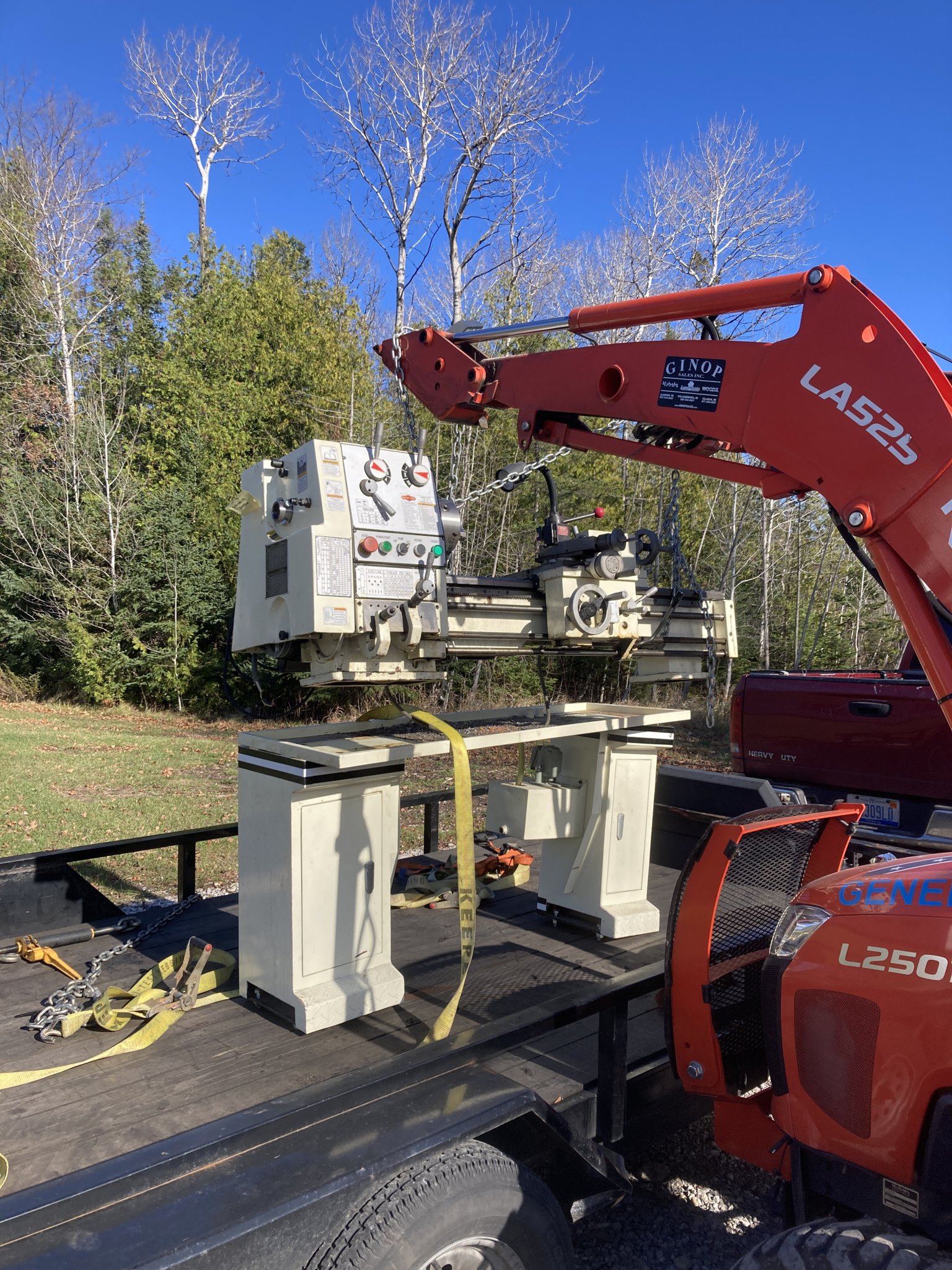

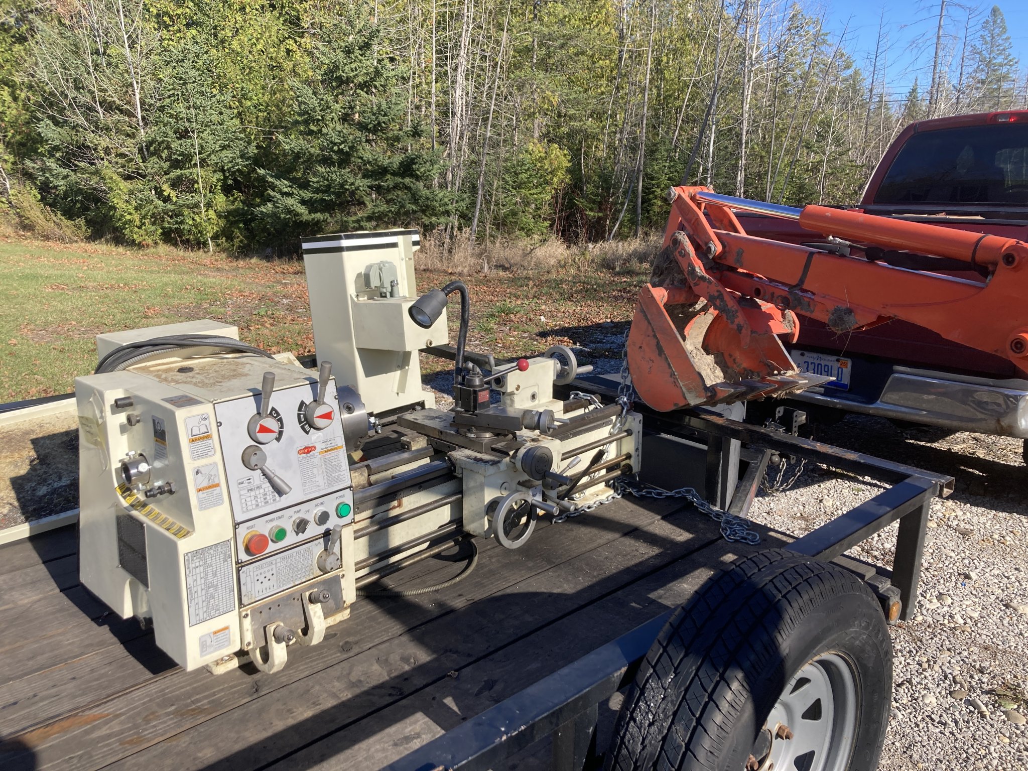

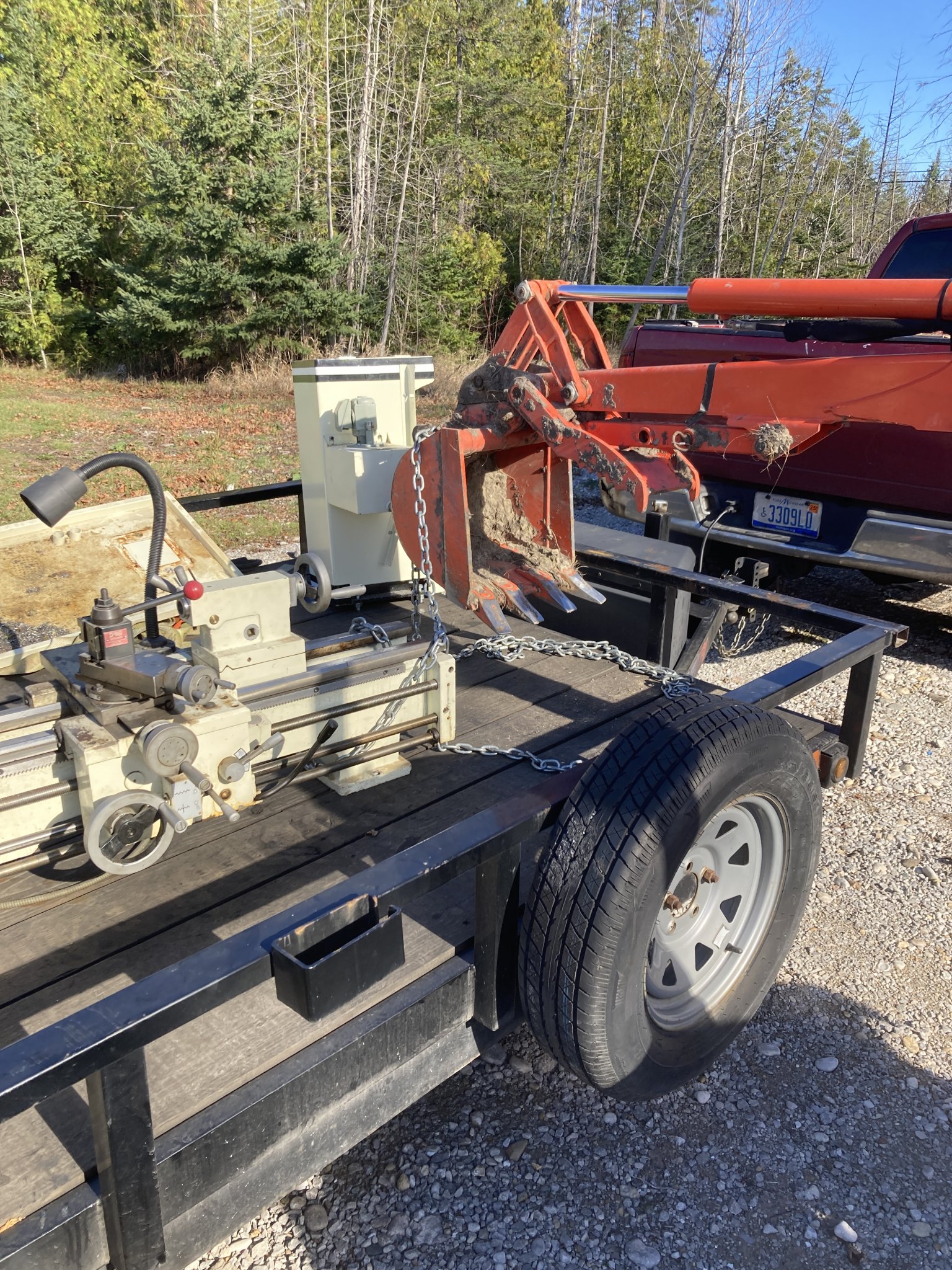

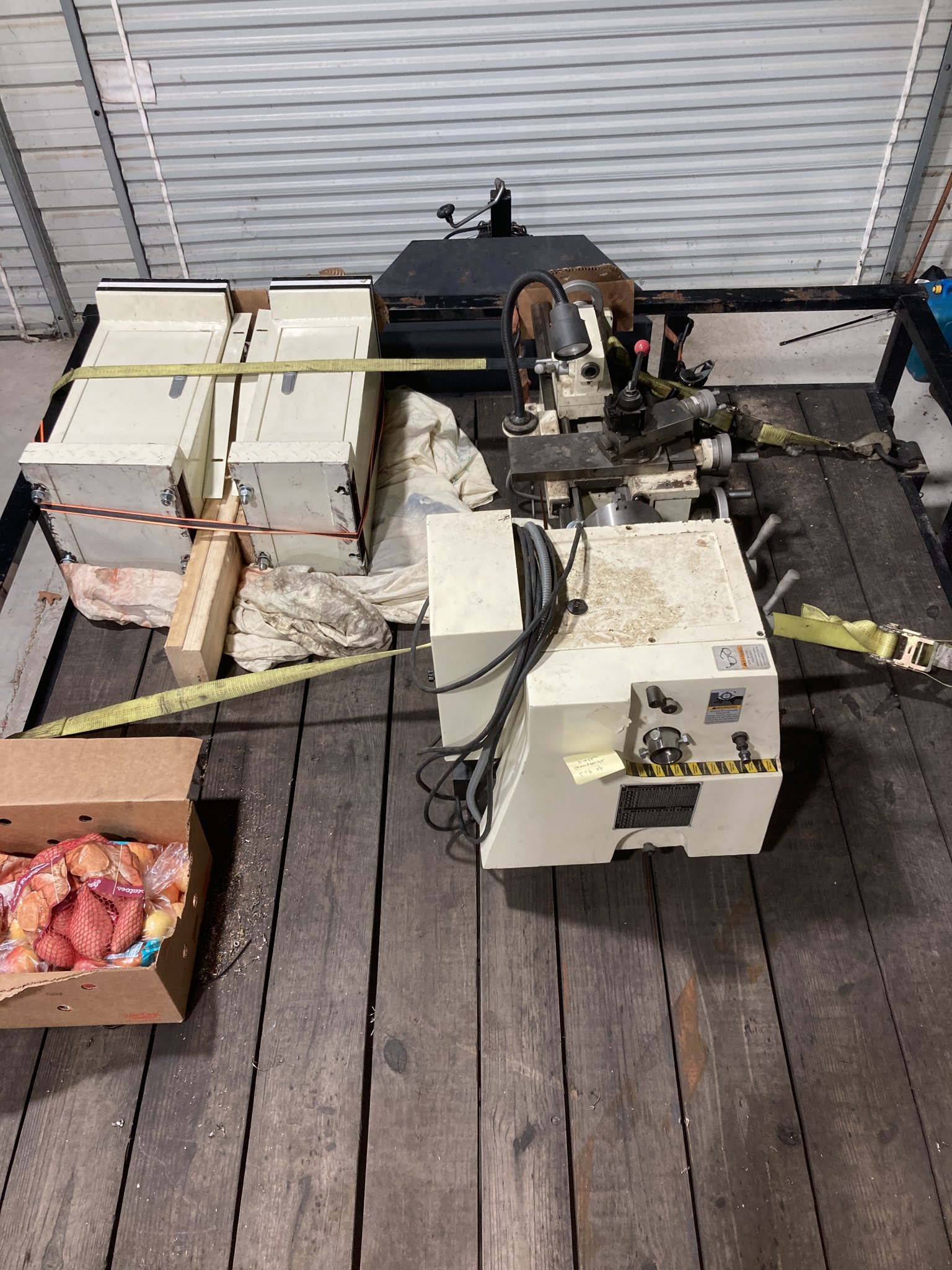

Well I "accidentally won" an auction for a "gunsmithing lathe" and had to go pick it up the other day.
The ride back to the cottage was "uneventful" but also uneasy. I had it strapped down "good enough" with ratchet straps and 2 chains, but the "top heavy'ness" made the ride back "uncomfortable".
Maybe it was just in my head, but there was this "constant nagging" in my head that if the base snapped it would be "lights out".
I decided to take it apart to transport it home (4 hours on the highway) and I wanted it up against the front rail so that when I hit the brakes it would not slide forward
I used the FEL to "dismount" it from the base, but needed to drag it forward about a few feet.
I tried to slide it by had, but "no bueno"
Then it hit me, "General Jackson" would work perfect
"Snug as a bug in a rug" and almost ready for transport.
A little more disassembly, and "re rigging" and it should be an "easy drive" today.

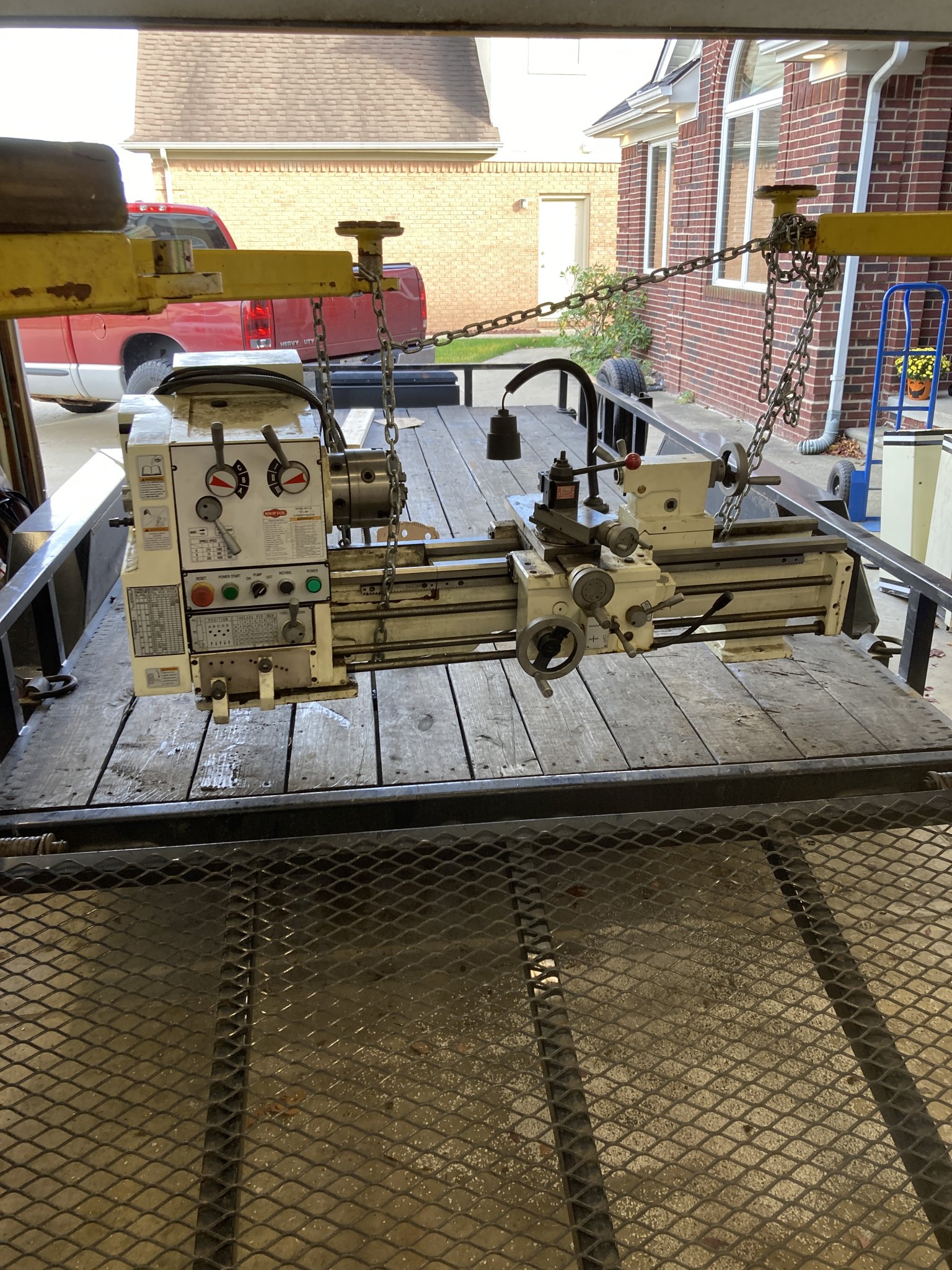

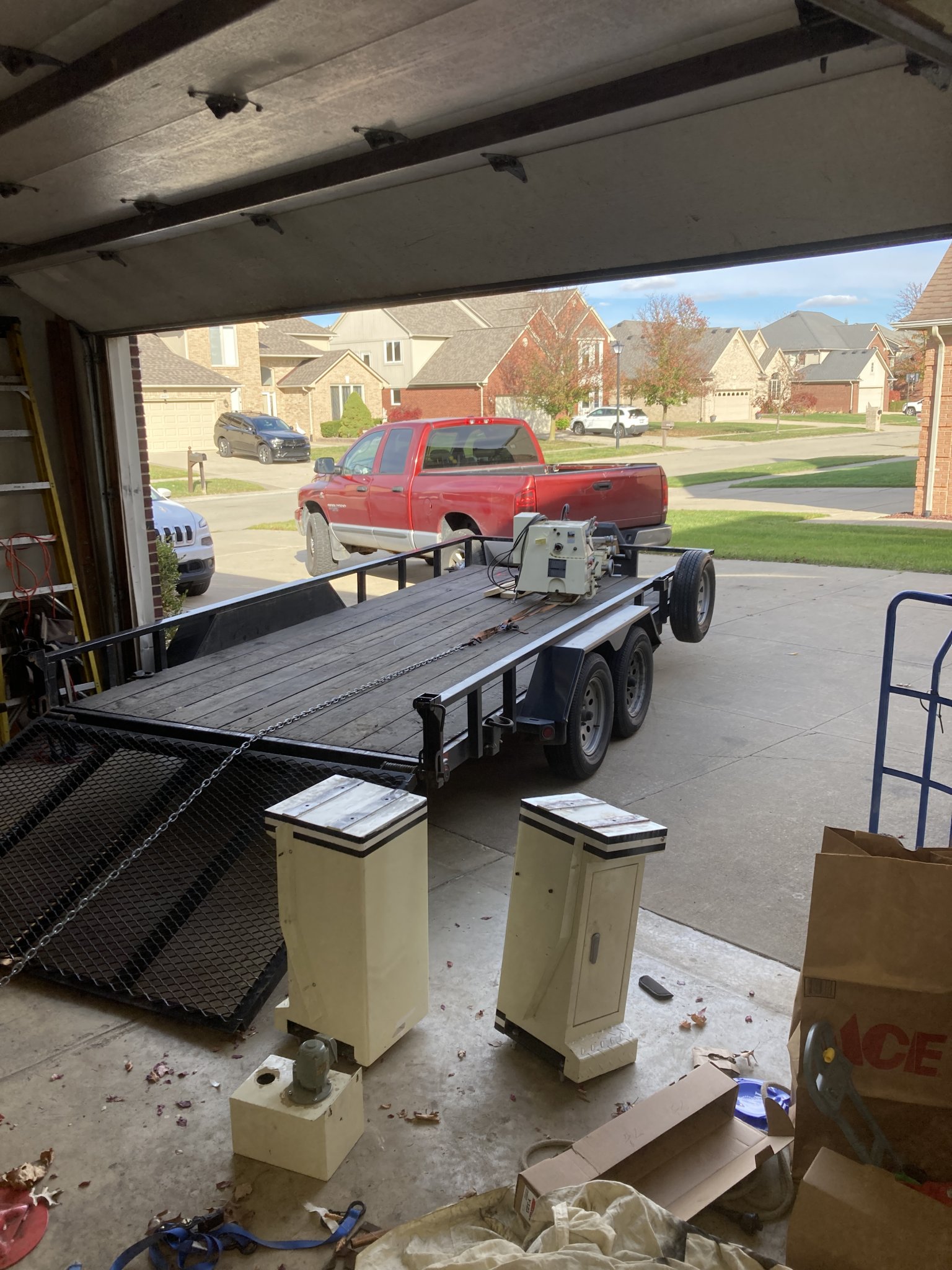

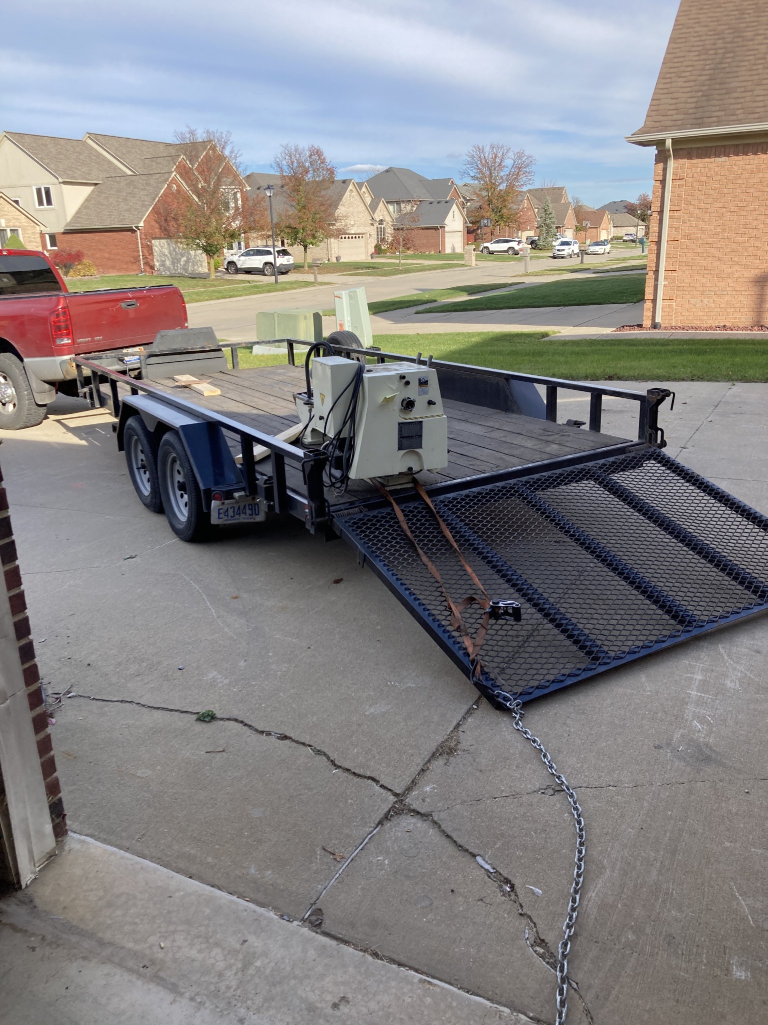

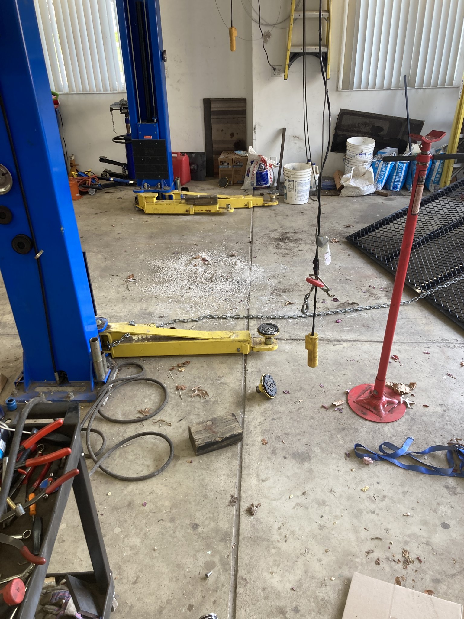

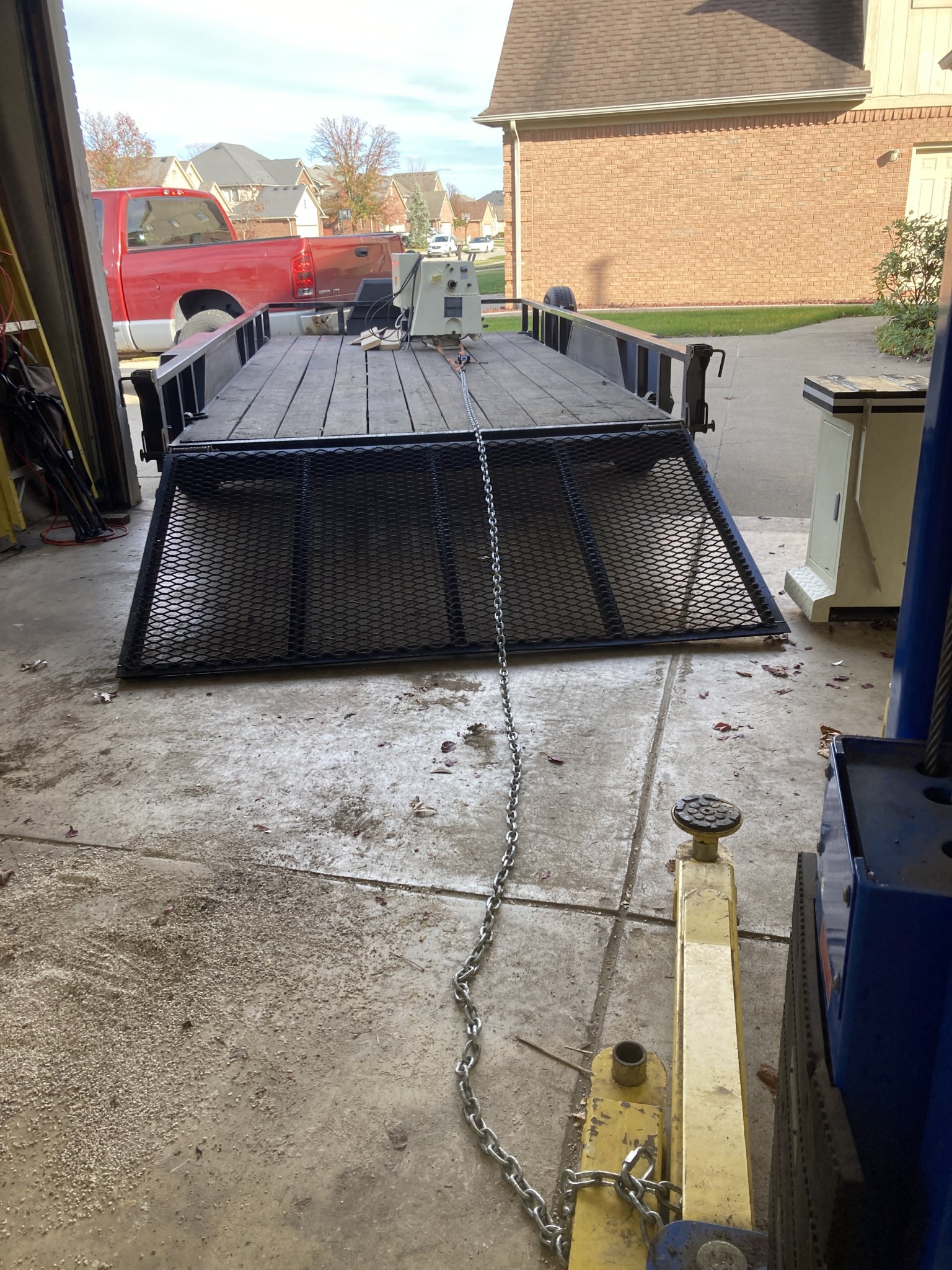

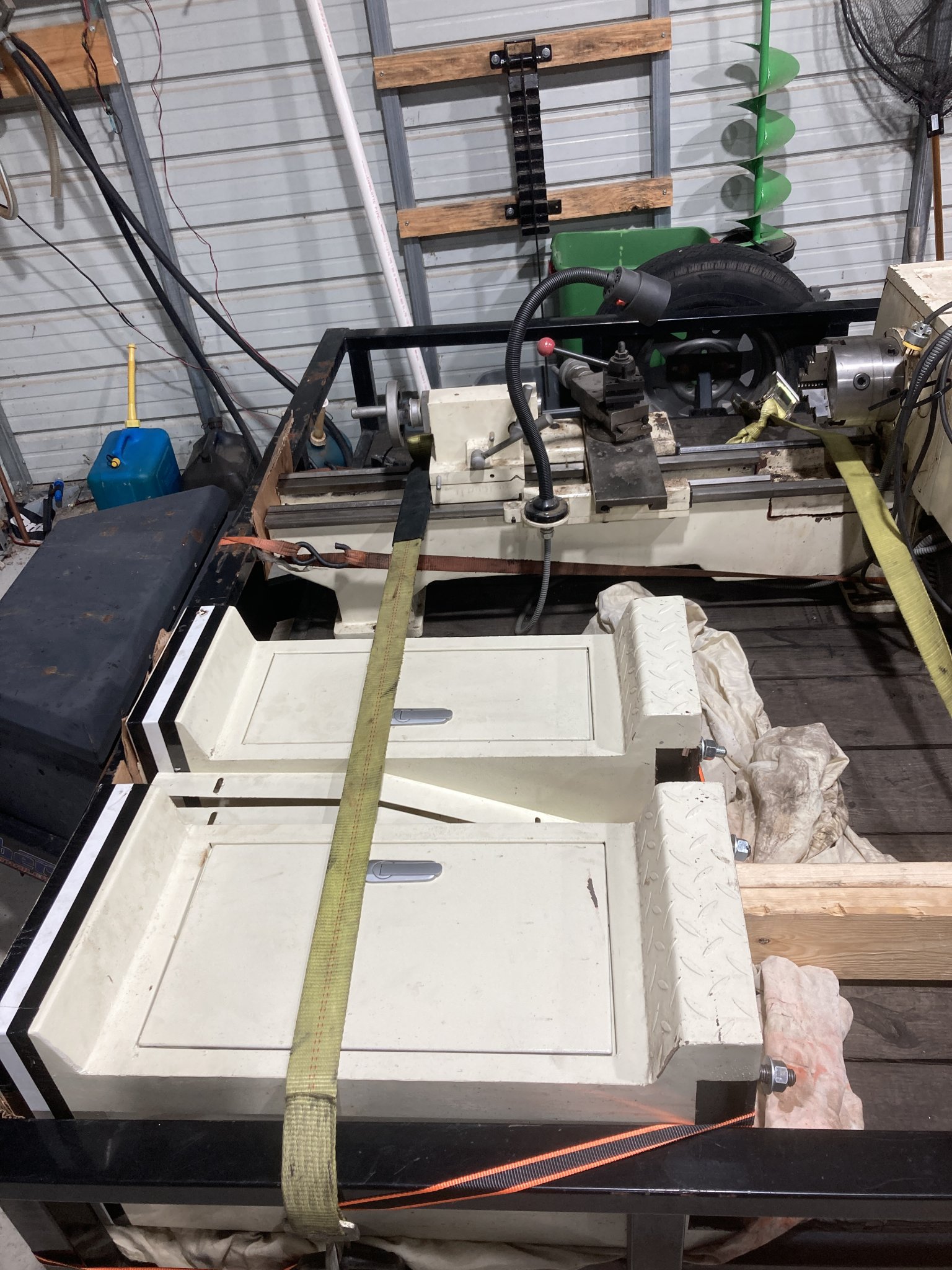

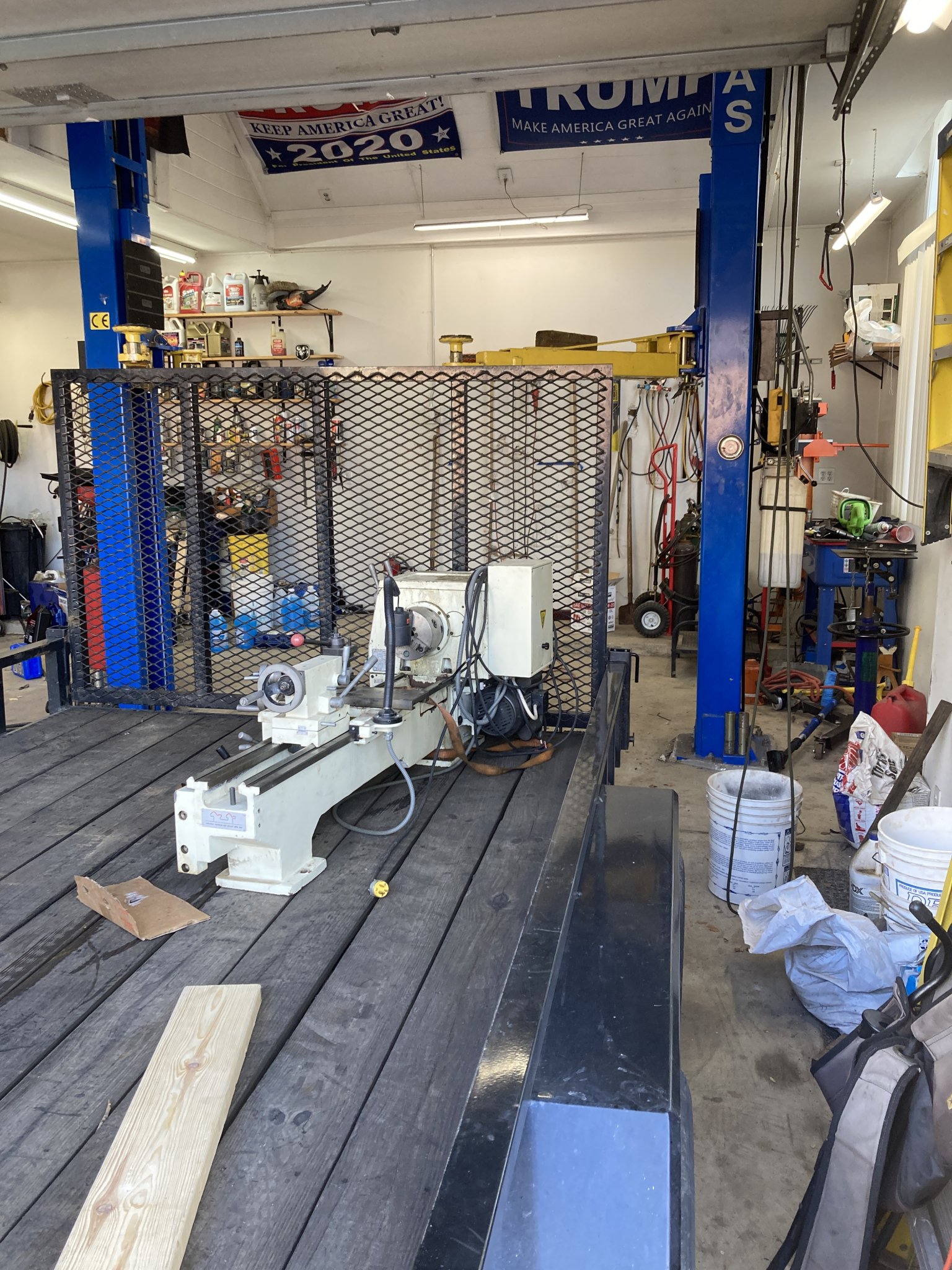

The drive home was absolutely "worry free"
and offloading was a breeze.
The hardest part is backing my trailer into the garage.

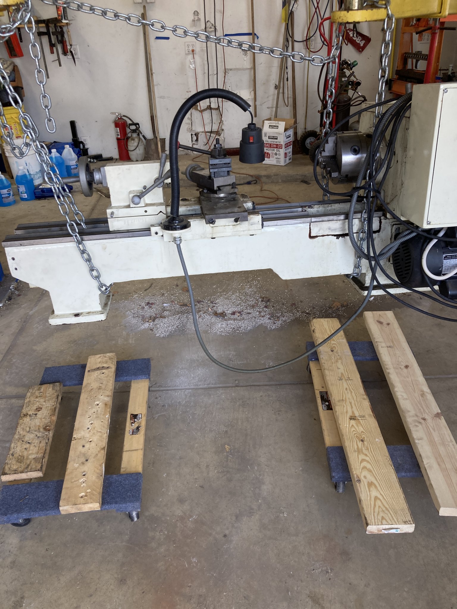

Then I had to "drag it back" to the end of the trailer. So I hooked it to the hoist.
Then pulled forward until it was "dragged" to the end of the trailer.
Then lifted the hoist arms up and over the ramp. (only had 1/2 inch to spare)
Then put it on some of those HF furniture dollies just so I can move it around in the garage.
Now I gotta clean it up and figure out how to get it into the basement.

You gonna use it to peel that box of taters that was sitting on the trailer? 🙂

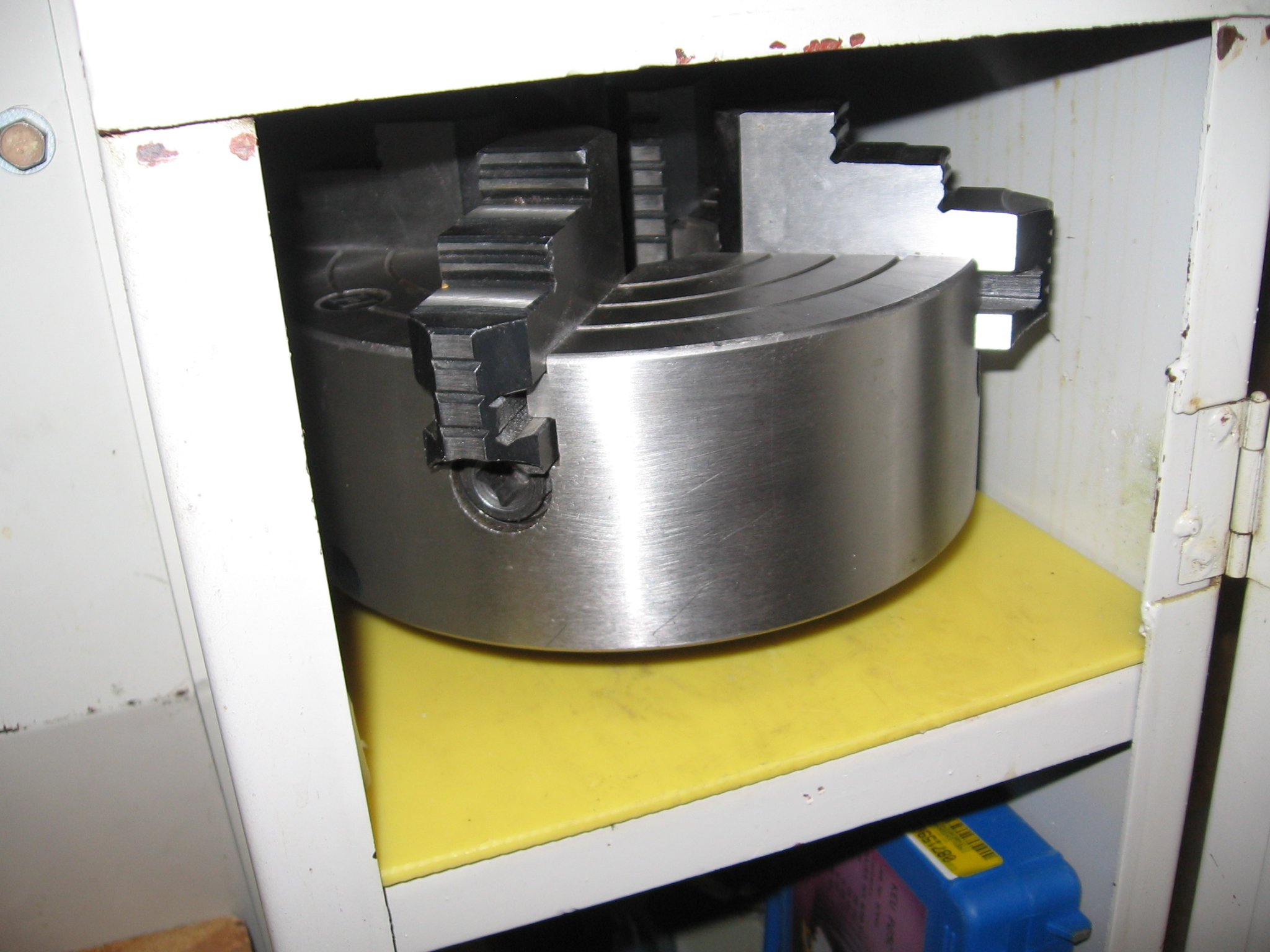

Nice pick up.
Virtually identical to my Birmingham, slight differences in electrical button layout, headstock end cover, and work light.

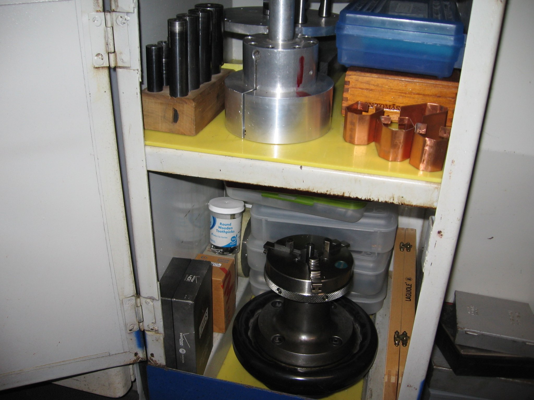

See if you can find a thin sheet of slippery hard plastic to line the shelves in the base column cabinets.
If you store the chucks, faceplate, steady & follower rests in there, you'll thank me.
As for the move to the basement, this should work pretty well:
Seriously, however you decide to move it, pull the chuck, tailstock, end cover, work light, & tool post.
Every little bit of weight removed helps.

What does the plastic liner do?
And yes I plan to strip it down to "parade rest" before moving it.

Many forget about using the lift arms to unload trailers and truck beds.
Chucks & stuff are heavy, door is small and at an awkward level, plastic just makes it easier to slide stuff out to the front.
A lot of stiction without it.
Mine was made from one of those large "wet floor" A frame signs that blew out of a truck on the freeway.

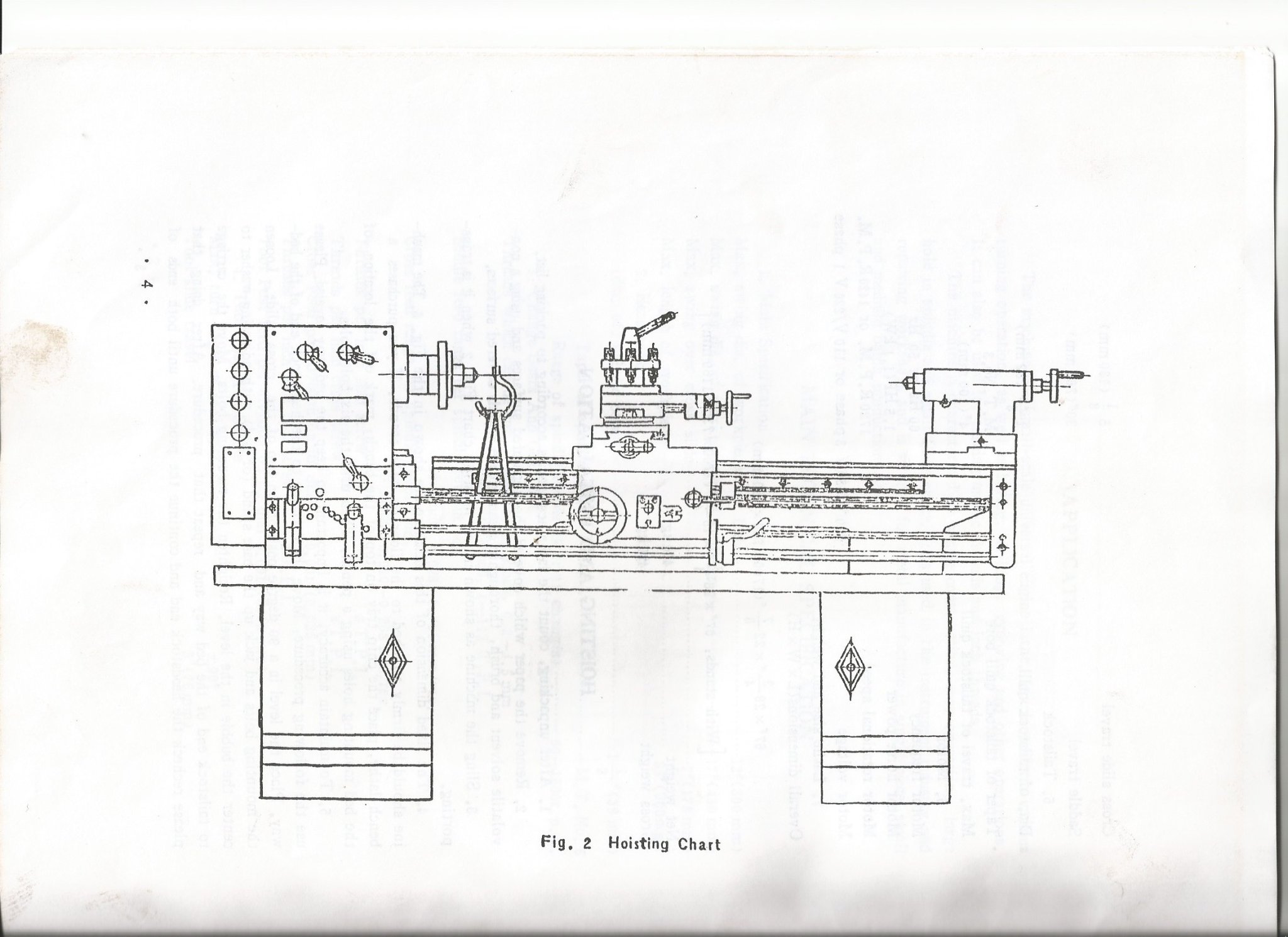

If I remember right, my folding shop crane moved it pretty well (stable) when slung as shown below, and gave lots of easy "wiggle" when trying to line up the holes to bolt the base legs back on.
Mine doesn't have flood coolant, but I sealed the machine-to-chip pan interface with RTV, because maybe someday I might.
