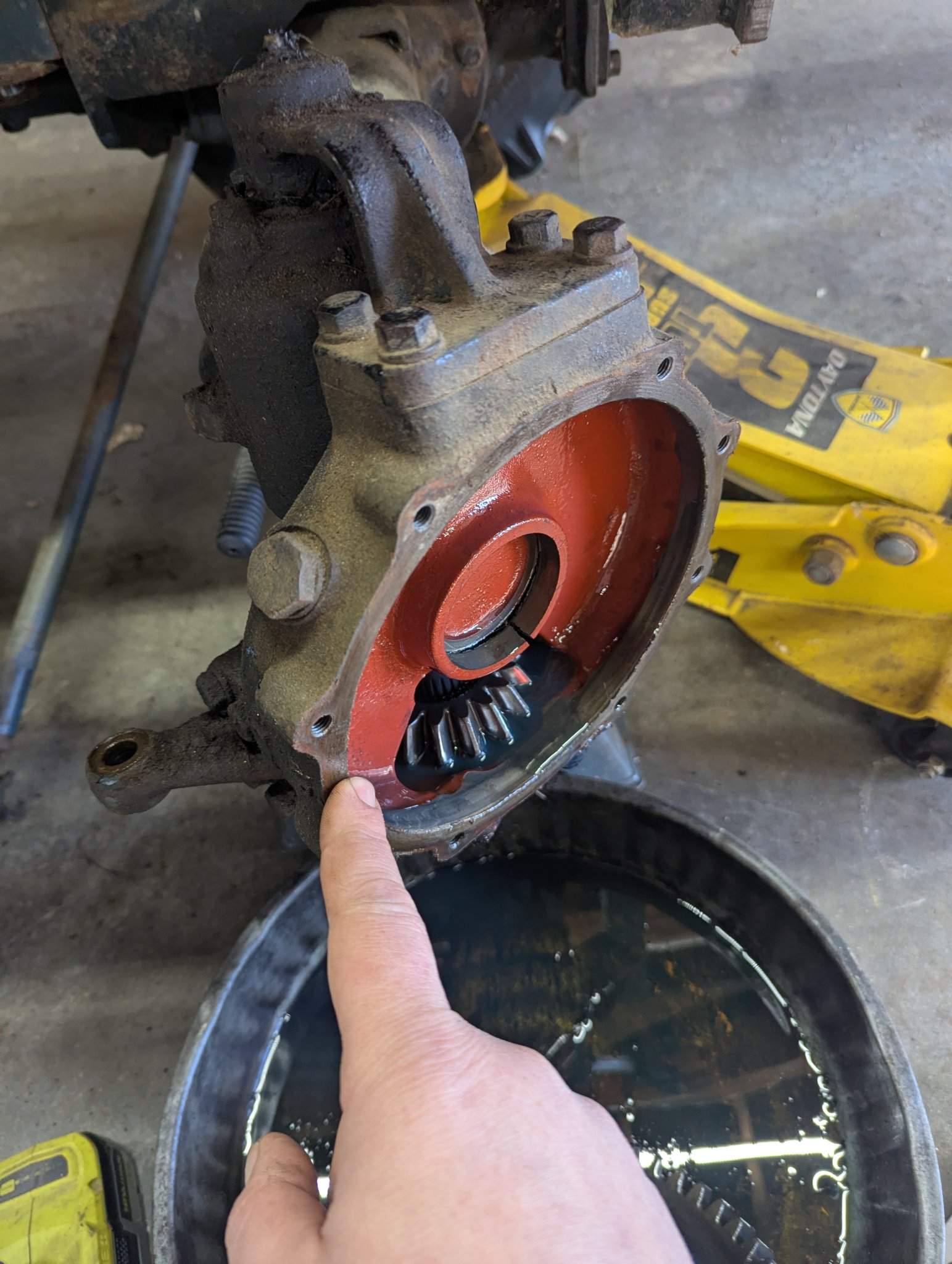

WTB: Kubota L185DT right front knuckle/gear case
RKSpees
L185DT
Sep 16, 2021
10
04358
Believe part number is 37720-43540 . Please message if you have this part, will take care case. Can see in pic bearing "boss" is cracked. Thanks

If you can’t find it there might be a way to repair or replicate the existing part.
I can’t really see how “broken” that boss is but it looks like it has started to rip off the backing plate. I also have no idea what is behind that area or how thick it is but…you could possibly bore through the part removing the current boss and replace that with a steel boss that is then bored out to the inner diameter for the outer bearing race. If there is something on the backside that couldn’t be bored through, then possibly just machine a pocket for the new boss to sit into. I would probably try to make the pocket as large of a diameter as possible and then put the boss in at that diameter and machine the bore and outer diameter (outer diameter might be okay to leave large?). There is a lot of “glues” that will be able to hold the boss in place (green loctite may be suitable).
Or get a good machine shop to machine the whole thing out of a billet of steel. I think you would probably spend more trying to get a fabrication made and machined than just machining a solid steel part.
Good luck!
Russell has a good point. They are doing some amazing work these days with the CNC technology. Like, 3-D porting of cylinder heads from seat to flange. Find an Industrial Injection Service (SLC) video on that.

Just wanted to close this want ad out. I contacted Lance at New Hall Tractor Service and the experience couldn't have gone any better. Thank you all for the help. The L185 rides(plows) again!
Lance @007kubotaguy is the man!
He's kept a lot of tractors running! ;)
