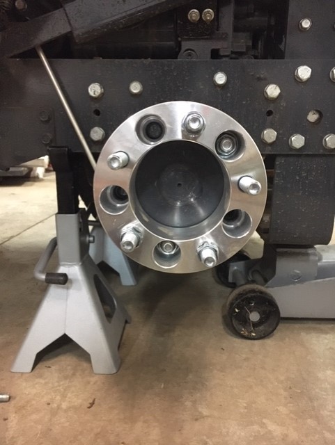

Two questions.....could you torque it to 96lb with that SP socket without breaking it?
And secondly I'd like to compare the diameter of the holes....mine are:
2.4 cm (24mm) or 31/32nds of a inch.
And I just noticed that you have 5 bolts to hold the spacer on. Did it come like that stock when you bought your tractor or did you have to remove the 2 studs (like I have on my BX2380) and replace them with bolts?
I had no problem torquing the bolts without damaging the socket. Let me measure my socket to see what diameter it is. I also have a set of thin wall Harbor Freight lug nut sockets which may be what I actually used.
I assume it came from the factory with 5 bolts and no studs. It was used when I bought it.

Did you get a chance to measure those holes?
I went to Lowes today to try to find a socket in 13/16 (21mm) that would go down that hole....but couldn't find one. Looked for Spark plug sockets ect...nothing that I saw would work. Then I went to a tire shop see if they could find a socket or for some advise. He said not enough space for a socket...but he did say I could either order 1/2" threaded lug bolts online or go to a trailer store which would have them possibly with smaller heads. Thoughts?

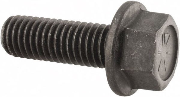

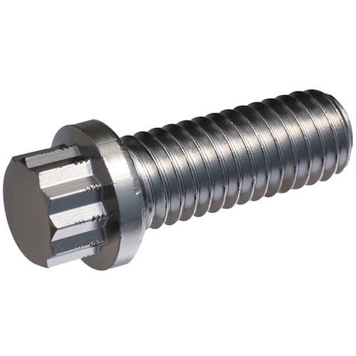

Being a Toolmaker with a shop, the options are almost endless for me, but I realize not everyone is in my situation. How about new bolts with an Allen, a 12 point, Torx, or a rebated hex head?
That would be awesome if they were tapered like a lug nut. Straight/untapered bolts wont work since spacer is milled for taped bolts/nuts. My internet search isn't bearing any fruit since most 1/2" threaded lug bolts have 13/16 heads on them.
7,282
2,236
Understood. Mine aren't tapered, assumed yours were the same. My bad.

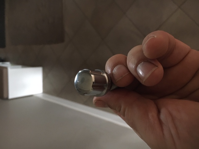

5. Studs on plate and spacer are 1/2". The nuts that came with the spacer are 11/16 and fit down the hole so I can order more of those from some place if I need them. Adapter = Spacer? Anyway, Kubuta for some reason doesn't do straight studs or bolts but both (3 lug bolts plus 2 studs with lug nuts on the rear wheels...BX2380). I don't know why they do that..but that is what they do. So can either add three 1/2" studs to the two existing studs to replace the lug bolts (possibly welding or good locktite) or find lug bolts with 11/16 heads..or a spline type lug bolt if it's not too expensive.

OK. I have a possible solution. Look into tamper proof wheel nuts. Some use a key that grabs the inside of the lug nut. That should give you room to fit. The negative is the cost to do it on your tractor. There may be a way but it's looking like the other brand spacers may be your best option.
I measured all of my 13/16 sockets and they all measure 1.095 (1-3/32). Measuring the holes in the spacers means I would have to remove a wheel weight to get the wheel off. I would guess that my spacers have larger holes for some reason.
I measured the counterbores in my spacers and they are 1-1/8”. Had to pull off a rear tire anyway to replace a leaking valve stem.
