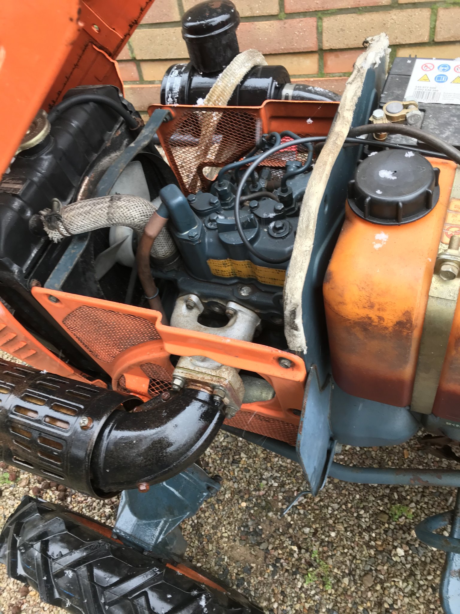

I need to open the gearbox and/or differential to find out where the noise comes from. The hard noise can be heard in first gear only, I have been told. Next week i will be able to drive and test the tractor when I have finished repairing the engine)

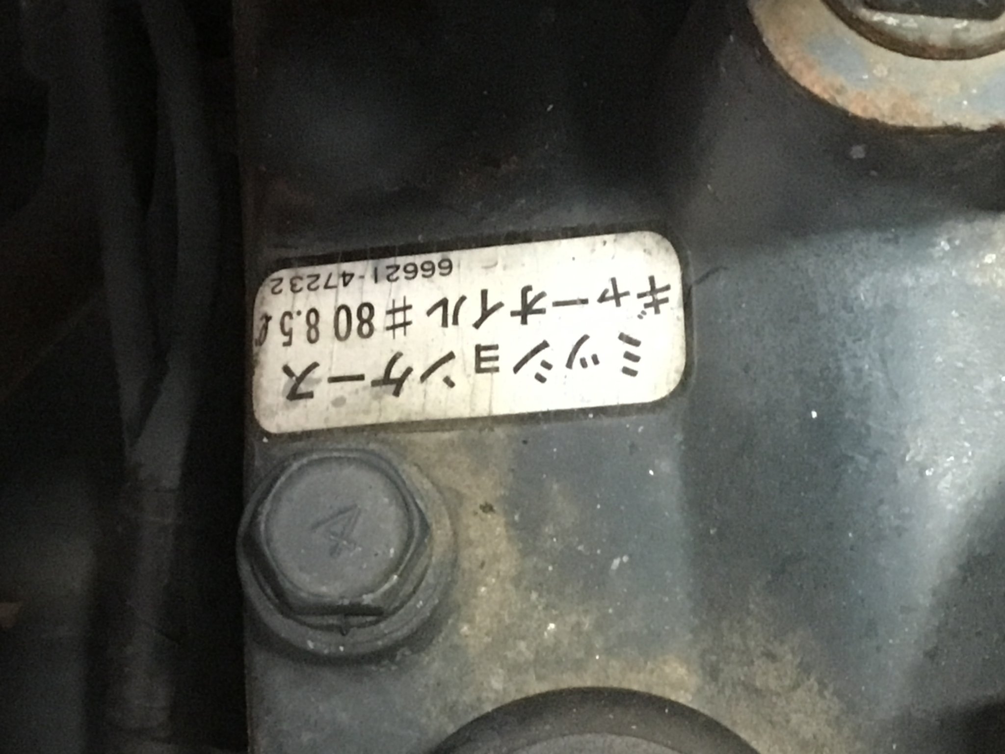

The only number that looks like a serial number is #80.852 66621-47232
All labels are Japanese.

Sorry no serial numbers found on the places you mention
Is this then a so called grey tractor?
Would it help if I send pictures of certain details which could tell you the correct model?

Yes if you would post pictures of the tractor and the motor, right side and by the injection pump.
There is also a cast Number (CC) on the right side behind the Hydraulic pump that will help too.
And a B5001 is most definitely a grey unit.

The cast numbers behind the hydraulic pump are:
508CC
810
??AC
?? Stands for a symbol i can’t recognis.
