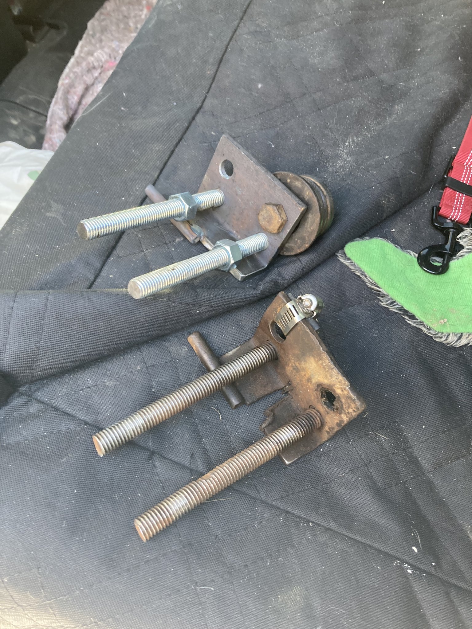

Asked a buddy if he wouldnt mind putting new rods on the adjuster... he ended up making a new one and offered to make a new one for the fixed roller as well.

Much has changed on the roller blade guide mounts. There are now 8 way adjustments.
technically this one is 6 way. It mounts on the arm that you slide in and out for the log/lumber size. I ended up cutting off that pin, the new one isnt bent to crap like the old one so it was rubbing on the bracket. Not sure what the pin was for, but the hose clamp holds the coolant line.

Technically the blade guide arm does not count so it is a 4 way. The way I see it from the picture, you can in/out and horizontally tilt. You are lacking the ability to up/down and vertically tilt. I am sure that those came later after more R&D. Gotta remember that 'your' sawmill was manufactured during the second year of Wood-Mizer's existence and it is still remarkable.
both can be adjusted up/down and in/out. Next time im out there I will take a close up. Now that they are all cleaned up. It will be easier to see.
