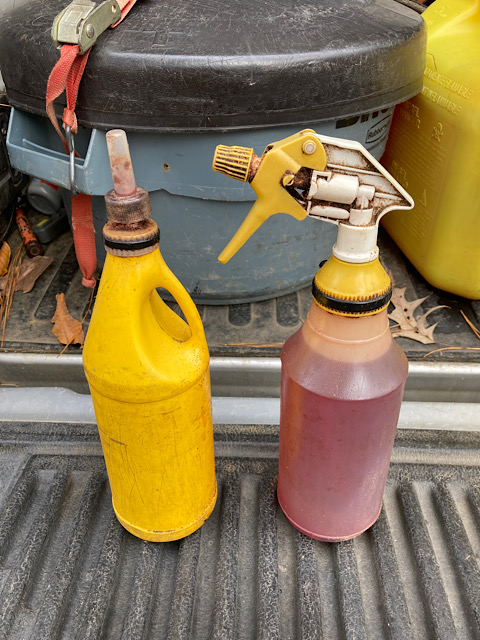

Use Automatic Transmission Fluid (ATF) on all of your chains. It does a good job with lubrication plus it does not attract sawdust. I use the yellow bottle for the chains and the clear squirt bottle for the mast and anything else that need lube.

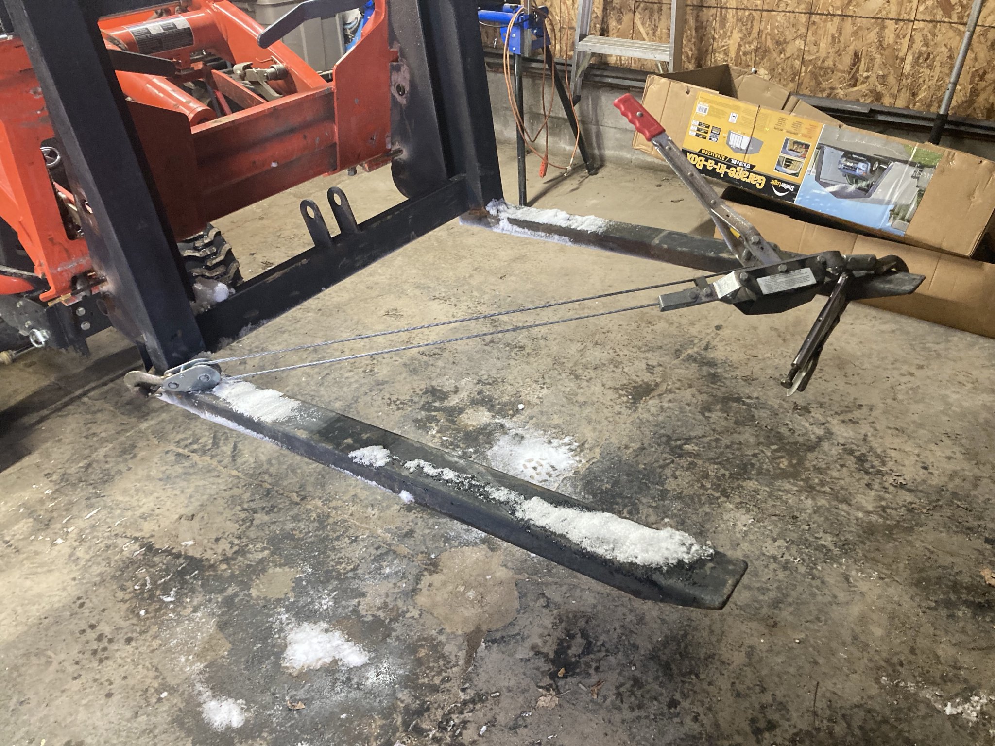

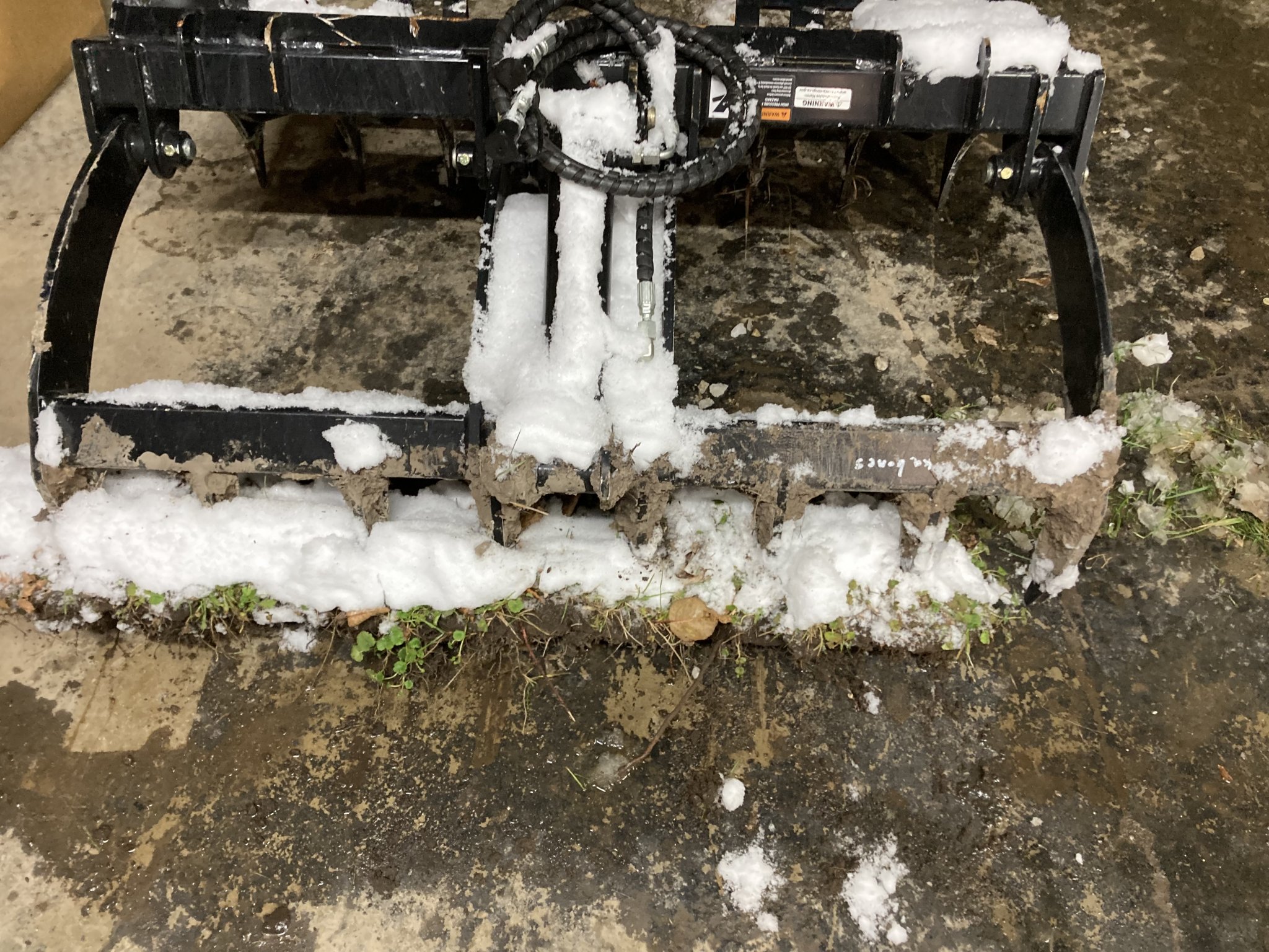

The forks I picked up, one was bent so it wouldn’t pick up the pallets. A come along pulled it in, I went past by 2.5” when I released it about 4 hrs later they line up perfectly. Moved some cedars I had in the side yard with them. Then moved my ssqa-v and put my bucket on a pallet. I need 1 more pallet then nothing will ever have to sit on the ground. I wish I got forks the day I Ordered the machine. I got some free pallets with the intention of leaving everything on pallets and off The ground. I waited too long to move the grapple and it took a chunk of frozen earth with it lol. thawed it in the garage and now it’s on a pallet near the mill.

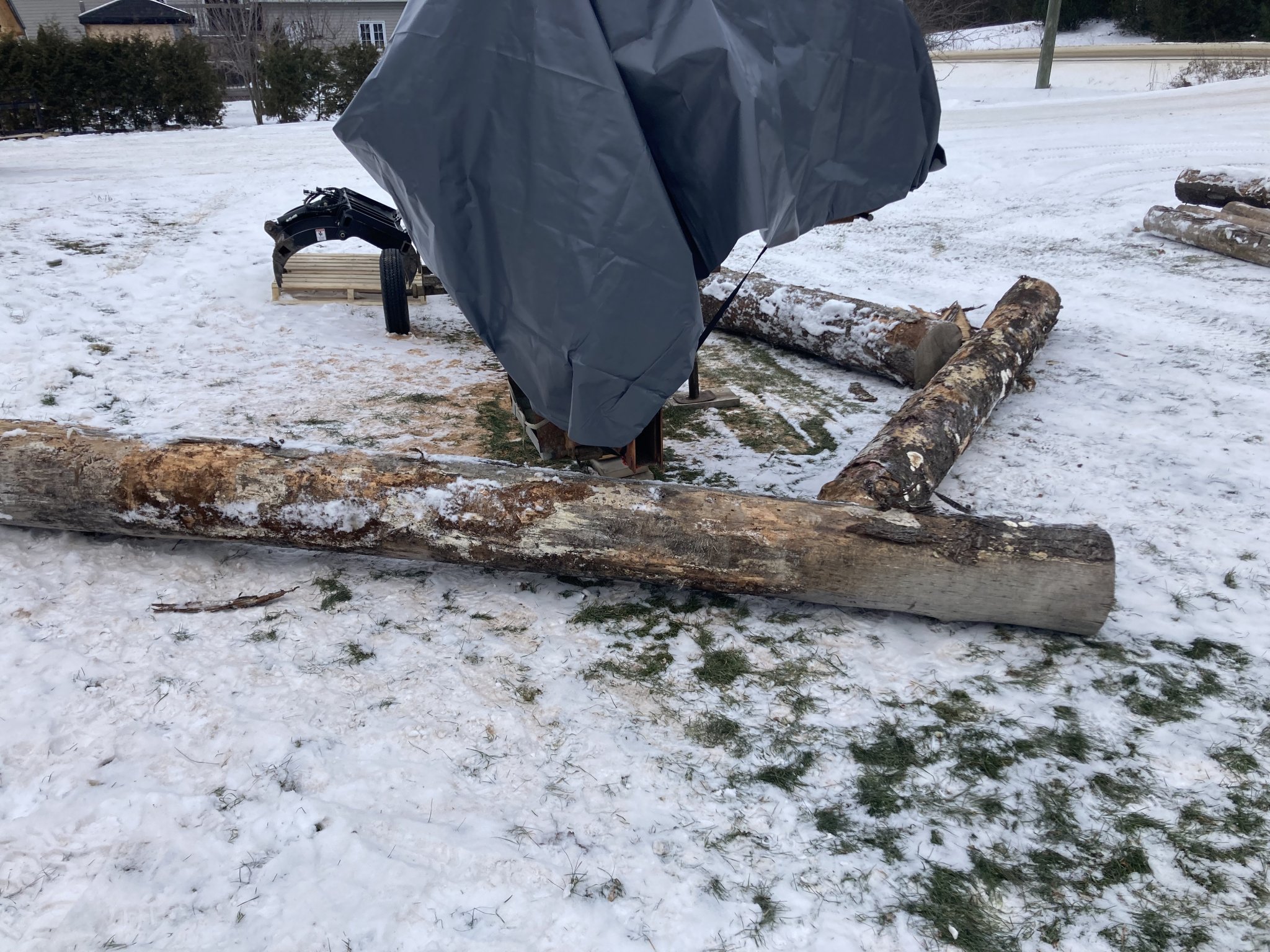

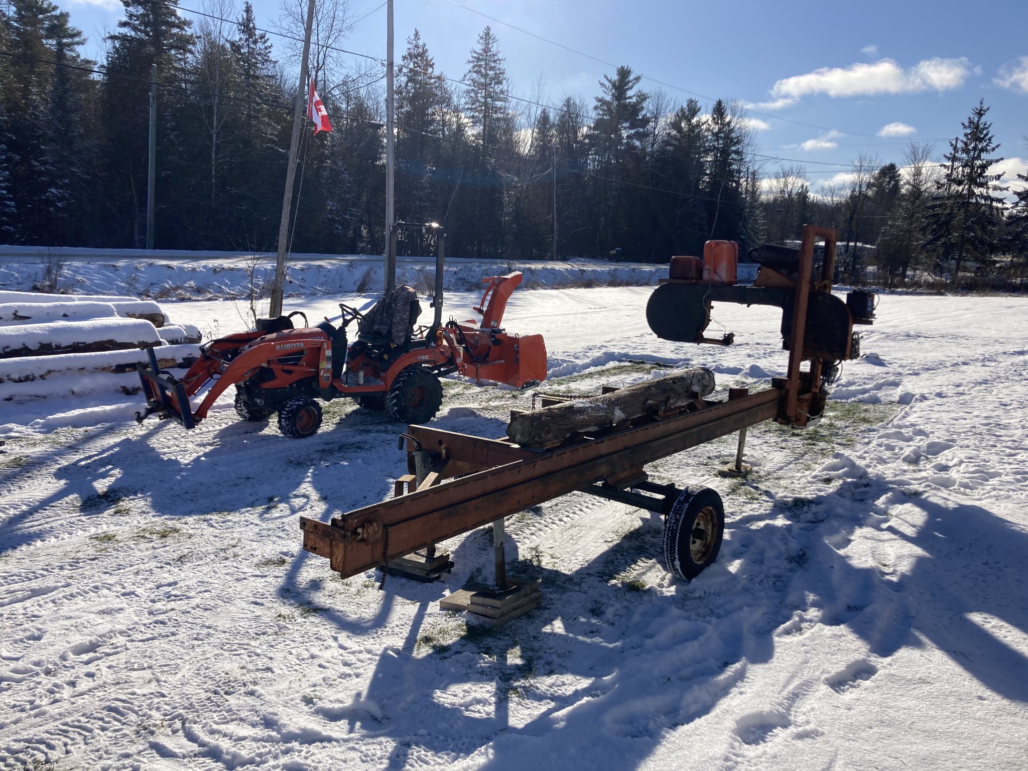

Pulled the tongue off the mill, and then used the forks to place the grapple and three heavy logs around it. Hoping that’s enough of a theft deterrent. I am debating on moving it to my side yard so it’s not so easily accessible from the driveway. Means more work for the BX, but running it’s fun. So it wouldn’t be too big of a deal.

Removing the hitch and moving the head to the front makes theft very unlikely. Also leaving a log on the sawmill would serve as a deterrent as would chaining the tires together.
I have never had a thought about my sawmill being stolen and I regularly leave it at my customer's location, sometime for a week or more.
We need some pictures of you sawing and maybe even a "YouTube" video.
I will get some pics and hopefully a video in the new year. i do have a small stack of wood drying. Good idea putting the log on it. I didn’t think about that. I did however move the head all the way to the front So it’s harder to lift.

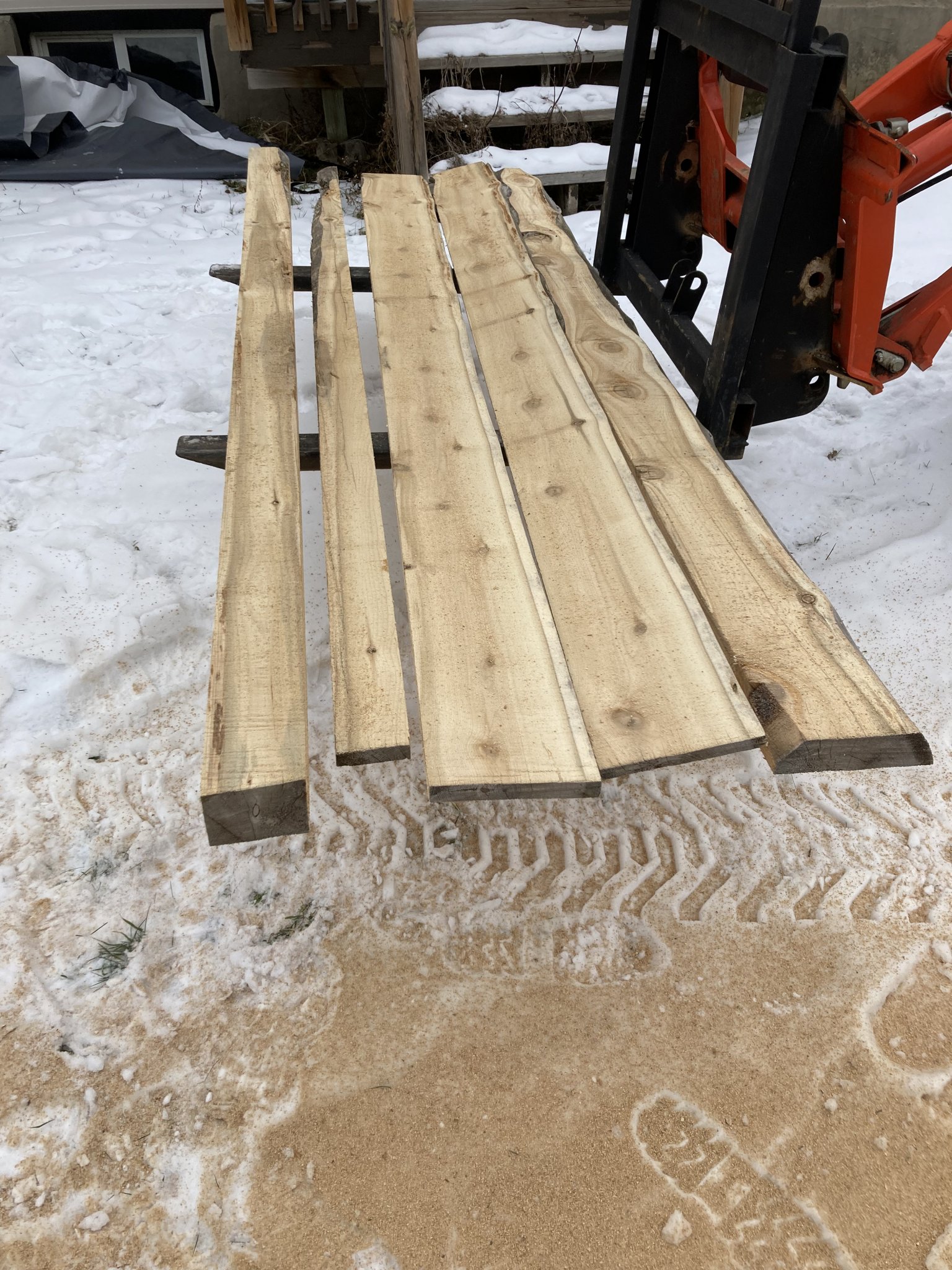

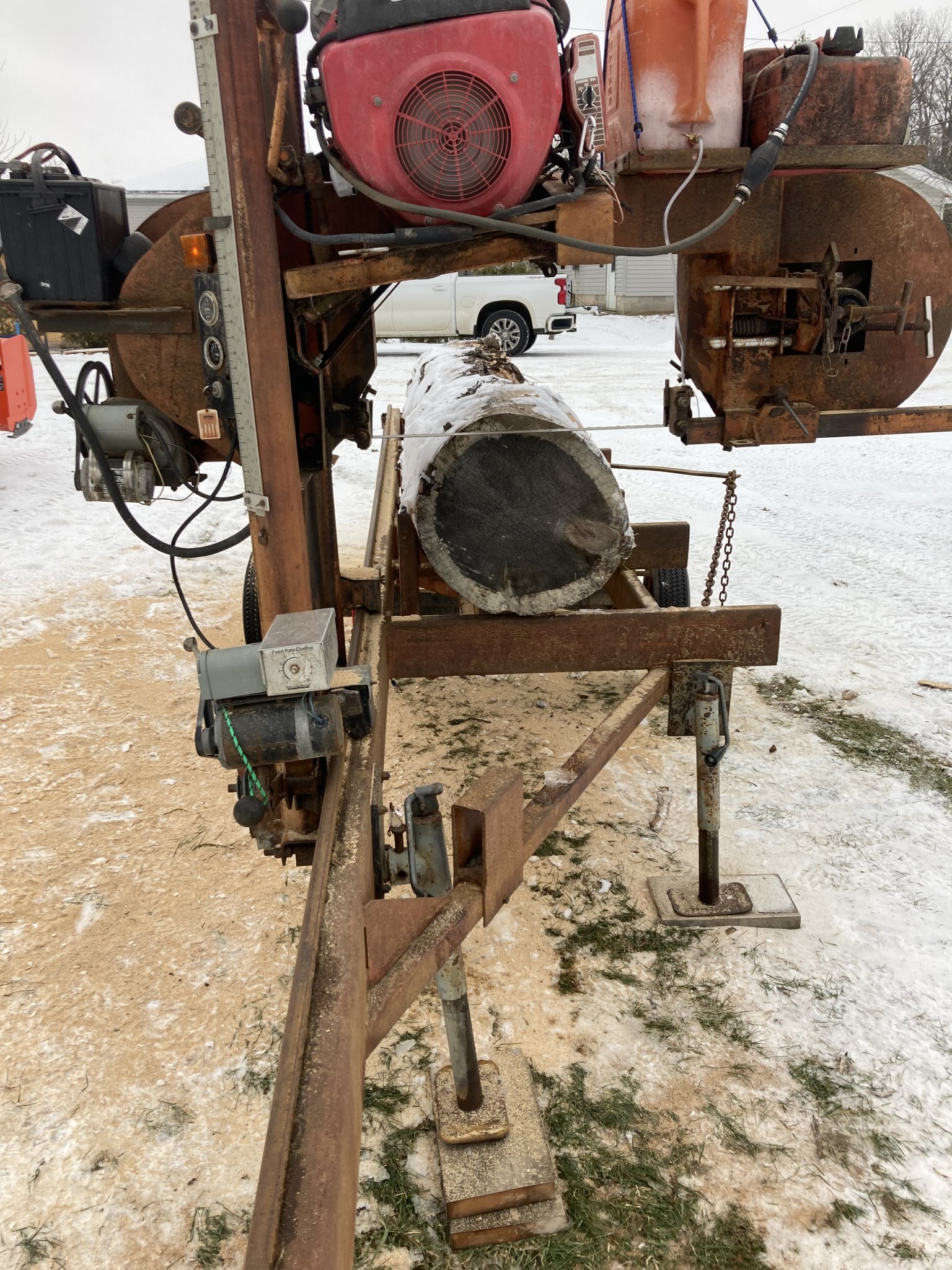

New Years even I decided to do some cutting. Managed to cut the cedar with no issues. so I decided to cut a big log I need 2x4s and 2x6s for my garage, I’m getting waves, I was cutting too fast. I need to repair the feed control and replace the 2 springs for it 1 is missing so I was using a bungee cord, the other one is about 90% rust. Hoping to get those today. The boards on the forks, I can get at least 1 2x4 and 1 2x6 10’ long from each. when i squared off the log, I cut a 2” live edge slab off the one side before I started on the 2x9 slabs. Going to make a couple end tables out of it.
this is the second practice log, mill owner told me to get whatever I can out of the cedars as the pieces Will just be used for small projects. My last board has to be 3” because that’s how low it can cut from the deck, so for the large logs I plan on my last cit for each one to be a 4x4.
this was a $10 mistake. I lowered the bars that hold the log, however I forgot to lower the lock and hit the chain. Glad I have 5 blades. I have 2 left to use before I take them to a friend who can sharpen and set them. the going rate is $17/blade he said he will do mine for 10.
the useable fruits of my labor. Ended up with 5 slabs like this. the last piece in the mill will give me 2 4x4s if I can cut them straight. If I cut them wavy I will get a 2x4 and a 4x4. I am debating on using the table saw to square and cut the 2x6s.
even with the learning curve, and making a pile of mistake, I am finding it very satisfying to see trees turned into lumber in my yard. I’m excited to get enough cut to be able to make some thing. It’s a bit of work, but it’s fun.

Wavy lumber is almost always a sign of a dull blade. Blades are either sharp, not sharp, or dull. They should always be pulled off for resharpening when they are not sharp.
Recovering a blade that has hit metal is generally a waste of time and $$.
Crash277
BX23S
Jan 17, 2021
844
621
All the blades were sharpened and set before I got them. So it’s not the blade. It’s me lol

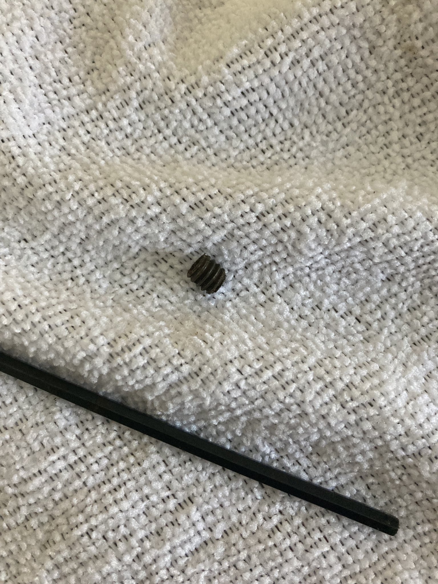

Cant post a video. Have to figure that out later. On todays episode of dude learning to sawmill..... a broken set screw was preventing the drive from engaging. I poured a pile of transmission fluid on the chains, wire brushed the drive bars and cleaned them all up. This shaft is going to need to be replaced. I will need to find it, a new sprocket and a new pulley. I did however manage to make 4 straight cuts in a row. So Im getting better. Tomorrow I’m going to attempt to square up the 2” slabs and make some square 2x4s and 2x6s!

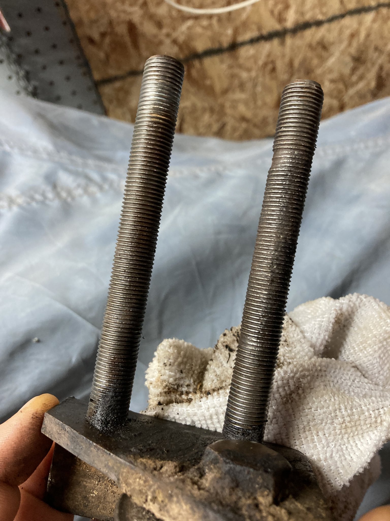

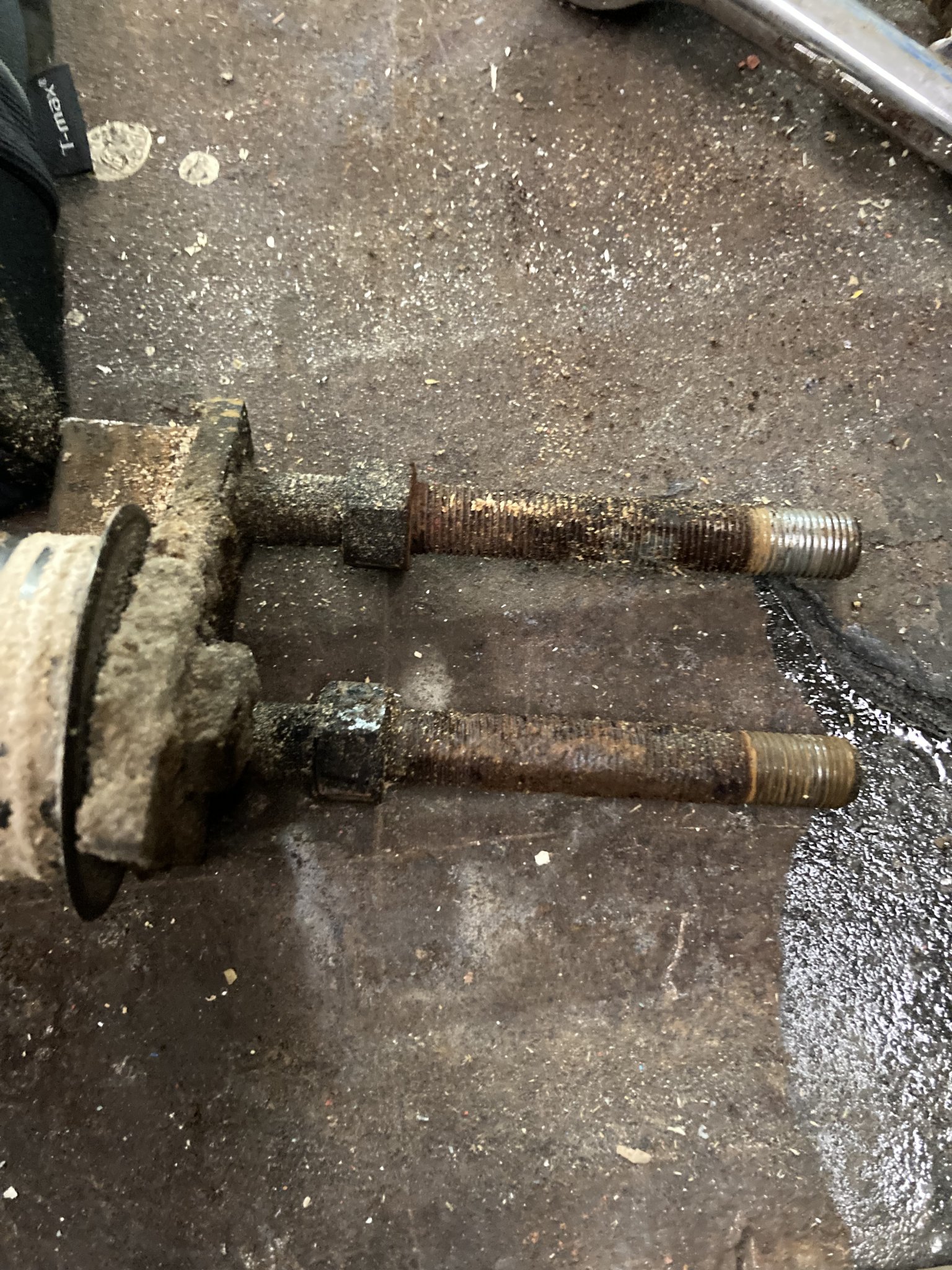

More repairs today. The fixed roller guide adjustment nuts were seized so I took it off, and cleaned it up. Works much better now. The floating one, it’s going to need to have the threaded rods cut off and replaced. they are rotten. I will hopefully have the part back in a couple days and I will fire it up and continue to chase problems. I told my friend who owns it that I will return it in better condition than it was when she picked it up. Long story How she got it not really worth knowing.

Nice project! Milling is fun, that’s a great looking little mill! You’ll have it it too too in no time!
What I’ve learnt is…Almost Any time the mill is acting up, it’s the blade! Just sharpened don’t matter. The set could be off. Could have been a crappy sharpen. Could have hit dirt at the first contact. Coulda dulled bouncing in the truck on the way….
Sometimes a frozen log just won’t cut nice.
Somtimes a big ole knotty spruce ( sometimes called a Bull Spruce for being a big ole tree growing out in the open on its own) just won’t cut straight. Frozen seems to make it worse!
Sometimes, Murphy figures you need square firewood!
You can build nice planter boxes or a chicken coop out of some pretty wavy lumber though! It all has a use :).
