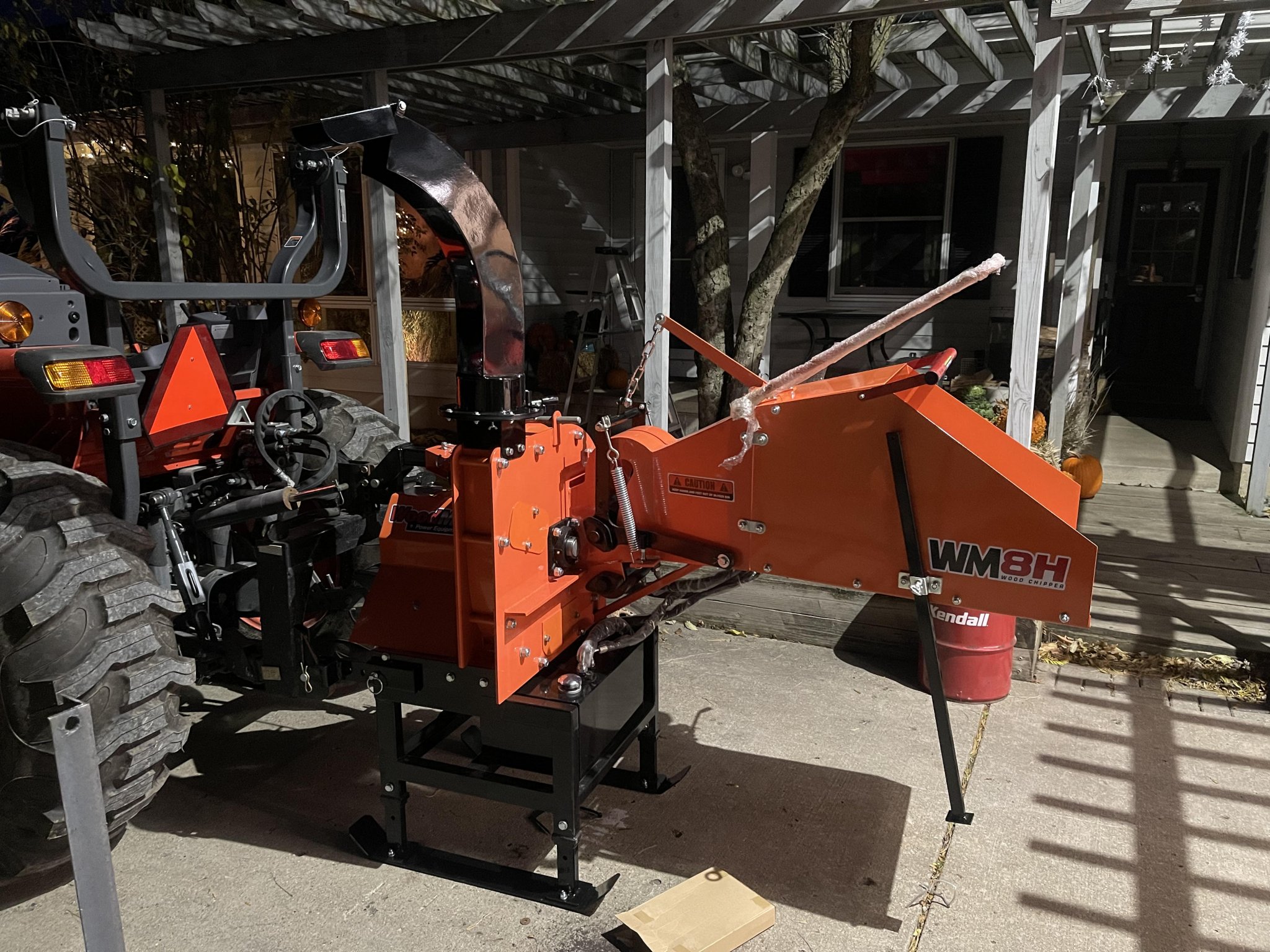

So it showed up today. Daughter and I were right in the middle of brakes on the wife's car, so I didn't get started until late.
Its mostly assembled. Just need to fit the PTO shaft, add fluid and then give it a good once over.

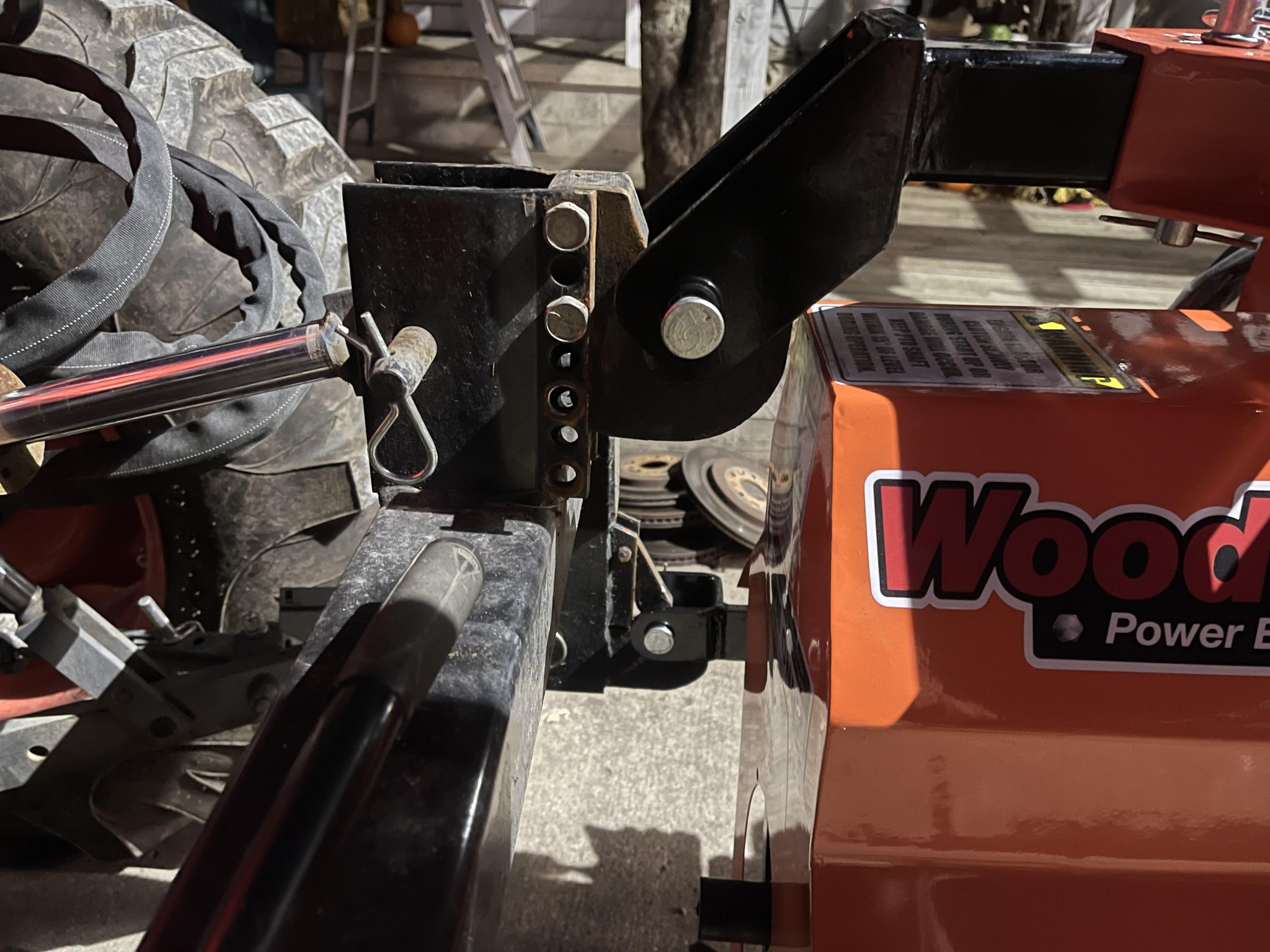

Its pretty stout, I have no doubts it will fulfill my needs. My only gripe, so far, is that it isn't technically quick hitch ready. I had to move the hook to the top holes in order to get it to seat in the quick hitch correctly.
Ive been able to connect to all my quick hitch ready attachments with the hook in the lower holes. While this isnt really a big deal, it does mean I will now have to move the top attachment point on all my implements to match.

Sooo.... With the top hook on my QH left in the upper holes, I backed up to my counter weight, moved the pin to the upper hole and it was a no go. Which means moving the top pin on the rest of my implements would also be a no go.
I replaced the bolts for the top hook with pins and will move the hook up when I'm going to use the chipper.

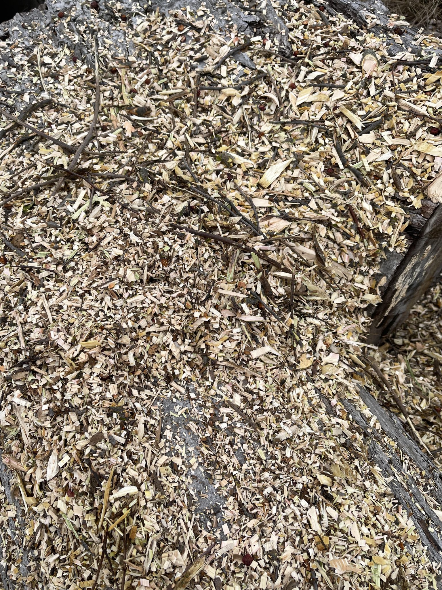

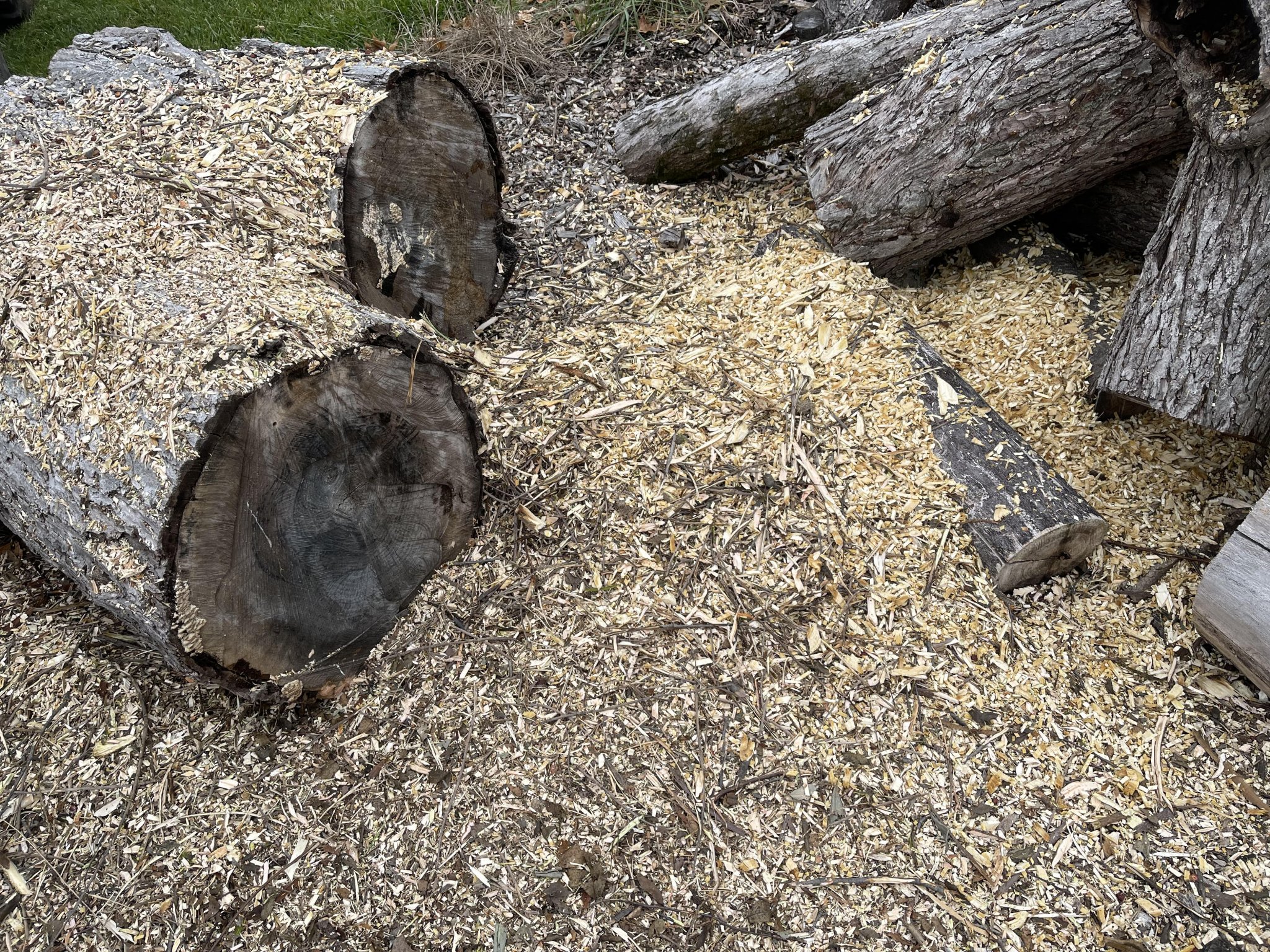

I did get the chipper fired up and it ate what I fed it, right up to a 4" piece of Mulberry without breaking a sweat. That was just to see what it would do.
