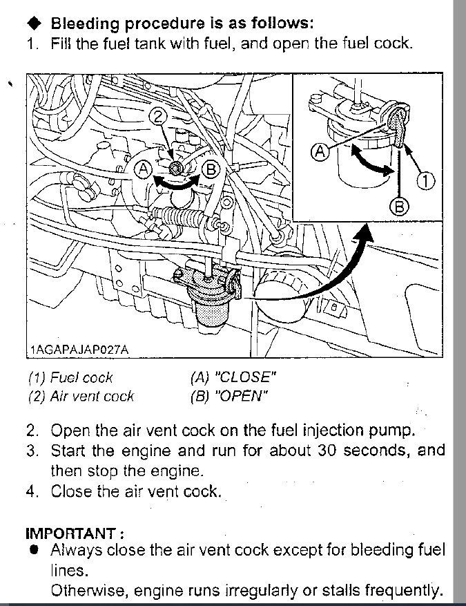

Did you open the shut off to fuel filter after replacing? Easy to forget to open it back up when doing several things.

If you didn't bleed the fuel system after replacing the fuel filter, you've just diagnosed it. Your symptoms exactly match what will happen when you don't. Follow the procedure posted by Dave and you'll be all set.

I appreciate all the help. As I said to start with I have been servicing it since 2007 and somehow never had any issues with the fuel filter. This timeh I did. I opened the bleeder valve and in a few seconds she started trying to hit and finally did. Closed the bleeder valve, ran it a bit. She’s like new again. Thank you for the help. May seem like everyone should know this but after all these years and never having it happen to me I just didn’t know. Now I do.
