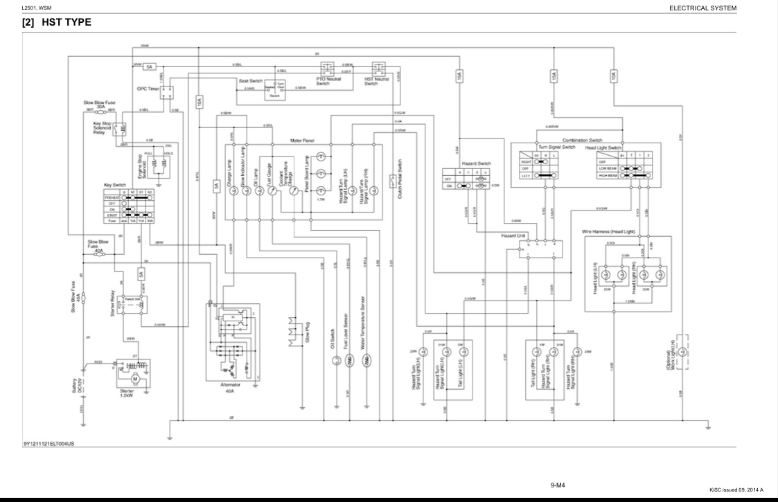

Hey folks,
I have some issues with the rear lighting on my unit. The turn signal on the left works. The right only has the fender light blink. Hazards don't all come on.
Anyway, I know it's warranty but if it's simple enough to fix I'd rather just do it. Especially since it's getting dark earlier and I am clearing dead trees along the road at the back of our property.
If someone has one, or can point me at a free one that would be great!
Many thanks!

Huh...not as simple as I thought, maybe. The Hazard unit will be my first bet. Unless they plugged lights into the wrong plug. Should be easy enough to rule out.

You can download the WSM HERE it will be easier to read and have everything on your L2501
