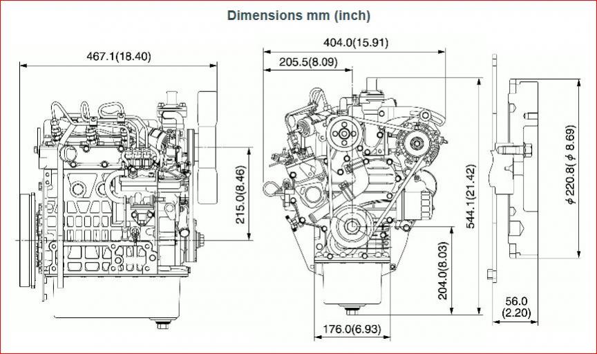

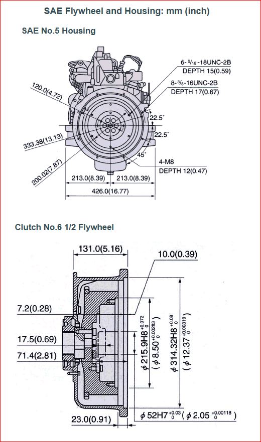

North Idaho Wolfman Moderator Staff member Lifetime Member Equipment L3450DT-GST, Woods FEL, B7100 HSD, FEL, 60" SB, 743 Bobcat with V2203, and more Jun 9, 2013 33,429 8,719 113 Sandpoint, ID Jul 12, 2014 #2 Easy answer, not very easily. They have different dimensions, and very possibly different bolt patterns. D902 specs: D905 specs:
