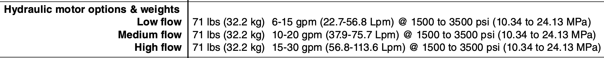

I ran a SA-20 on my MX5800 and it did a really good job but you have to get the low flow model they come in 3 motor models low, medium and high flow. I don't know how well it would have run on a B or L model tractor.
I was running off the 3rd function without any issues. It was nice to be able to reverse the bit when needed.

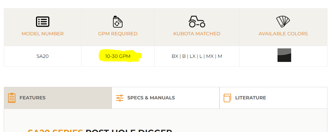

I was wondering the same thing recently. I have a MX5200 and the flow is rated at 9.5 GPM. It's strange that they would show the SA20 auger as 'Kubota Matched' when it really isn't based on hydraulic flow rate. I suppose the bigger M series tractors might do OK but it seems like anything smaller than that isn't really a good match.
Apparently, they've reduced the minimum flow to 6 gpm. On the Landpride site, the SA20 is listed twice. On one it shows 10-30 gpm. On the other it shows 6-30.
Ahh! I learned something new. I was always jealous of the skid steer crowd and the hydraulic augers, so this is great to know that there is a low flow version that would work on a MX. The 3-point PTO powered auger is adequate but a hydraulic unit hanging off of the bucket would be so much better.

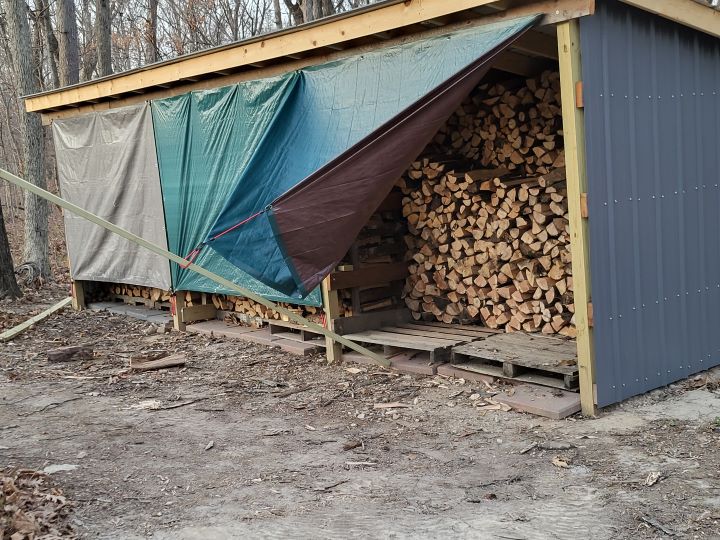

B2650, LP SA-20 medium flow motor, augered all holes up to gearbox. Used garden hoe to pull dirt piles away from auger before pulling it.
8 holes for woodshed
18 holes for implement shed (work in progress)
