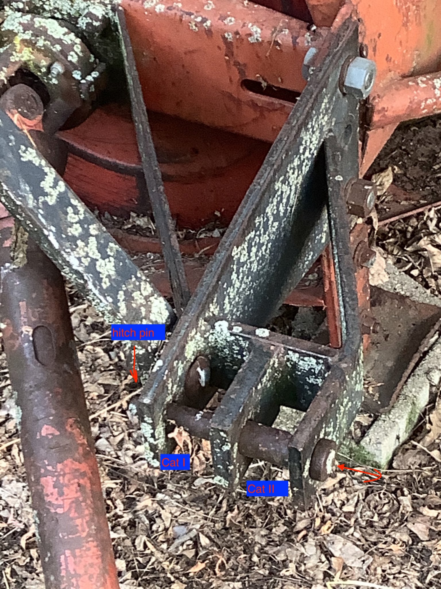

I had a look at baler and QH info. the baler should be 'Cat1'. The QH however appears to be Cat3 on the implement side. LP does offer several 'adapters'..
cut from the LP document...
20 320-048D SPCR TUBE 1.44ODX.9IDX1.28LG (S/N 388293+) Standard
20 320-044D SPCR TUBE 1.44ODX.93IDX1.50LG Optional Order as Required
20 320-045D SPCR TUBE 1.44ODX.93IDX1.93LG Optional Order as Required
20 320-050D SPCR TUBE 1.44ODX.93IDX2.18LG Optional Order as Required
20 320-051D SPCR TUBE 1.44ODX.93IDX2.43LG Optional Order as Required
20 325-017D SPCR TUBE 1.44ODX.93IDX2.88LG Optional Order as Required
20 320-052D SPCR TUBE 1.44ODX.93ID.3.50LG Optional Order as Required
One set of these 'spacer tubes' ,should allow the QH to carry the baler. ?
I'm thinking LP has made ONE 'btm hook' for quik and cheap mfg, hence needing 'spacer tubes'.
If you measure the baler's mtg width, you can decide which set of spacers will be needed.

found this...
while trying to figure out 'dimensions'....
I think that the 'quick hitch' are all wider than the ASME CAT1 width of 26" spec,hence the need for 'adapters' or 'spacers'. They all(most ?) are CAT3 where the implement actually connects
You'll need 7/8" bolts to replace the lower link pins, seems 7/8 for the bottom 2, 3/4" for the top link.
The easy solution for now would be to remove the QH15 (obsolete now...) and connect baler to 3pt hitch. and get the crop baled.
Afterwards, THEN you can figure out the best setup for your implements. There's a LOT of posts about needing to modify implements to fit certain QH units, a terribly confusing system to say the least.

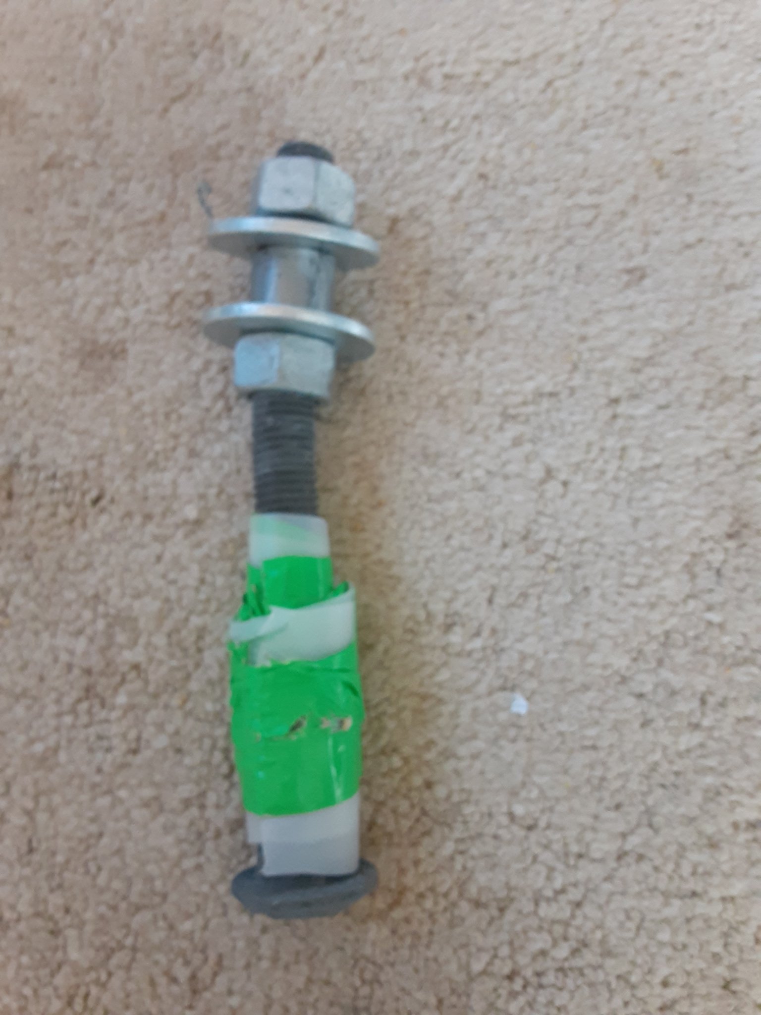

rc51, gvjay, and bobinsd - thanks for your responses.
So the baling is done, the baler is unhooked (quite a chore), and I'm trying to get a solution now, while things are still fresh in what's left of my mind.
I have two approaches I'm focused on:
1 - Make longer bottom "pins" for the implement. The photo below shows my cheap steel mockup, which bent almost immediately (the green duct tape was my mock bushing). I've ordered grade 8, 8" x 3/4" bolts to see if I can make longer pins that are strong enough. If so, this effectively widens the width of the baler, so it'll fit on the QH15.
2 - Return my QH15 and get a set of the "Pat's QH". If I go this route, then I also want to effectively lengthen the toplink holders that are bolted to the tractor (by 3" or 4"). So I'm wondering if "longer" (from front to back) toplink holders are available? It appears that the "Pat's QH" would let me adjust the distance between the two bottom links easily for each implement, as opposed to having to make all the implements exactly fit the QH15.
