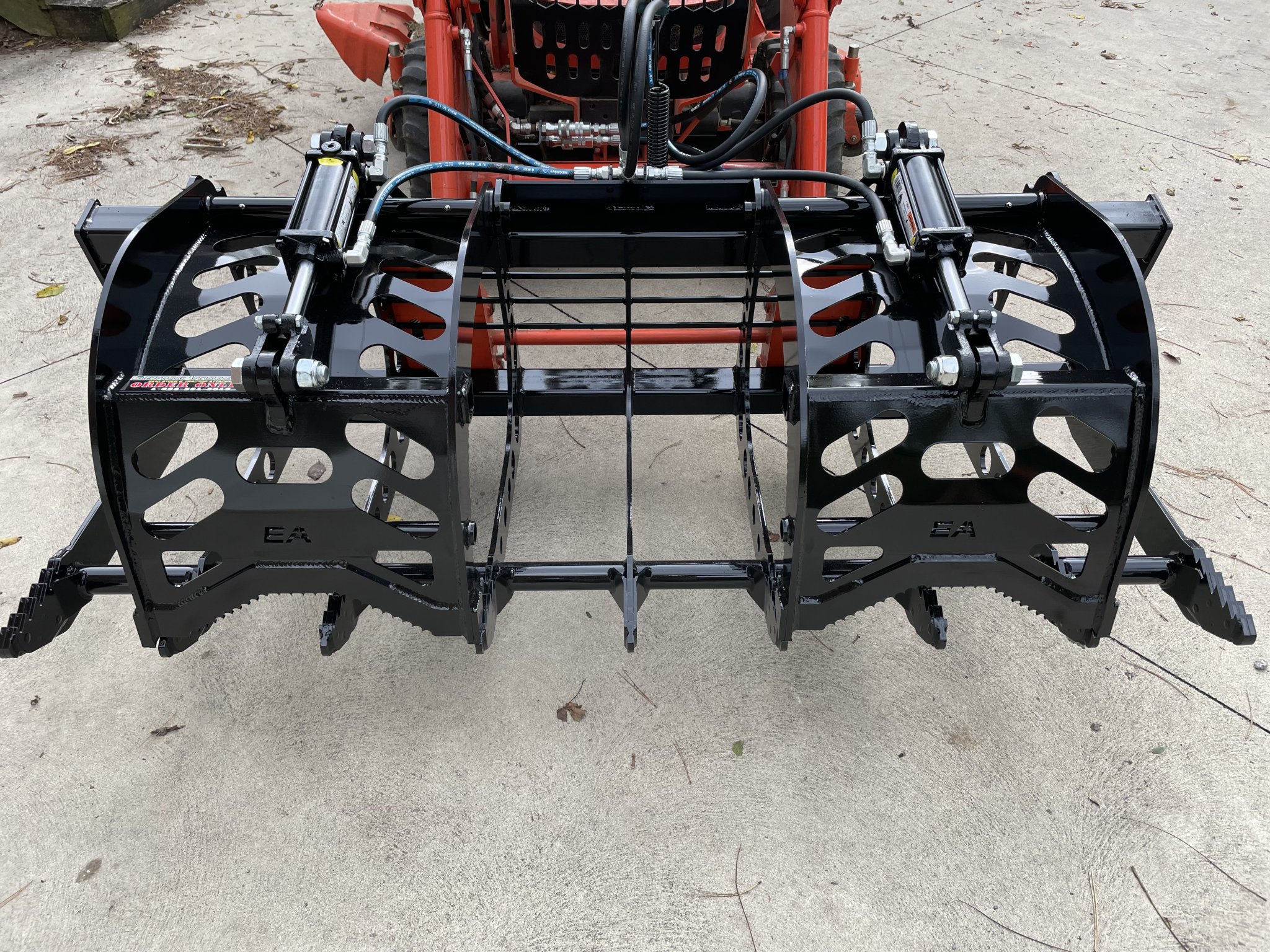

I chimed in above, but since the question was raised again, I'm very happy with the quality of my Homestead purchases...grapple, land plane, and landscape rake.
Also happy with my EA forks...
...and my Woodland Mills Chipper.
...and my land pride rotary cutter
