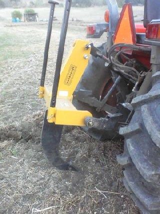

3 Weeks ago I bought a heavy duty sub soiler I farm in Ca and the soil is heavy adobe and in spots we do have a few rocks . Im very pleased with it the model and make are ( Gearmore 200 ) it also came with parking stands witch is very nice makes hitching up very easy. It also has shear bolt protection cost me just over $600. Im pulling it with a L3830 and its working great first pass ill rip 16" deep then cross that at 90 degrees 23" deep

Theres a good picture of my sub soiler in the gallery .... Dan
