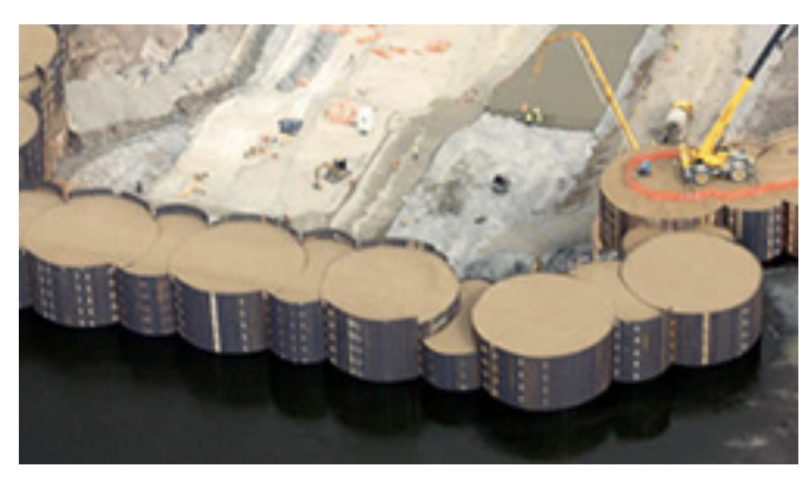

so Dali only had 1/2 the seacans on it could carry but, humour me, WHERE would the other 5,000 seacans be put ???
some math guy can figure out the force of 95,000t vessel + cargo doing 8 knots to see how much concrete would be needed to make the safety bullard.
Stiffness attracts load. You couldn’t reasonably put a “strong/stiff” reinforced concrete structure in place to accept the load. A proper fender system would be flexible and probably sustain a significant amount of damage itself and be designed to deflect the load vs take it all on the chin. Something like very large interlocked sheet pile cells filled with dredged material.
But then one would have a whole new scour concern of epic proportions.
A little like this.
Funny thing about folks saying it wasn’t designed correctly. They obviously have no idea what the AASHTO standards for highway bridge design call for relative to vessel impact. It. sure as hell isn’t this situation.
