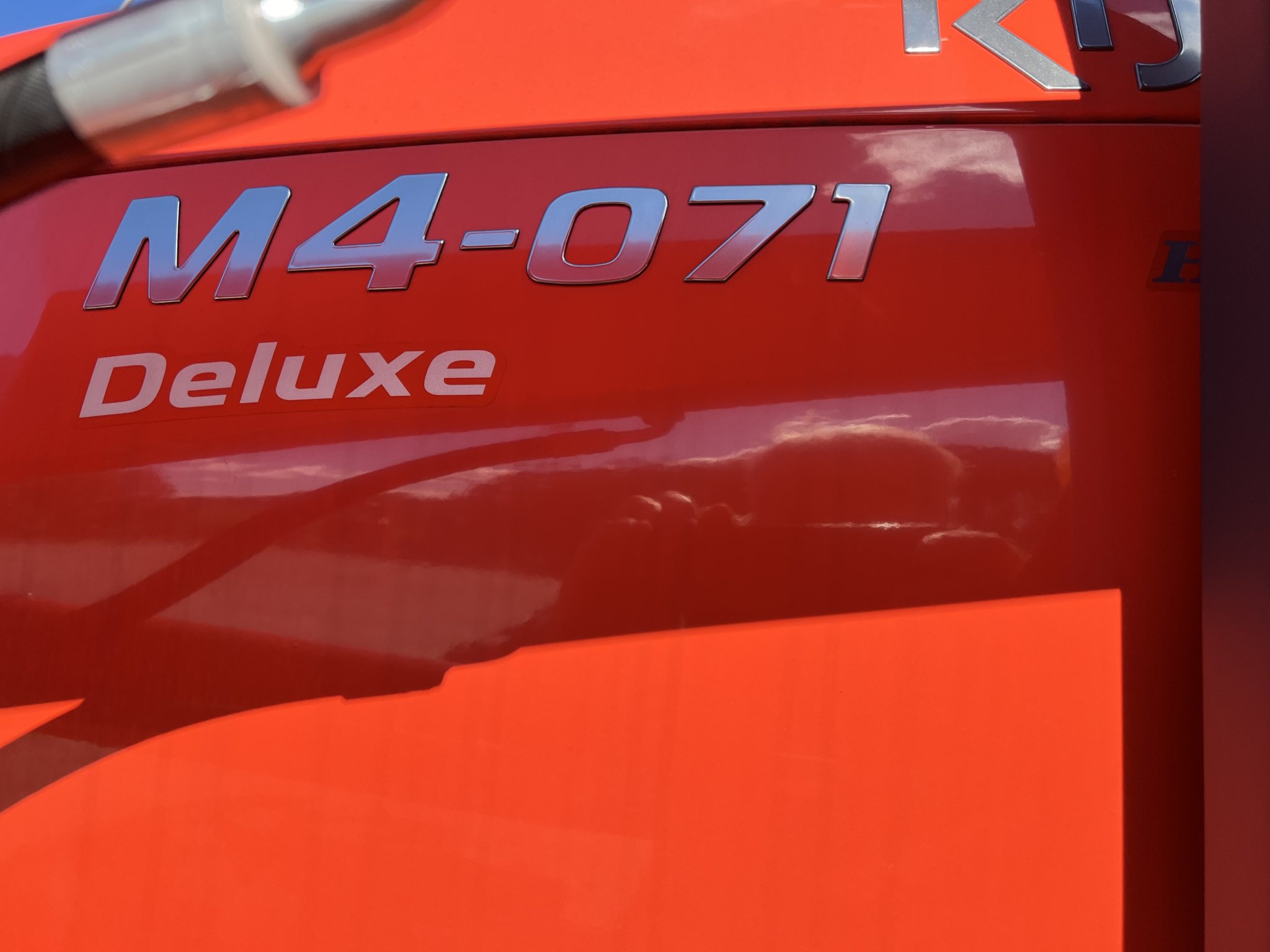

Very helpful, thank you. So the M5 has DEF — which means I need to add the fluid vs the auto regen? How often do I need to add the fluid? Is it a PITA? Below is a photo of the M4. Those front tires look scrawny. Is there a wider tire that doesn’t compromise ride quality. I’m in pastures 90% of the time, but I do traverse my lawn frequently.
6,587
8,753
The M5 has DPF and DEF. I'm no M5 expert and have no idea how often you'd need to add DEF, but regens are still a thing.
I changed the front wheels and tires on my M6060 for the same reason. I didn't like the skinny front tires. If you go to Build My Kubota on Kubota's website you can see all of the wheel and tire options.
But honestly, an M4 is a big upgrade over an L6060, being way more capable, so there's no bad choice here.
