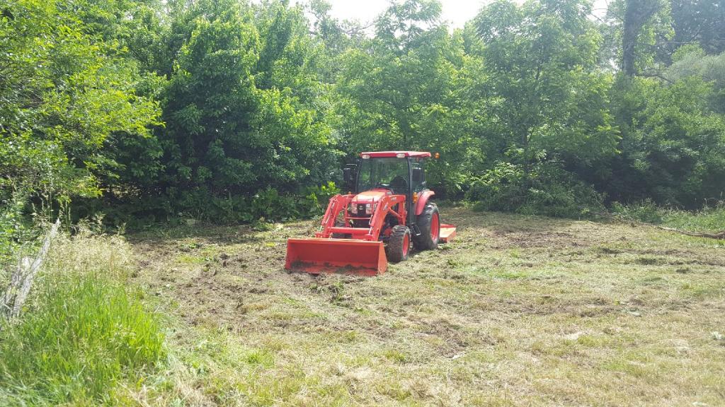

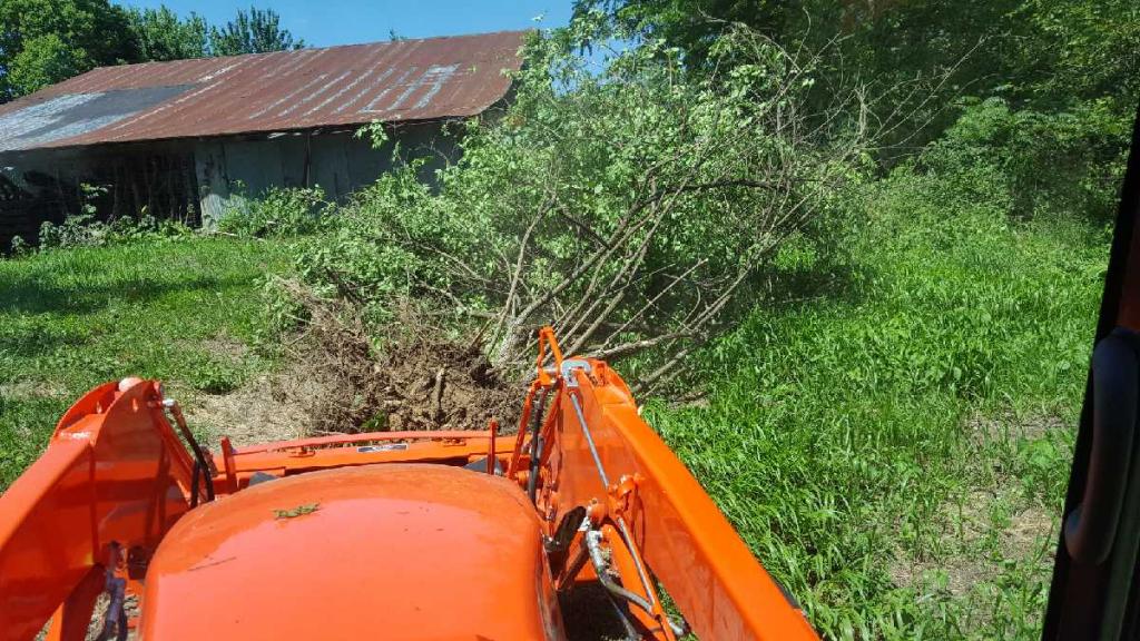

My family has an 80 acre farm and we are working on getting the no tillable areas (about 20 acres) back under control after years of neglect.
What size tractor is right for you? It depends on how quickly you would like to get things done. I have L3560 (35HP) and my dad has a MF383 (80 HP). There are advantages to both. My smaller tractor has been able to get in places his bigger one couldn't. His bigger one has been able to lift objects that my little one couldn't.
We have been doing a lot of brush and tree clearing. Where my dad might pull the whole tree out with his tractor, I will cut the tree in half and drag out half of it. Although, when dad got his tractor stuck, it was my tractor that pulled him out.
The tractors you have selected will do what you are wanting to do, bigger tractor will generally do it faster.
This last weekend was the first time I was wishing I had a bigger tractor. There was a 4-bottom plow buried in the dirt that I was trying to pullout, but my tractor just didn't have the ability to break it free so we could move it. Dad was able to work it free with his bigger tractor. So, since I purchased my tractor in late May, I have come across one task that I wasn't able to complete.
So, what I'm trying to say, I think your tractor choice is fine (only you know what you can afford, if money is no problem, then get the biggest then out there and buy a couple models in between to go with it). I will tell you that I have become a HUGE fan of the cab and my plan is that any future tractor purchase will include a cab.
