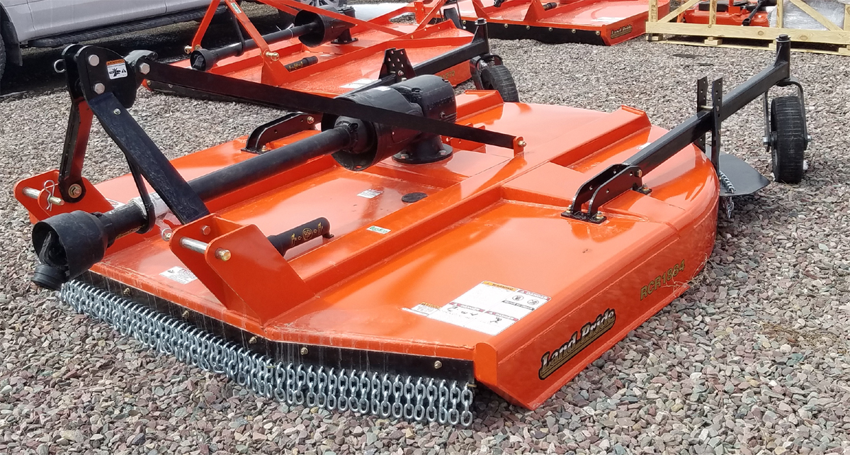

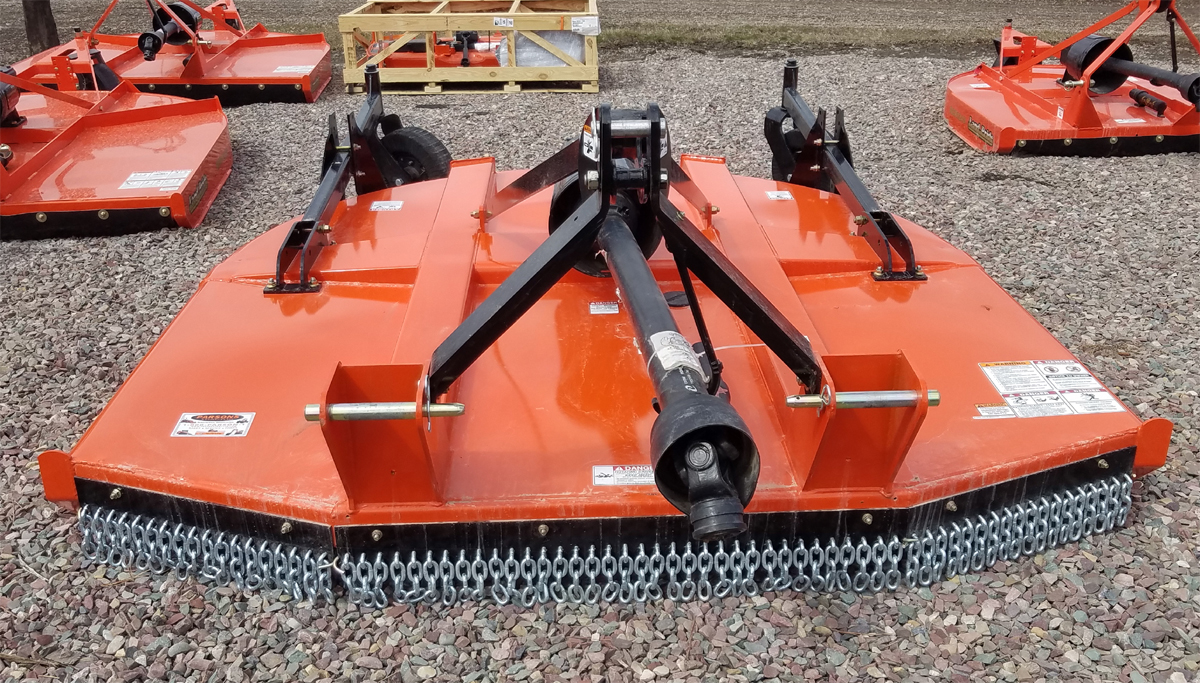

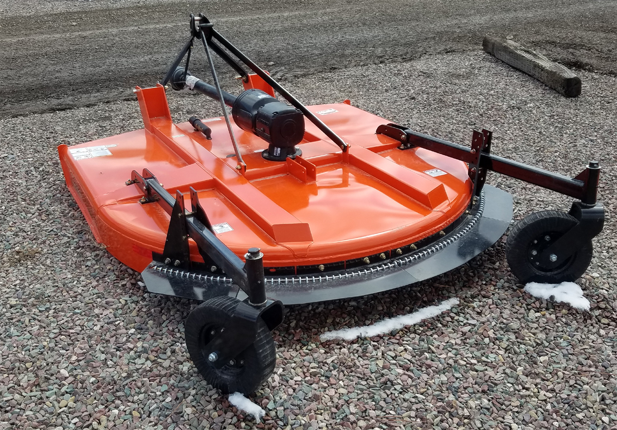

I got chain guards front and back and would do it again if I ever buy another rotary cutter such as a bat wing or flex wing. Here are some photos of the RCR1884 the day I bought it.
I use chains in the rear but no longer on the front as front belting is more effective keeping debris off of the back of my tractors.
Rear chains help to distribute the clippings better but one must be careful when backing and turning around trees, which I do routinely, to avoid damaging the chain hangers.
