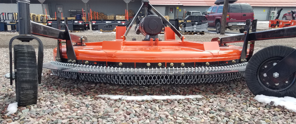

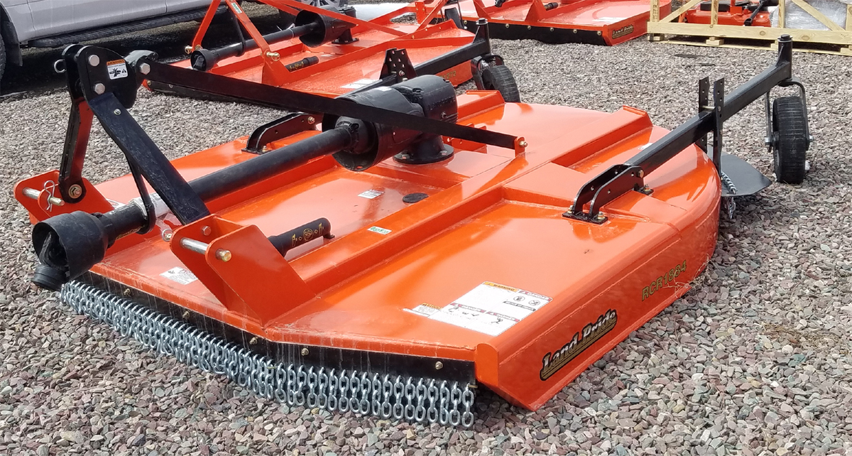

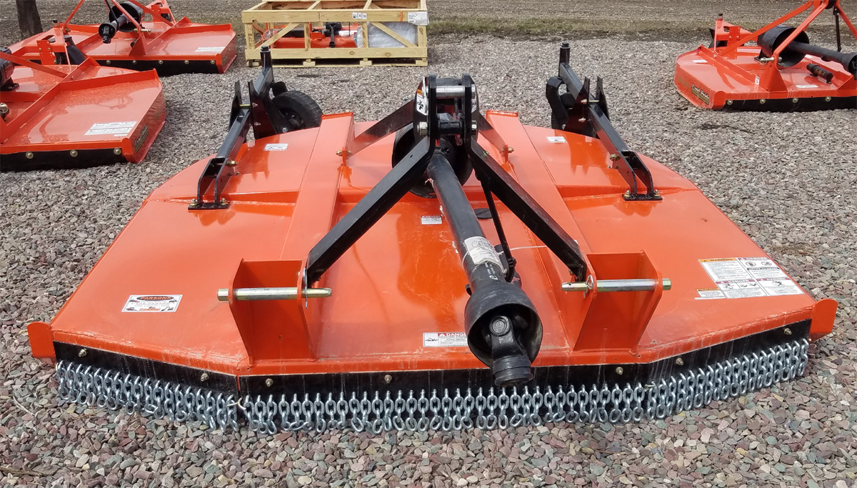

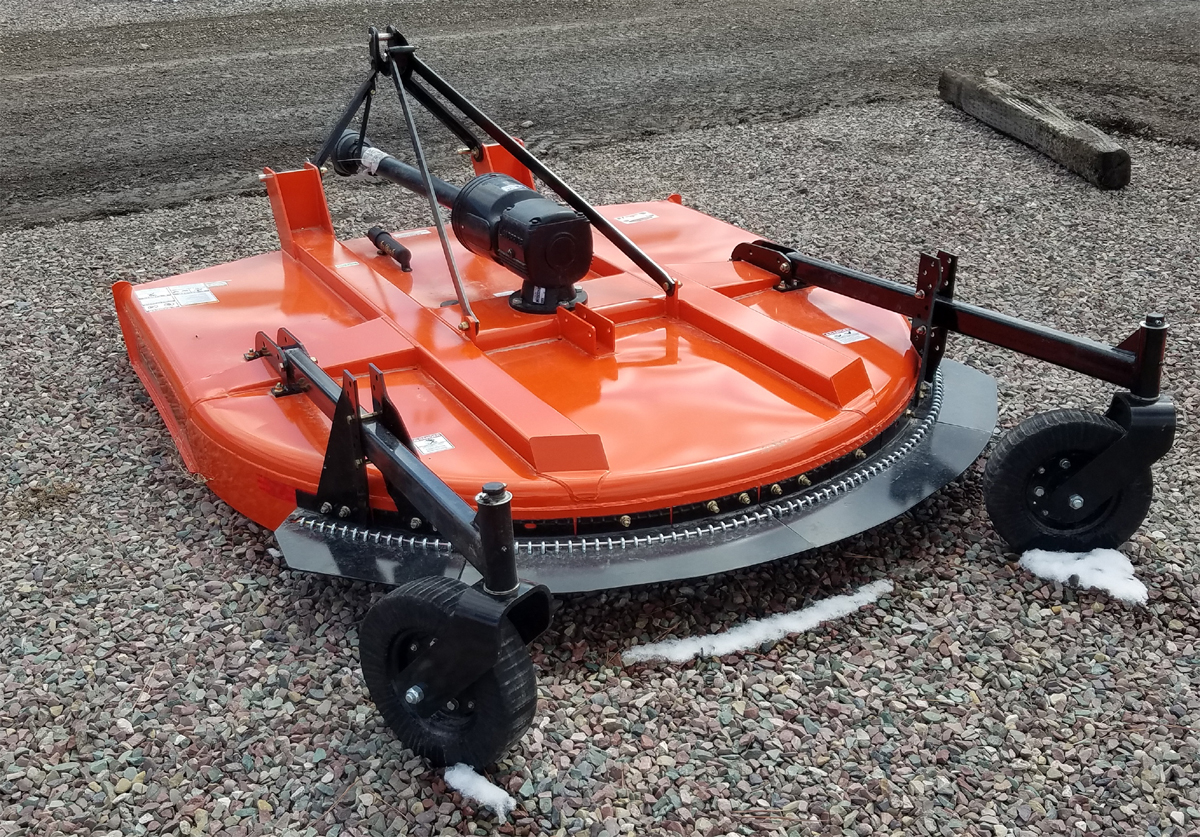

I got chain guards front and back and would do it again if I ever buy another rotary cutter such as a bat wing or flex wing. Here are some photos of the RCR1884 the day I bought it.
I use chains in the rear but no longer on the front as front belting is more effective keeping debris off of the back of my tractors.
Rear chains help to distribute the clippings better but one must be careful when backing and turning around trees, which I do routinely, to avoid damaging the chain hangers.

I use chains in the rear but no longer iin the front as front belting iif more effective keeping debris off of the back of my tractors.
Nice shredder - I looked at these pretty hard but my inner me said “ you will tear those tail wheels off in a New York minute” 😜

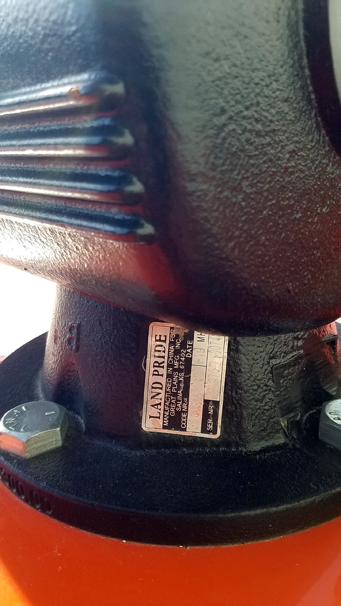

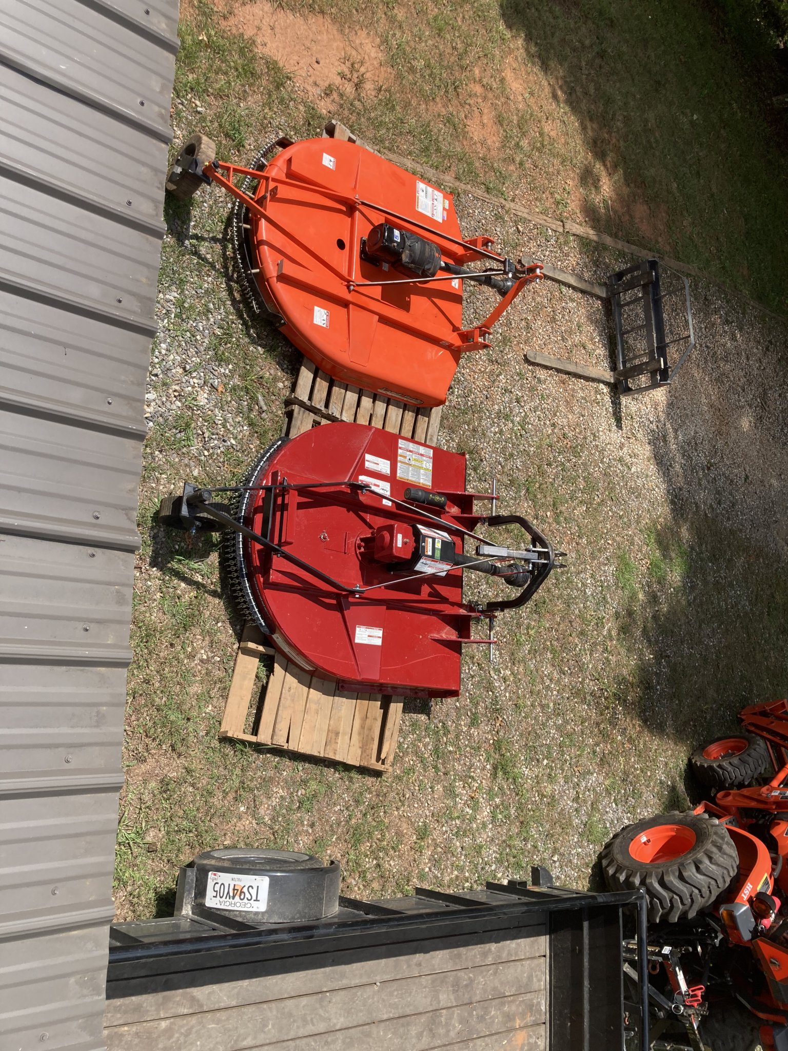

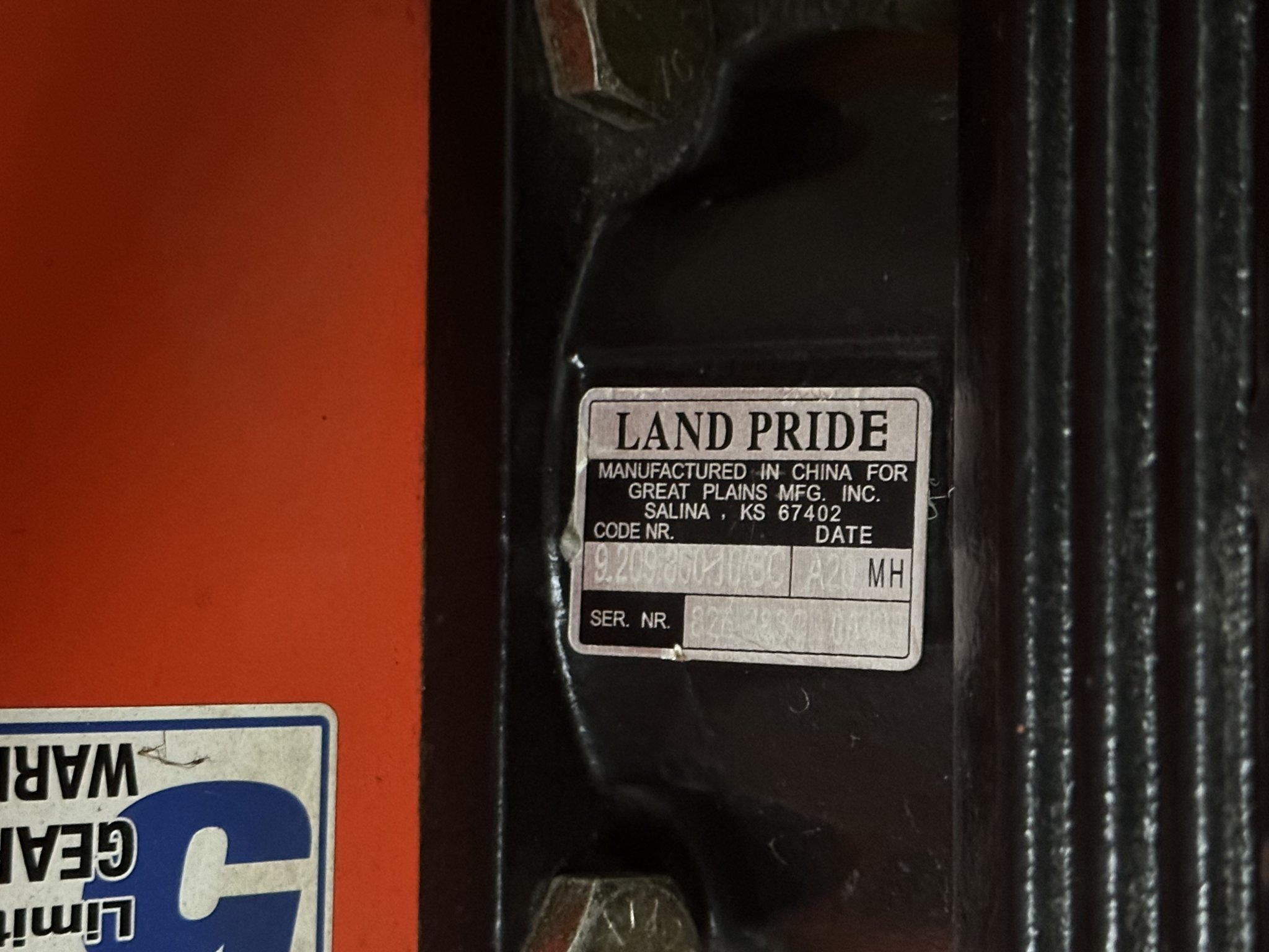

I do own a LP 2021 flat top and there are two items made in China on it! The Gear box and the black cast Yoke for the float.
it’s been a great little shredder but this went with my 37 hp jd. LP is just a little light in the pants for me.
