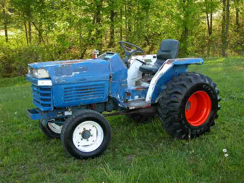

Hello everyone! I'm new here. I find this forum about week ago, it is very interesting. I purchased my first tractor couple weeks ago from auction and need help to find more about it.
It is blue/white Kubota tractor with cabin you can still see at some airports.
It has a metal plate on its frame: L2550-12396 (model-serial number). Made in Japan by Kubota LTD. and has 3 cylinder diesel engine: 90331 / K2-D / 01452-DI? or 01462-DI? / 1395 cc.
I checked US Kubota website and this engine is not listed under L series. Is this gray market unit? What is production year of this tractor?
Also installed Kubota oil filter (70000-74035) does not match recommended oil filter for L2550.
I want to change fuel/oil/air filter, rear tires, etc., how and where to order?
For which US equivalent model do I need to order parts/filters?
I may upload pictures later, if this can help this tractor identification.
Thanks for any help! Al
