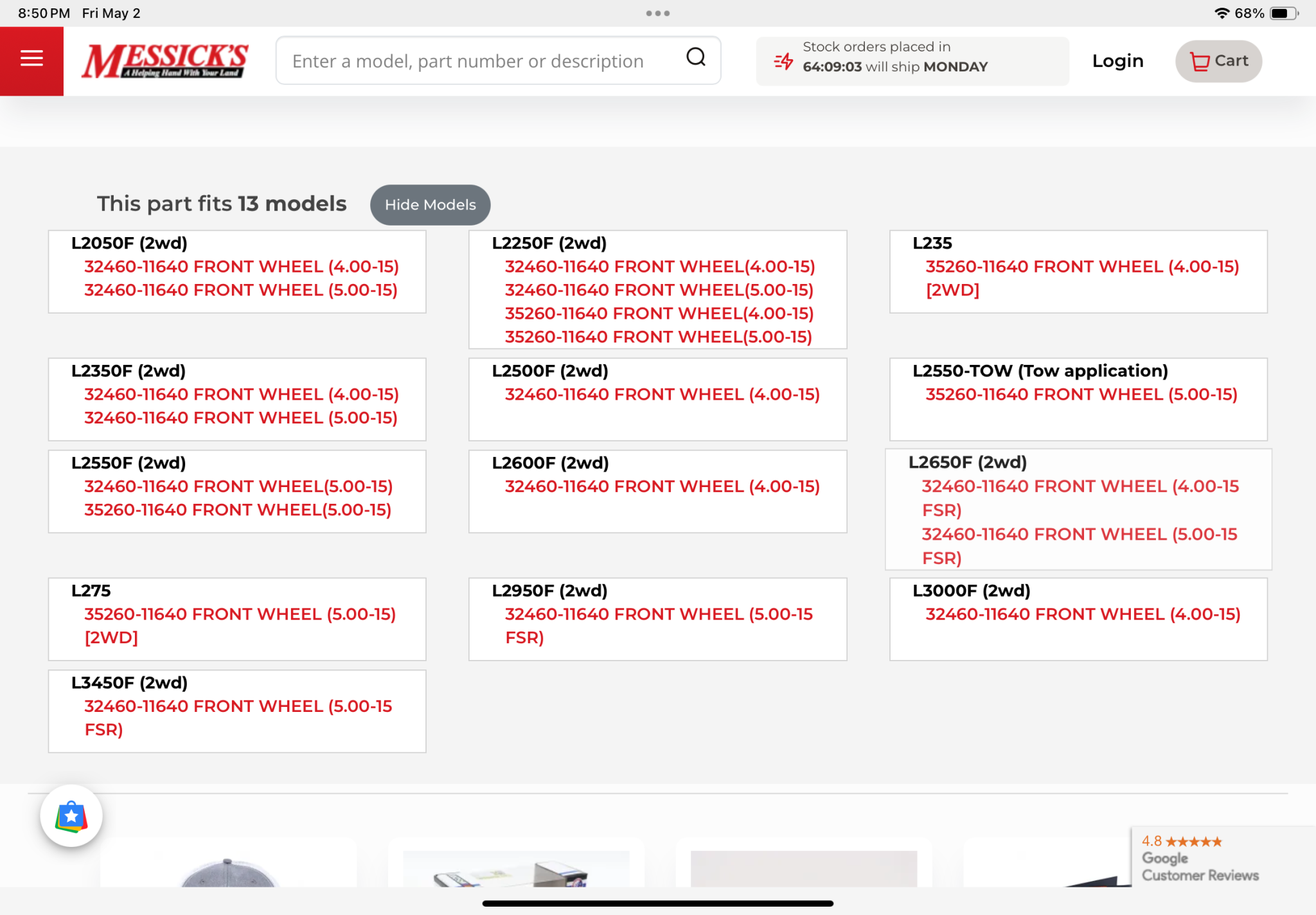

You will need to be specific about which wheels and tires you need or want. There are Agricultural (R1) and turf (R3?) and also 2wd and 4wd versions on the L235.
You can get part numbers from Kubota USA dot com or messicks
This is the front wheel for 2wd Ag and it fit several models
35260-11640
