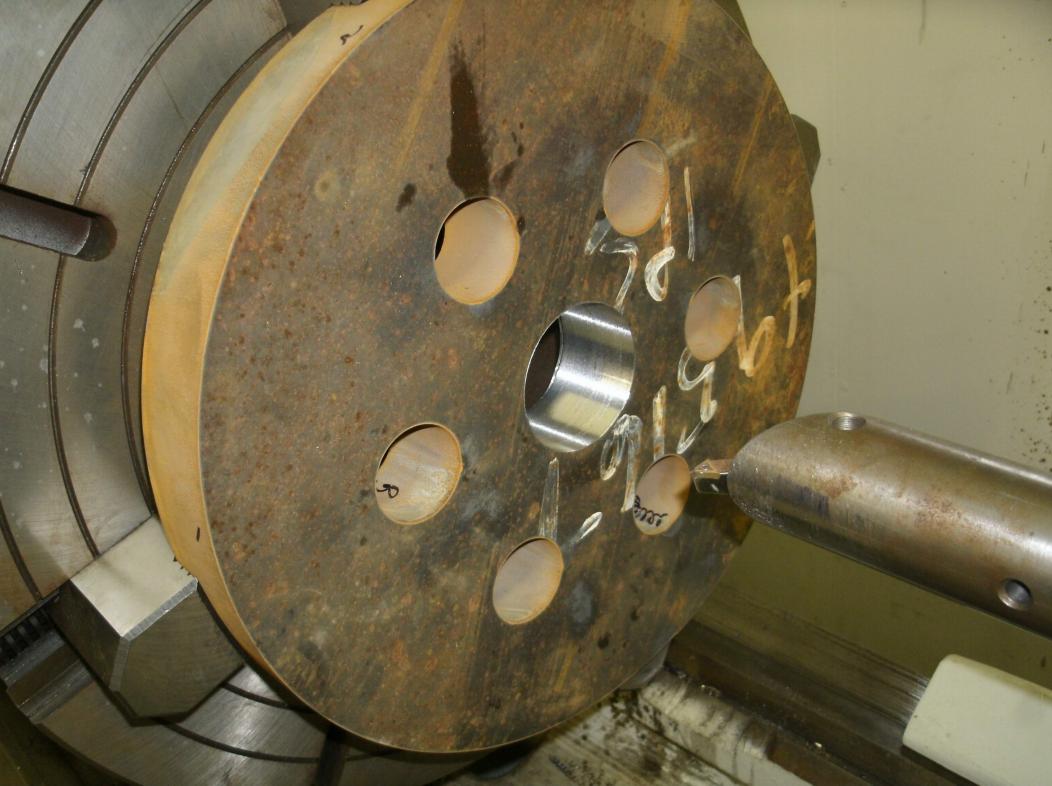

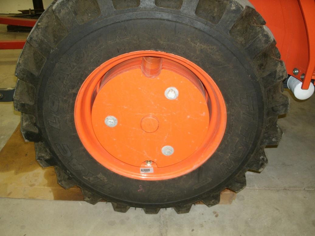

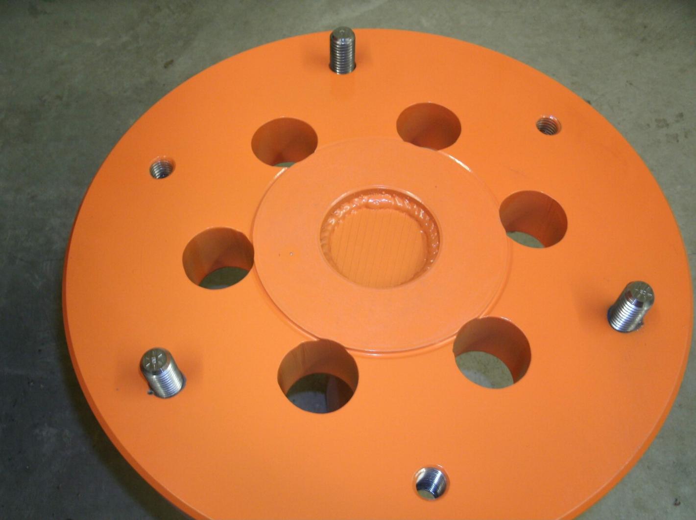

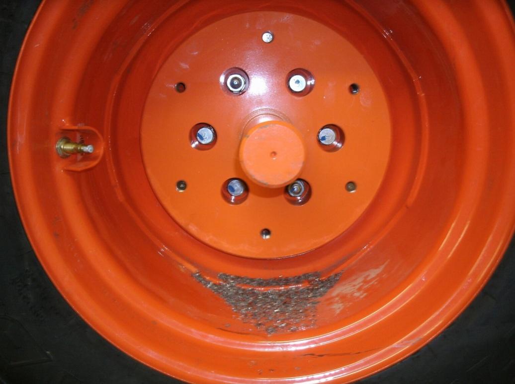

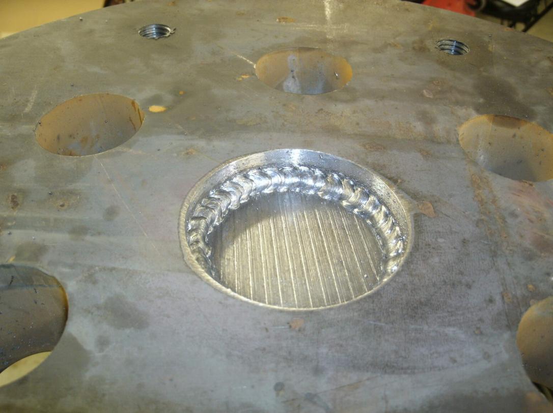

First step was the mounting 'spud' that the weights would attach to. I had these water jetted out of some 1-3/4" plate I had laying around. I had the six holes put in to clear the bolts that hold on the tractor wheel. Then I machined the center hole for a press fit of 2-1/2" shaft that would support the weights. I drilled and tapped three holes for 3/4-10 bolts that would hold the weights, plus another three for studs that would keep the spud tight to the wheel.
