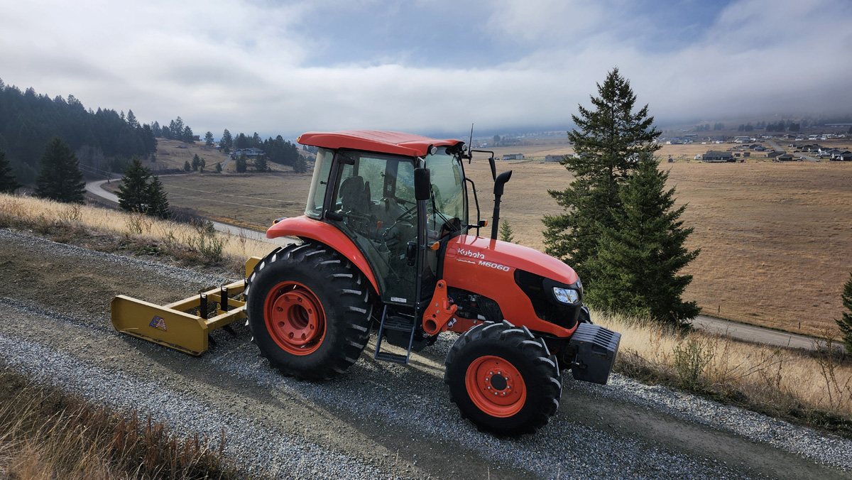

This isn’t the same type of rock you have, but a land plane makes quick work of our parking lots. And if I’m not there to run it, it’s pretty much dummy proof. Drop it and go.

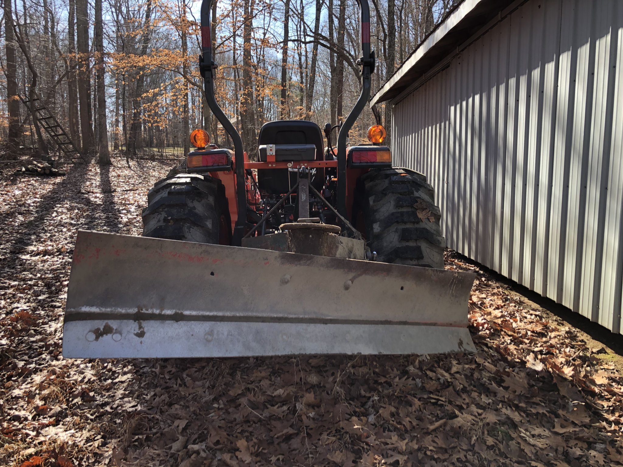

Not sure I’d have the back blade if it hadn’t been in the shed longer than I’ve been alive. It has its uses, but the boxblade does 95% of what I need. The backblade just bounces over old hard packed gravel.

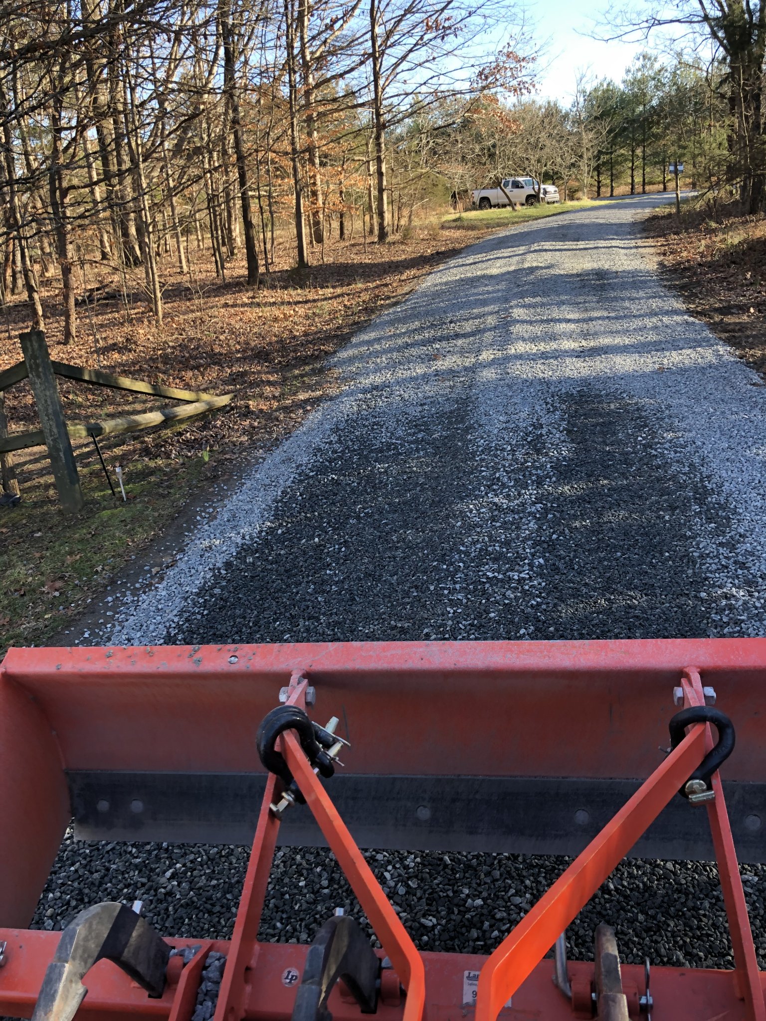

A land plane with scarifiers works great for long runs. It should have adjustable skids on sides that allows for a little crowning effect. A box blade with scarifiers is good for digging up deep pot holes and can be used for the longer runs if you don't have a land plane, but will not be as easy to get an even smooth finish. We have both to use on our 1/2 mile drive and start with the box blade for pot hole areas then switch to land plane to smooth everything out nicely.
Last year we started using reclaimed asphalt millings on some of the re-occurring bad areas and they have packed down to be almost like paving - have not needed repaired so far, almost no dust, and should hold up for years from what I see now. Will probably purchase more next year to upgrade more of the drive. Around here the millings are less expensive than washed gravel.
