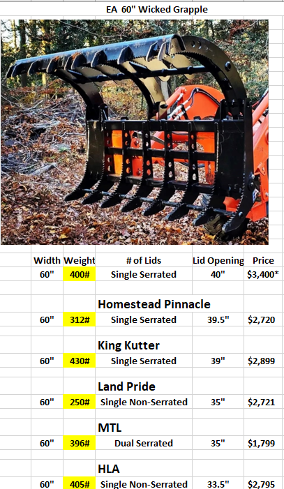

Been researching grapples. Man, there's a lot of different brands out there. Seems that most folks really liked the EA stuff...But, as we know, they are no longer.
I have an l2502, and looking to get a grapple. What's the go-to now that EA is out of the picture?
I'm looking for strong and light, serrated teeth, greasable, root grapple.
Anything hit all these bogies? (Can't you add zerks if none installed?)
6,587
8,754
That's the grapple I have. It works well for my uses which is rocks and logs, but my experience is limited to a 48" Land Pride and the EA so there could well be a better option out there. It would be nice if the Wicked 60 had a stand, but it'd be easy to add something. I do think I would prefer a Wicked 66 but that horse has bolted, and apparently died.
