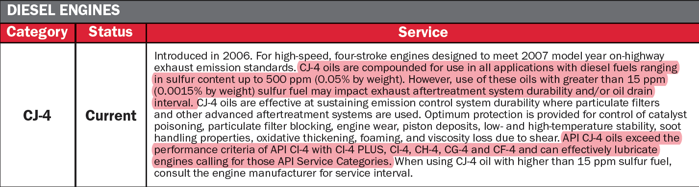

I have no idea why they would make such a recommendation and it is certainly not relevant today.. This is the original 2009 API statement of CJ-4 suitability for use.
CJ-4 oils are compounded for use in all applications with diesel fuels ranging in sulfur content up to 500 PPM (.005% by weight).
The ONLY issue with CJ-4 was with engines that had after treatment systems AND the fuel had more then 15 ppm sulfur content. Todays fuel is all ULSD (<15 PPM sulfur) and CJ-4 poses no problem for any engine including those with particulate and catalyst after treatment systems.
CK-4 was introduced in December 2016 and replaced CJ-4. You are not likely to find any CJ-4 oils on the shelf today.
API 2009
