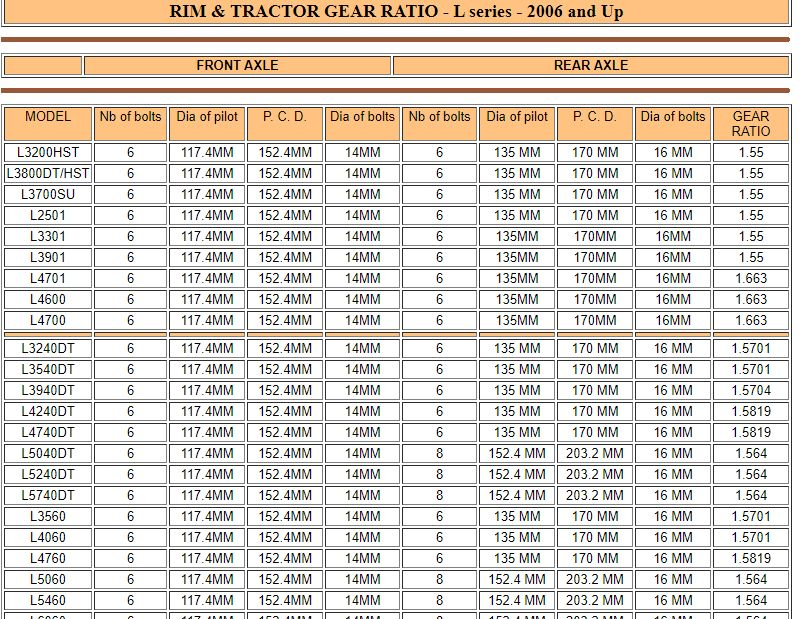

I was wondering if the L 2501 shared the mechanical components of the slightly larger tractors in the series. I know the engine is detuned, and read somewhere the same as used in some other Kabota tractors, but I don’t know which ones.
There’s a possibility in the future I may end up buying an L2501 as a third tractor (a want, not a need). I was going to buy wheel spacers for my B 2910. One concern is stress on the rear axle assembly when the wheels are widened. I’m not sure if this is a valid concern or not, but in theory it seems reasonable.
Now I’m thinking I will hold off on wheel spacers until I decide on the L 2501. The root reason for my question was thinking that if the L 2501 had the same mechanical driveline as the larger tractors, then it would be more robust than the B 2910, and probably wheel spacers on the 2501 would be less detrimental.
And perhaps the driveline could end doing less mechanical work, which might be an advantage...

5,980
3,195
I think this chart, posted by eserv in another thread, is what gave me the idea that the L2501 might have the same drive train as a couple bigger brothers.
Note the L3301 and L3901 use the same wheels as the L2501 ( at least as far as P.C.D, number/size of bolts, and diameter of pilot) and have the same gear ratio front/rear.
