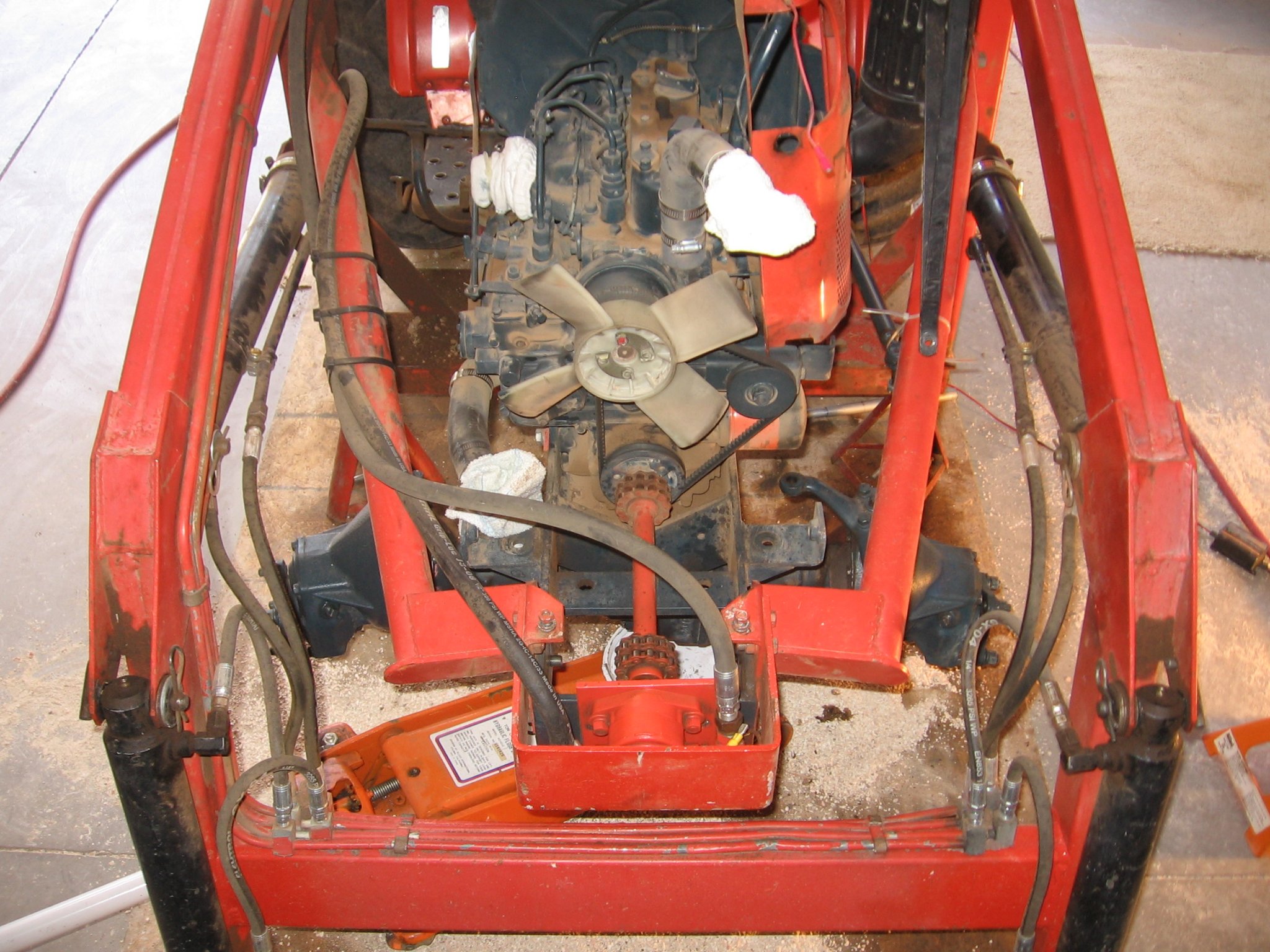

If it helps, the original B219 crank driven pump was a Cessna 24205-20 or 24205-2C. (not sure about that last digit/letter)
I know it is not available anymore, but maybe you could find the specs for it.
7,833
3,061
As for the pressure, I have verified mine at 800psi.
