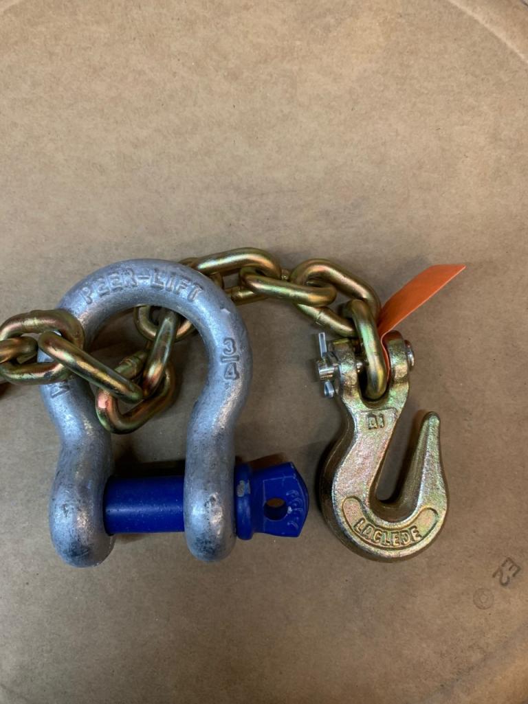

I reached out to Tusla chain to get their recommendations for my setup.
Drawbar dimensions: 1.26" thick and 0.82" holes taken with a micrometer.
Here is what they suggested:
It looks like a regular 3/4" screw pin shackle would be close to fitting the drawbar. I measured our 8058703 Blue Pin Shackle the pin was close @ .88 and so was the width @ 1.22”. there was no problem fitting the 5/16” binder chain through the shackle (picture attached).

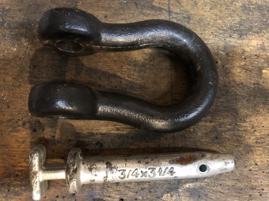

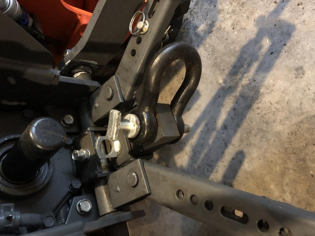

What would work for sure is our CM Long Reach Shackle M7151P It has a pin size of .75 and a width of 2.25”.
The question is, with the drawbar shackle, are you better off hammering for a tight fit or going with a little room to wiggle/move?

You want the wiggle room so it doesn't seize in there with rust or grime.
10,297
7,294
I agree with shootem - this is my "collection" of big old timers....they're bent, twisted, (pins too), etc, but they'll hold up to anything my tractors can dish out. Fit on drawbars pretty loose - which is fine with me.

This looks nice for a shackle...
Crosby S-2169
https://www.riggingwarehouse.com/default.aspx?page=item detail&itemcode=307-1021664&catlist=5759
https://www.thecrosbygroup.com/cata...s/?view=catalog&language=en-US&direction=next
1.25" opening and 0.88" +/- .02" pin. Would be tight though, not loose. I may remeasure, seems like it's hard to find a shackle wide enough and thin enough to fit the bill. Makes me think I'm approaching this wrong since it should be pretty straightforward. I've seen threads on here where guys have had trouble with tight fits on the drawbar shackles.
