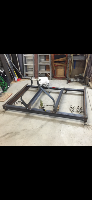

I have a 1400’ gravel driveway to maintain, using my BX25D, so I copied a buddies and welded one up 60” wide. 23 HP pulls it just fine, and it does a phenomenal job on a gravel road, compared to a box blade

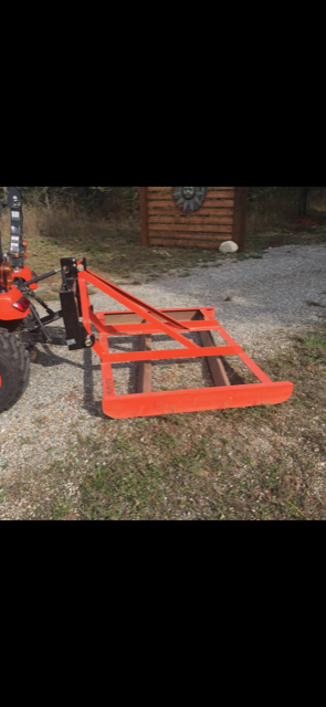

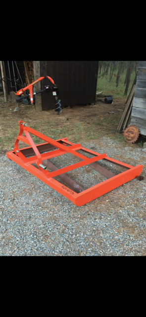

That looks pretty sharp!
I cheated and painted it Kubota Orange, even added a couple Kubota stickers. Mostly scrap iron, but bought AR steel for the two “ cutting edges” that collect and roll the gravel. I had a good “ teacher” on setting up implements on a quick hitch, and building them in general.
He helps lots of folks on this sight still.
