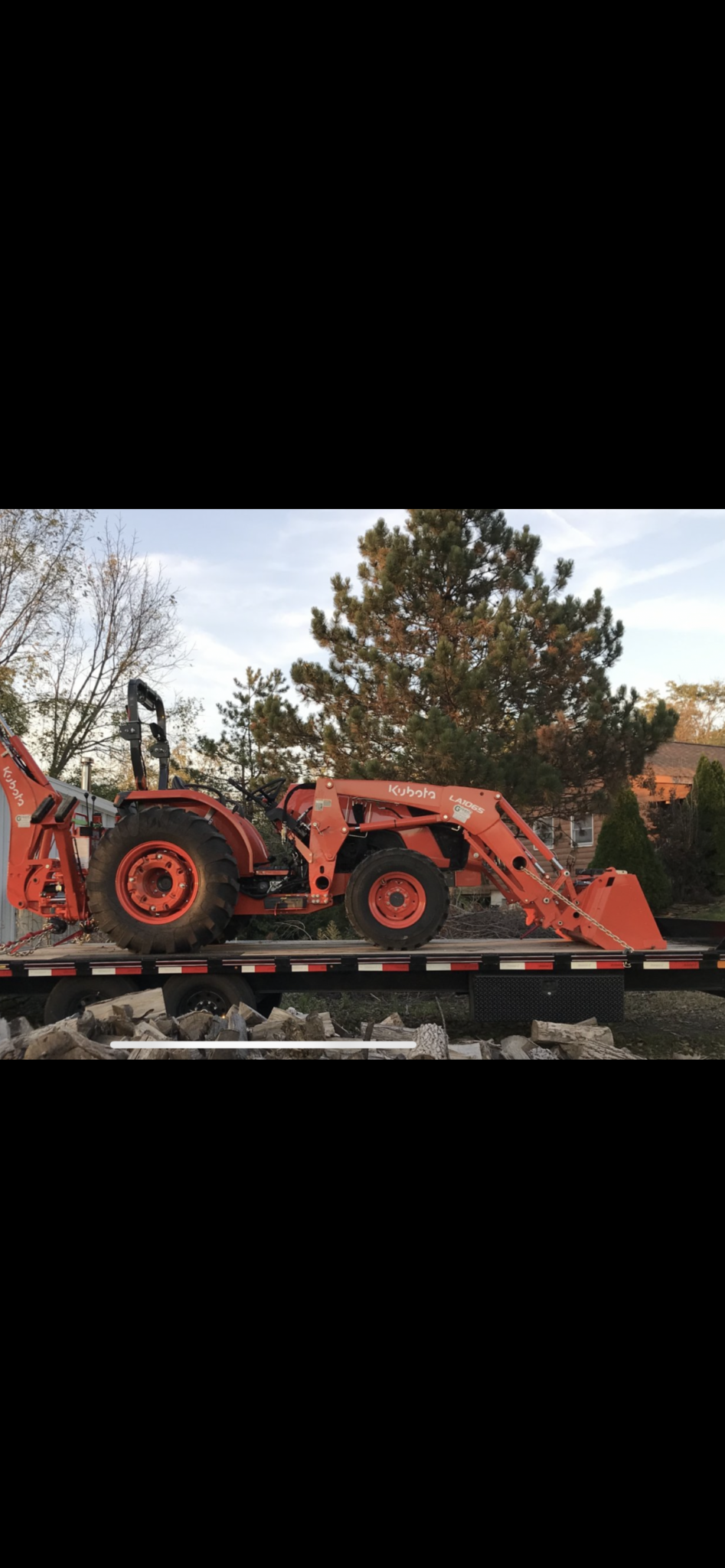

Good day. Congratulations on a long wait being over! I ordered my machine (MX6000) and BH back in early 2021 before world went completely bat shit crazy. I had a wait of about 6 months on the BH92. I believe I have an 18” bucket. I have not used it too much but when I have it has exceeded my expectations. At my residence we have a sandy clay filled with rocks. At our place up North it has sort of a split on the soil…some is a clay like chocolate peanut butter ice cream (dense when wet and greasy…like a brick when dry) and then there also some pockets of silty/sandy loam…greasy when wet. Anyway with a smallish bucket like mine the BH has not struggled yet…it’s way more capable than me 😉. It’s easy on / off. After doing a couple times it’s pretty simple and quick. The link arms are a little awkward at first but one person can do with a little practice and if you have a second set of hands it’s a cinch. That was important for me to be able to take on and off easily as I wanted to be able to switch between rear cutter, rear blade, tiller and a 3 pt hitch/receiver. Once you can eyeball have the correct link arm for the side trying to install and just do once it’s easier than Trial and error to pick the correct link arm…2 or 3 times and it will be second nature. It works great as ballast and be aware that it will help fill your trailer up. They may be dated and not your exact machine, but Here are a couple videos that I found helpful 🥃
