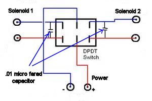

Switch wiring:

BTW, what are the caps for, what wattage?
Many thanks again.
Cheers
Marc
33,592
8,831
The caps are to take in the collapse field voltage from the solenoid coil, it keeps it from arcing the contacts on the switch.
Caps are not rated in watts, just use a ceramic non-polarized capacitor.
