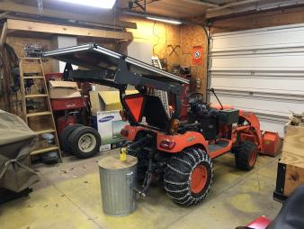

So, how do you open that hood? It's gorgeous mind you, but getting the hood open looks to be a PITA.
Not a PITA at all. It just flips forward. Works better if the bucket is up to lay it on.

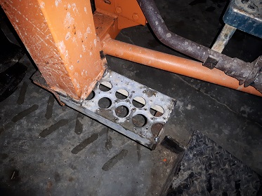

Step on the bottom of the loader tower.
