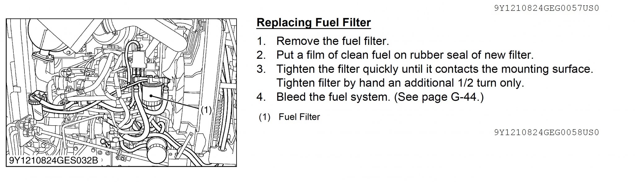

L4060, I thought I bought all the filters for it except the fuel bowl filter. What is the filter that is above the oil filter? It looks like a hydraulic filter, but find no mention of it in the 50 hour service.

I have a L3560 and changed the fuel and oil filters this spring, that is the fuel filter. I also changed the bowl filter and cleaned up the bowl as well. I still need to do the HYD. filters but I'm waiting for cooler fall weather to do it.

Fuel filter likely, see attached
Thats what I thought but the fuel lines coming from the separator didn't seem to line up, and one line appeared to run to a cooler in front of the radiator which made me think it was another hydraulic filter. I took the manuals out and put them, somewhere, the other day to check what needed to be done, and now not sure where I put them, hence the question.

You are correct there is a cooler, but it is for the fuel.
It gets packed in there with a cab. In front of the radiator is a cooler for fuel, hydraulics, and ac cond.
