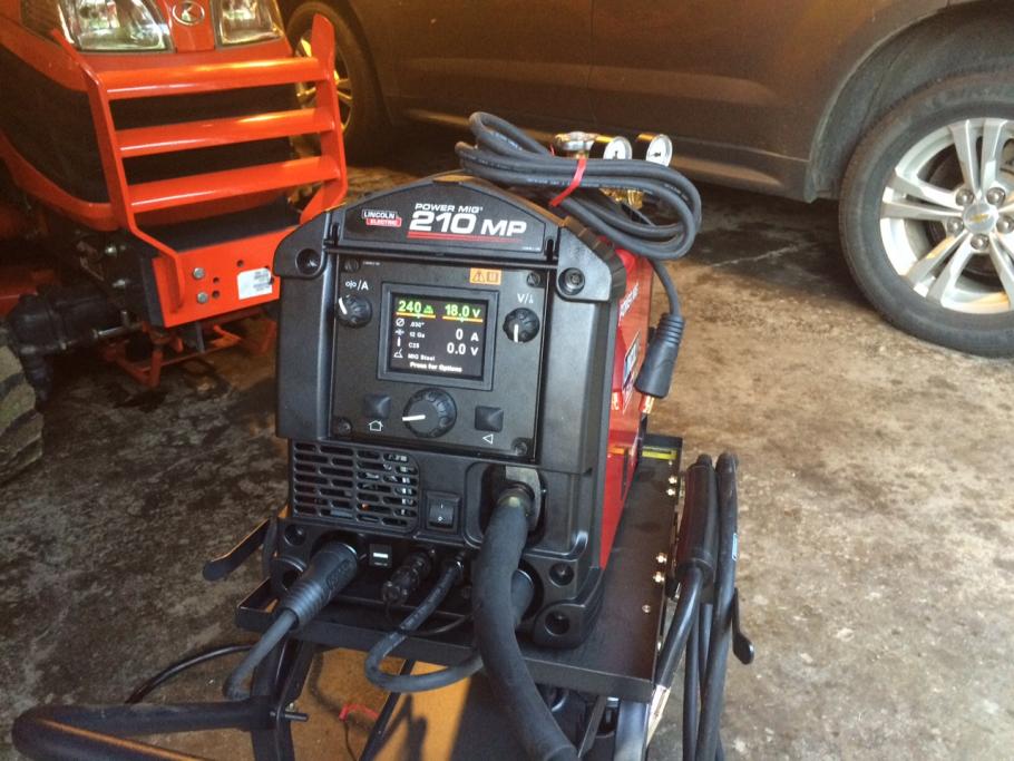

Here we go! Fresh outta the box!!:p
That's a pretty sweet and versatile machine. You should be really happy with it. You'll be inventing and making up projects just to use it :D

Wat???
Dont Need no tv on a welder!! Never gonna get any work done playin with it.
Are you sure we were looking at welders? No rust, no dust, no weld splatter...More shine then my tractor when it was new.

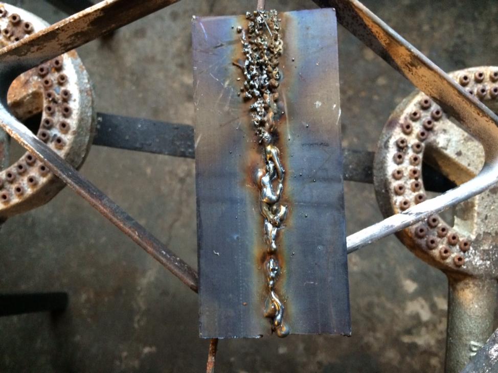

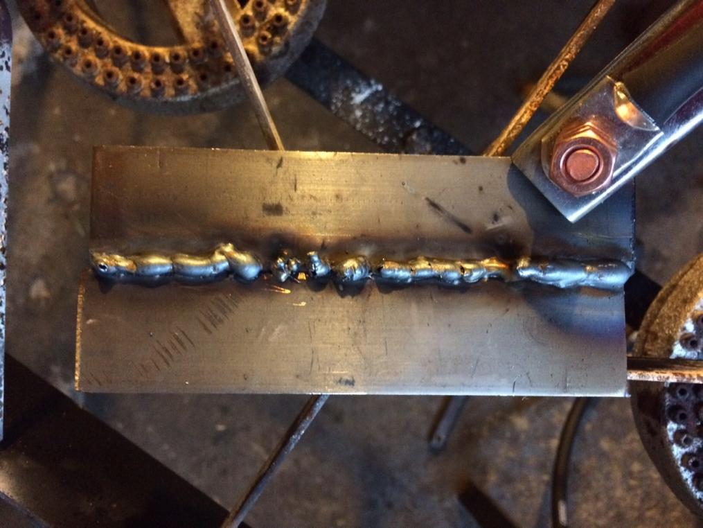

Did my first bead with the Lincoln 210 MP. My first trip with a MIG.
Started okay, could use improvements, but went to crap.
It did burn through well.
Got better with next few beads.
Slow down a touch, and use a circular pattern overlapping about a third of the puddle when starting out and getting used to it. :) and position yourself where you can get a good view of the puddle :) you can work on a weave pattern later ;) get yourself some nozzel gel since your using a mig, if they didn't reccomend it when you got it. It helps prolong the tip, and keeps the slag from building up in it. :D
If you have the cheat sheet for settings, make sure and reference it. It will get you in close. I use a little key chain gauge for checking material thickness. It helps tremendously. After you get used to it, you can fine tune the settings for your technique. Keep it up, you'll get the hang of it :D

Thanks - I got better.
I may be looking for more advice as I use it more.:p:p

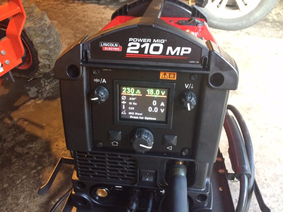

Daren - this is an inverter, doesn't draw a ton of juice. 15A at 110, and 14.7 at 220.
I only have 110 in the garage.
Thinking of trying it on my 5500/8250 (start) generator. Some stuff I saw says its generator compatible......

I have no clue on using one with a generator. They should have ratings for the 110 volt and the thickness of metal it will work up to. I think it's either 3/16 to 1/4 inch. Are you using flux core wire, or steel with gas? :) what size wire are you using :)
Right now using 0.025 with gas. (Sample roll that came with the welder)
I intend to go to 0.030 with gas. Seems to be the common wire.:cool:

I use the 030 in mine, buts it's flux core, so the metal in it is around .020 ish :rolleyes: I use 035 with argon/co2 mix at work with the miller 252. But we have a 220 hook up for it. That miller is a Cadillac compared to what I have at the house :)

Not great - but I think getting better. Some of the "skips" were on purpose - just learning...
Just 1/8" with 110v. 0.025 wire with gas.
