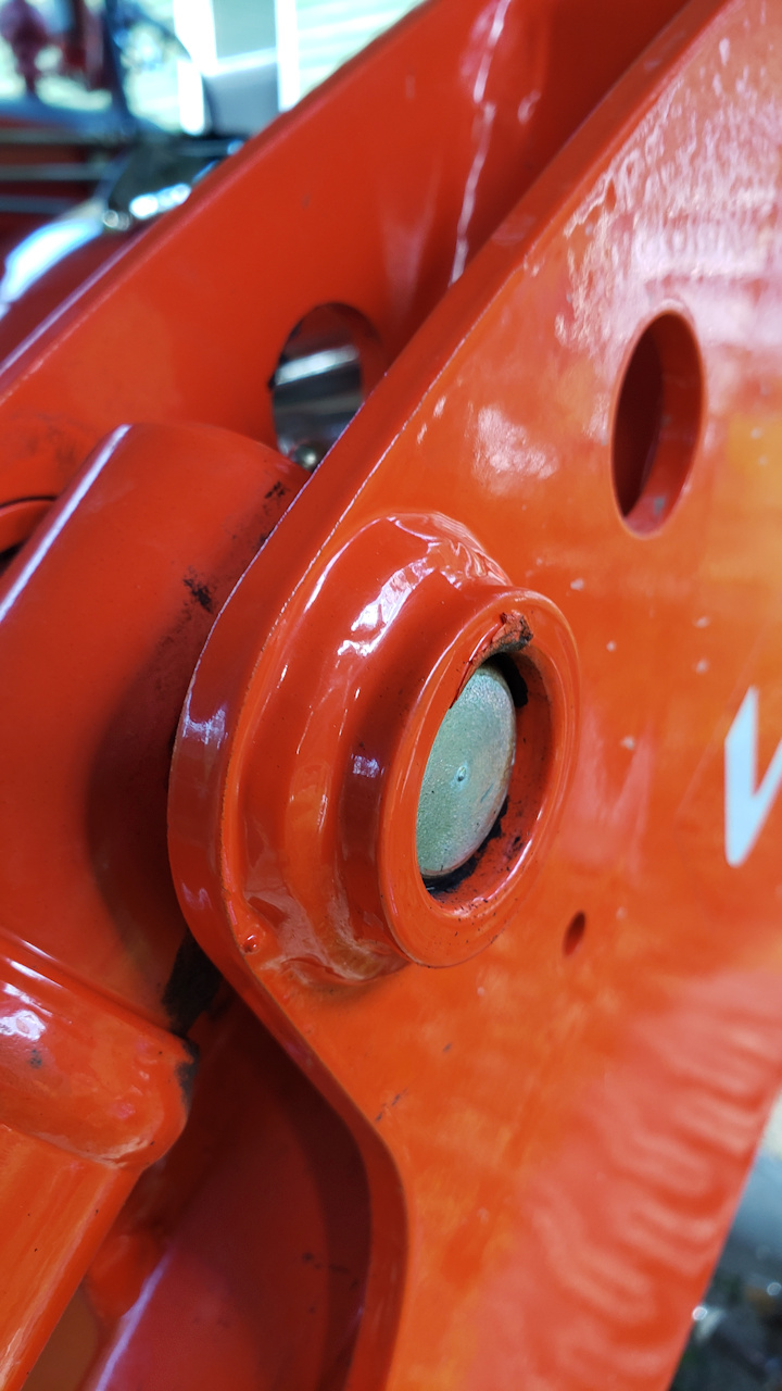

I had to spread 3 loads of asphalt crush the other day. I had to carry each bucket around a garage on a slight slope and then into a new driveway out back. The slope was not severe (I was safely carrying full buckets) but it was a side force for sure.
Doing my washing/inspecting after the day was done I noticed my curl piston top supports were visibly bent out. I remember several other people having this issue with the L534 but thought mine being a 2019 would have been updated/fixed. No joy.

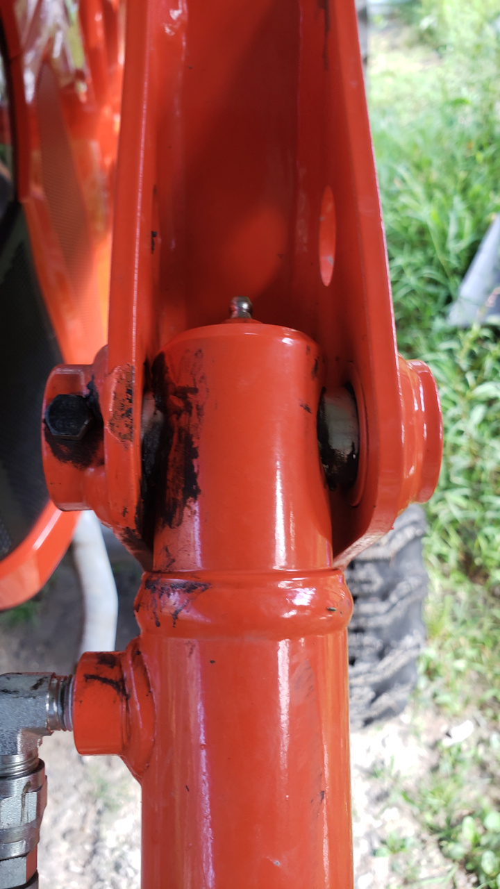

I ended up making some 1/4" plates and welding them on. I did not want to drill/tap/washer the pins as others had done because that would not address the weak point. As much as I didn't want to ruin the factory paint on the FEL I felt it was the only way to fix the problem.

I’m sure you looked at it but will the plate ever hit the hydraulic cylinder or grease zerk during the range of movement? Looks fairly close in the pictures but I don’t know how much it moves in relation to the plates.
It just clears.
The zerk has plenty of room to get to.

In my case it is the L534 and it happened in the span of two hours distributing 3 loads of material.
Obviously, the brackets are the weak point that is affected. To me in order for that much side-loading to happen, it points to an overall weakness in the frame or design.
