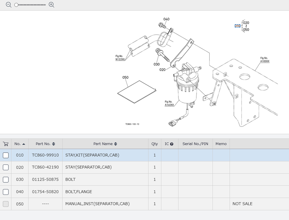

How can the kits be so different in price? I would assume that there are more parts in the ROPS kit. The weight of the ROPS kit is shown as 1.83lb whereas the cab kit is shown as 0.70lb.
The kit for the cab model at Messicks is $59.69
The kit for the ROPS model at Messicks is $855.42
Service guy was shocked too. No idea, has to be a mistake, that is company/dealer wide.
Kubota site has a picture of the rops version, just looks like some flat bar with a few holes in it to me. I didn’t check the cab version.
I agree with you that there must be an error with pricing. It's a bracket with a couple of bolts. Even at $55 it seems like a rip off.

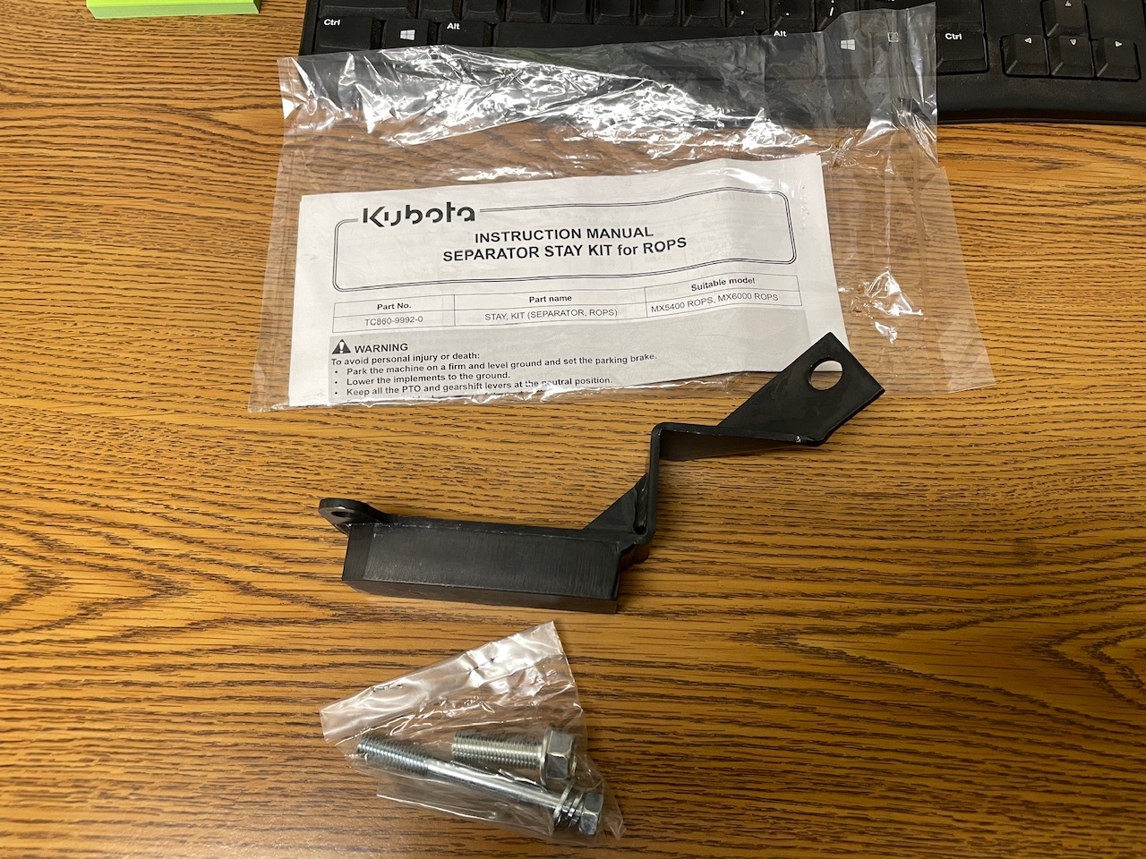

I’ll add this here too. This is the bracket for rops that the TSB relates too.
