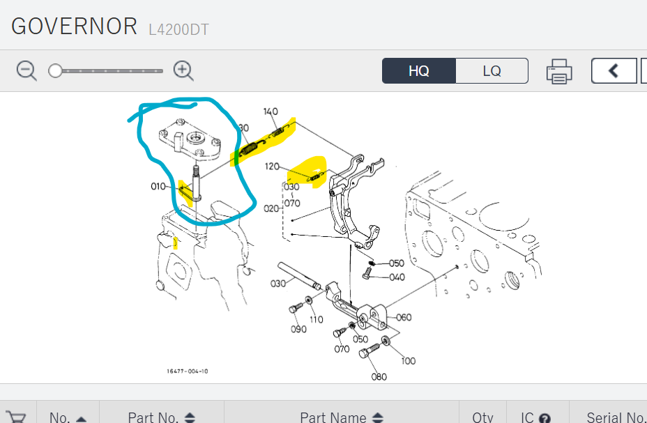

got a bore scope?
You could pull the speed control plate and look in there.
You don't need to mess with the governor or the filter housing.
Just pull the speed plate in Blue and remove 2 springs off the arm, then one spring off the pin in the gear case cover.
Pull the crank pulley and off it comes.

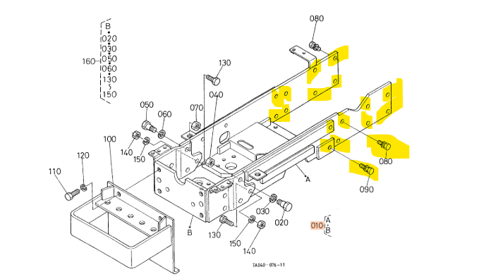

Don't pull the motor, just drop the front frame and the axle down.
There will be these bolts attaching the front frame to the side of the engine.
Support the engine from the bell housing and after removing the bolts you can lift the engine enough to get the cover off.
