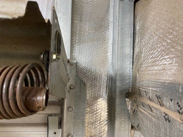

re: Couple of weeks ago the pipe that goes from side to side where the springs are and supports the door got cut through and dropped.
'pipe' ? you mean the 'torsion' bar ? Mine are SOLID bars not 'pipe' (which to me is hollow )
As you can see, it's a pipe and not a very thick walled one either, almost like electrical conduit.
Anyway, found a guy that's local, so he'll get the new door and install it, no road trip for me to pick one up.
Anyway, found a guy that's local, so he'll get the new door and install it, no road trip for me to pick one up. View attachment 77332
It looks like the tube was worn through by rubbing on the thin support plate.
Is there a missing bushing (bearing?) that the tube should be in?
13,079
5,762
Ok, I zooomed up the picture, understand the 'rollup door' now. That spring ain't a 'normal' GD spring....well , for me ! Also understand the 'preloaded' reference, cause panel doors ain't !
There's a small hole in the tube, wondering if the tube should be though the bearing support and some bolt or screw in that hole ? Something should mechanically keep the shaft from going left-right-oopsy out the of the bearing ? I'd still spray the spring with some kind of 'oil', rustcheck though.

OK, there was a large cotter key that kept the shaft from shifting.
What happened was the bearing froze, and after several years, it cut the thin walled tube, then the shaft fell, only to be supported by the spring.
13,079
5,762
sad, bearing 'froze', probably due to not being oiled 'once in awhile'. The springs should have a light coating of 'sticky' oil on them as well.
