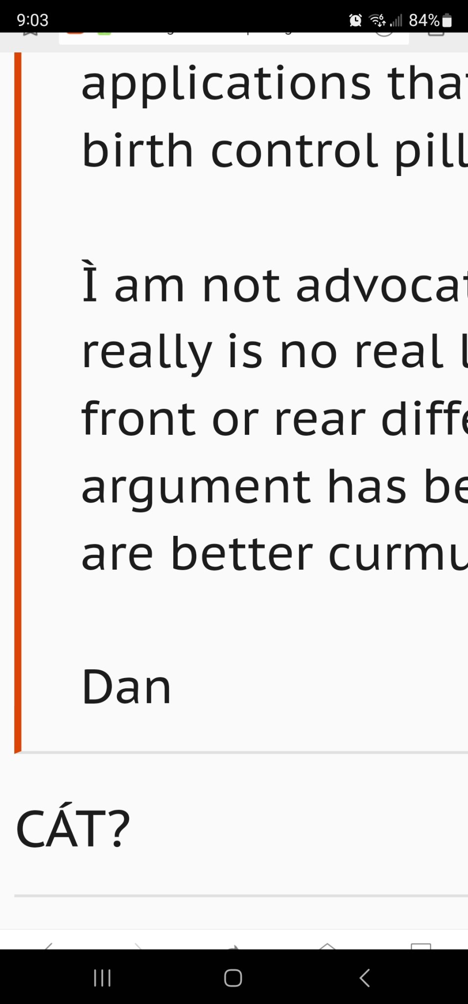

CÁT?

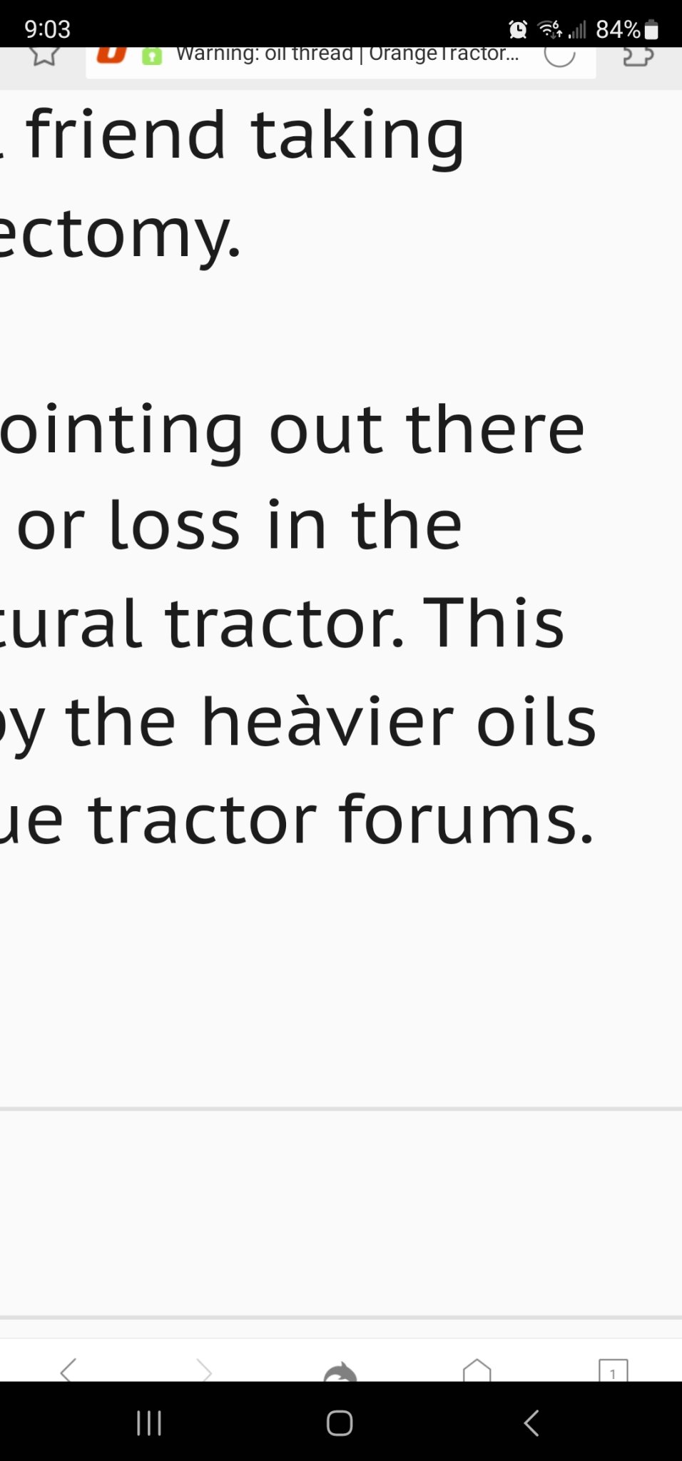

Hagrid that's a little too opaque for me to decipher this morning.
I will assistify...
In your post listing various manufacturers that used an 80 grade oil in their finals you didn't list Caterpillar. You also got fancy towards the end with accents over vowels.
Attend your eyes and behold:
I saw an opportunity to combine two areas of interest with one finely hewn response, also incorporating the additional attribute of brevity.
