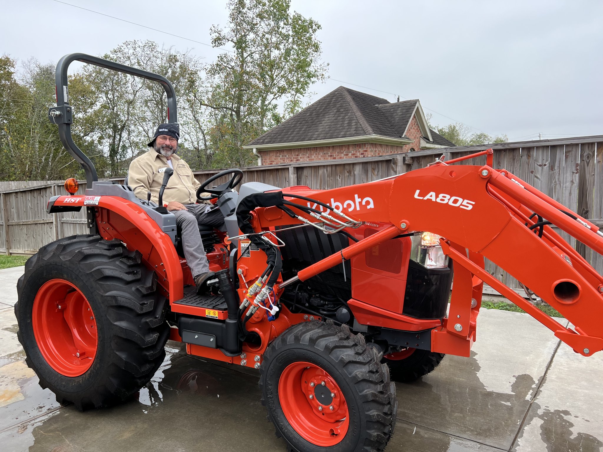

Hello Everyone. I’m new to the group and this is my first post. I would like to install 3 rear remotes to my new L3560 HST Limited. Is there one kit I can buy with all the brackets hardware hoses valves levers O rings etc. If so can you provide a link?
Thanks for the help

I'd recommend contacting Messicks directly and asking them.

Yes. Actuslly sold as muliple wholegoods kits by your friendly neighborhood Kubota dealer. The wholegoods kits for three factory remotes will run you better part of three grand.

Summit hydraulics makes a hydraulic multiplier where you can turn one remote into six or eight for way less $$. Good Works Tractors features them in his videos and gives a discount code as well.

Kubota sells packages with the parts needed to install rear remotes, though there is no single package for installation of three remotes. Such equipment is considered wholegoods so will need to speak with salesperson rather than parts department. Will need to specify type of valves desired. Expensive but everything needed included and will fit.

I have 3 Kubota rear remotes on my L3560 LE (2 regular and 1 float) installed by the dealer before delivery. They work well and I couldn't imagine having my tractor without them. I am sure aftermarket works just fine, but I wanted the Kubota ones. If you search YouTube, there's a good video on installing them.

That is a nice tractor! I'm jealous. What will you be running 3 remotes for?

Our Universal Rear Remote kit would work great for your tractor. The only thing you would need to complete the kit would be hydraulic hoses. https://summit-hydraulics.com/produ...ct-tractors-two-spool-three-spool-four-spool/ If you have any questions about the kit, you can reach us at (602) 806-7173 or at contact@summit-hydraulics.com
