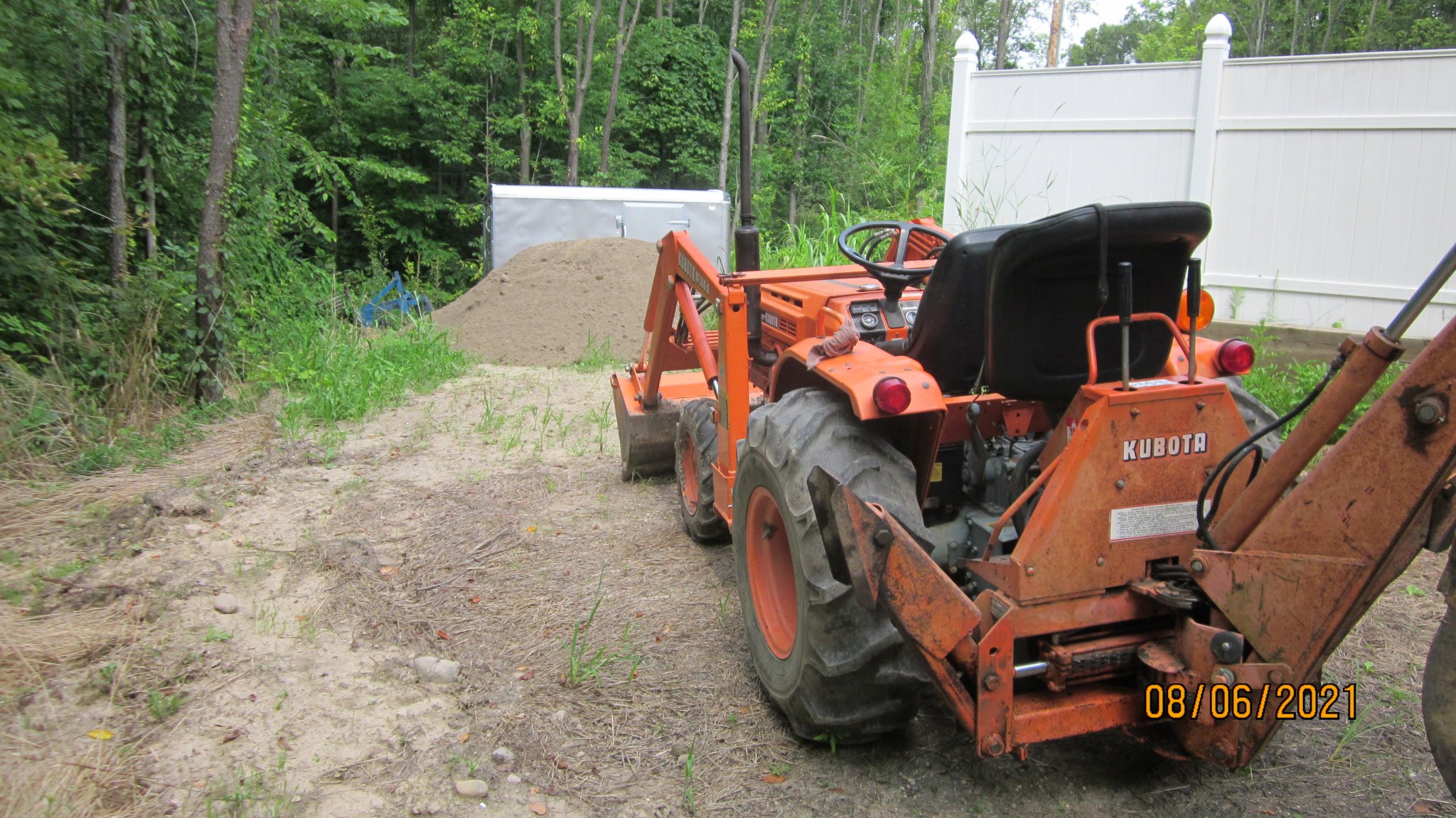

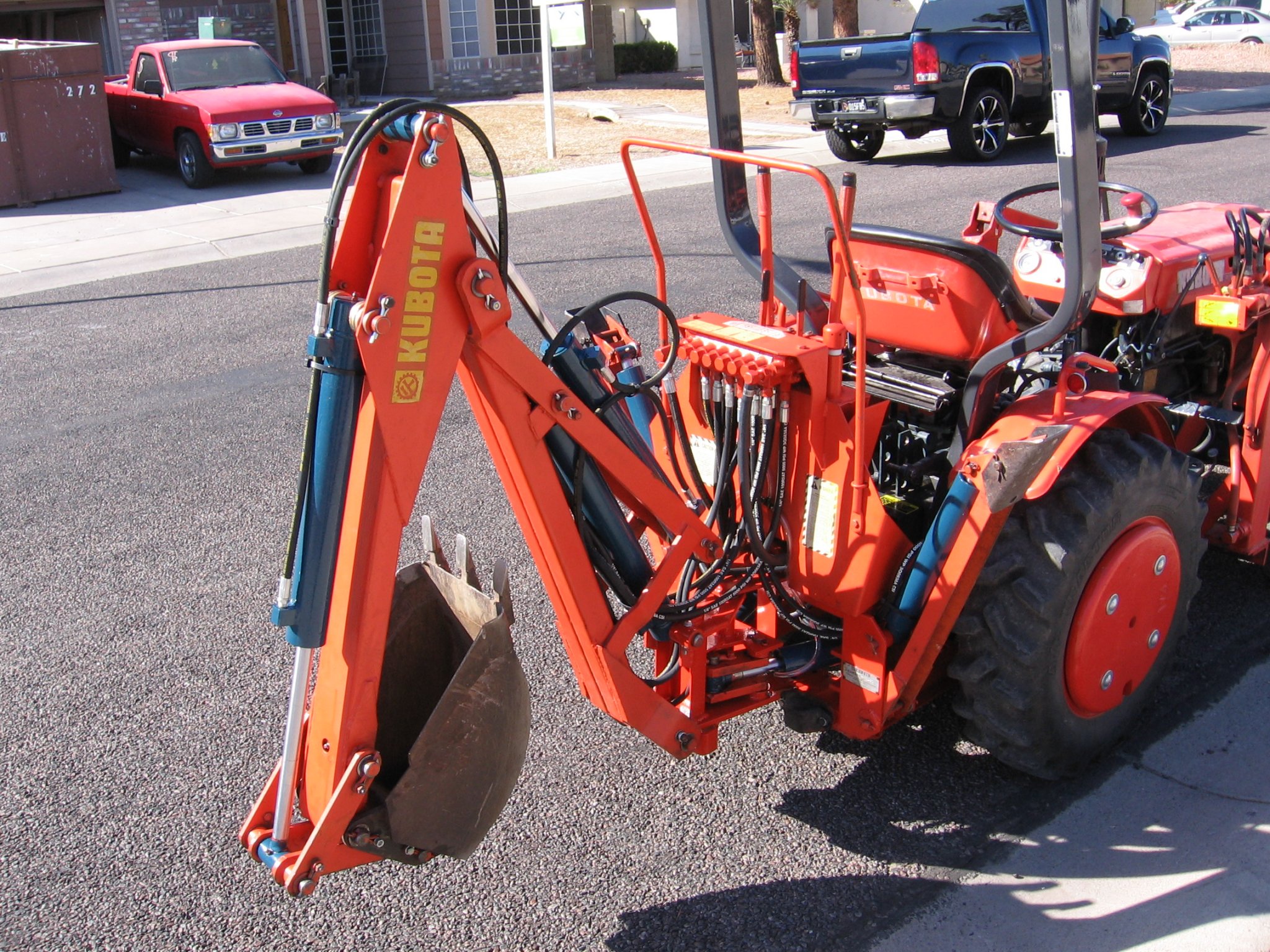

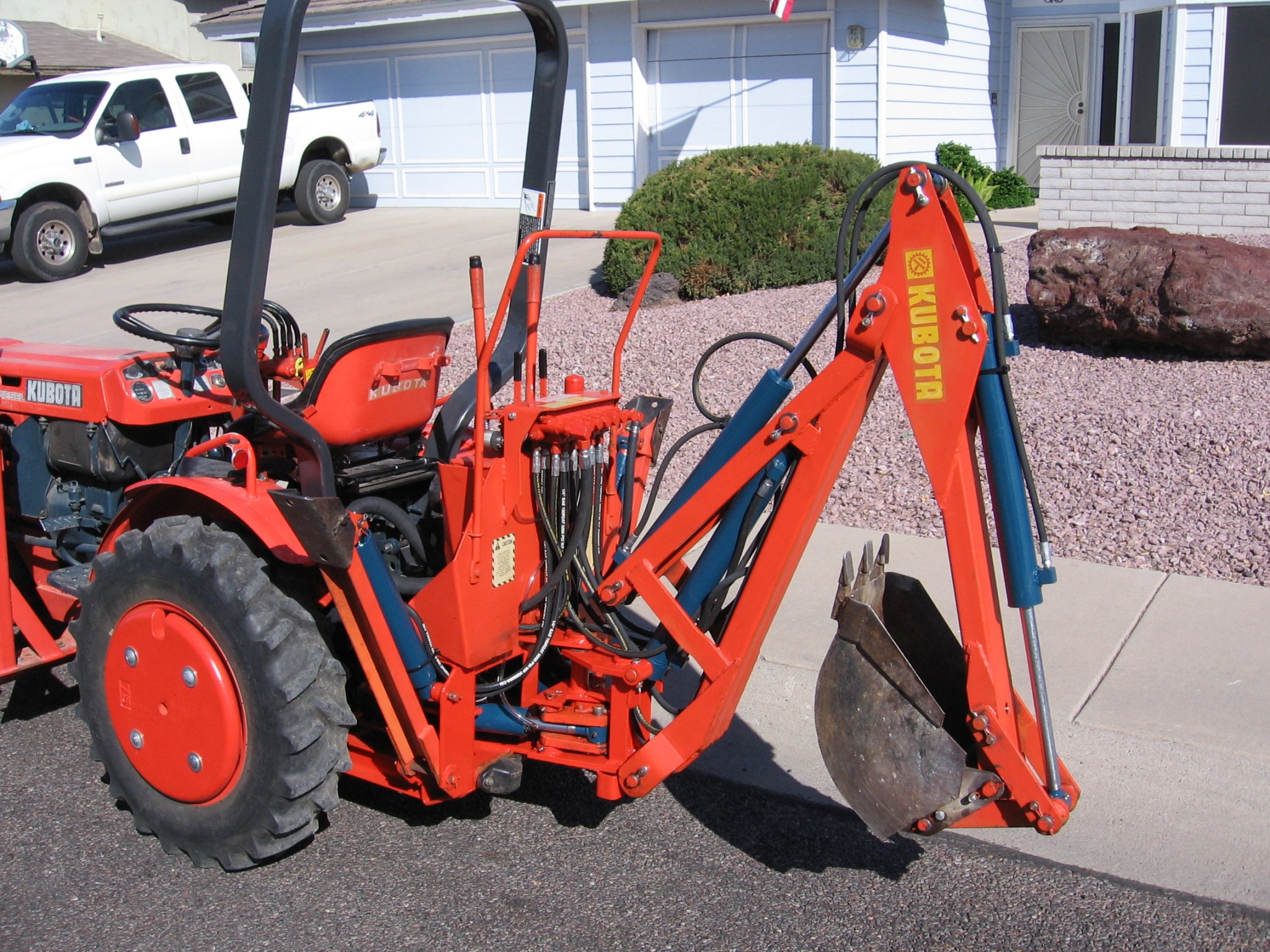

There is the subframe mounted, PTO powered B670.
But they are pretty rare, and usually beat up.
I have this one, and another that is so bad it is essentially an ugly parts pile.
