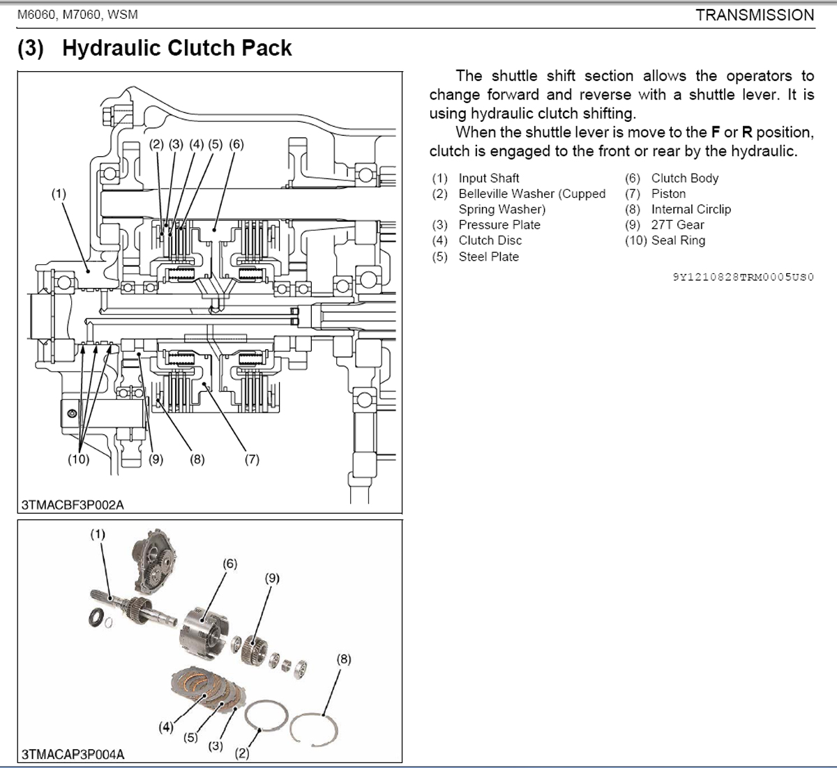

So to clear up my apprehensions first, what does Hydro Shuttle (which I understood to mean I could change from forward to reverse and back without using the clutch) actually mean in terms of the transmission, drive and PTO drive of my Hydrostatic MX5200 compared to my proposed M6040 hydro shuttle, because I thought I was considering the M series to get away from Hydrostatic to get direct gearing to overcome the heating associated with the hydrostatic oil getting hot issues associated with the workload of cutting all day in summer of thick vegetation with the MX hydrostatic tractor and thus also get better fuel consumption because of that direct drive rather than 'oil' drive???

From
From what I understand the hydro shuttle uses internal hydraulics to switch wet clutches internally for f/r, no clutch pedal, fine by moving a small lever f/n/r. A lot of industrial forklifts use this.
6,575
8,729
Maybe this schematic and photo from the M6060/M7060 WSM will help.

All of which means it's a gear drive transmission with hydraulics to shift from forward to reverse and automatically do the clutch for you. Completely different from a hydrostatic drive - the hydraulics are never driving the tractor, they're just changing gears.
