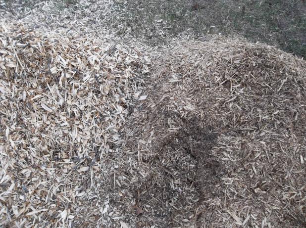

I use a BXM32 with my B2620. I put stuff bigger than 1" through the shredder. I do all my leaves and all the twigs from my maple trees and pieces of bark.
I also run stuff bigger than 3 inch through the chipper. No complaints so far other than I had to make some wooden block feet for it because my 3 point doesn't seem to lower enough to get it on and off with my quick hitch.
I can tell you....it literally turns leaves into dust. I blow them back over the lawns as I'm shredding.
The pic with my son is blowing leaves. The other two are the chipper results.

Looks huge but it carries it well. My neighbour who bought it for us uses it on his BX also. and he has no front loader for ballast.
It was a really nice gesture on his part. I maintain a bit of their property and do some of his maintenance, so he paid for a chipper/shredder.
It's rated for 3 inch through the chipper and one inch in the top shredder, but like I say I'v put bigger through it no problem. It just self feeds itself at it's own pace. Length does no matter.
I'd say I have put 4 and 5 inch maple hardwood through it.
