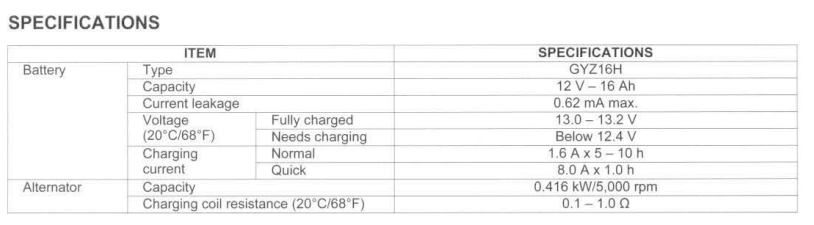

Specs for LiFePO4 automative 12V batteries say the charge volts needs to be 14.6VDC or less to avoid damaging the battery - even if the battery has a built in battery management system. The quad bike goes up to 15.5VDC, is there a simple reliable way I can reduce the 15.5 V to not more than 14.6? Charge current 400W at 5000 rpm.
Charging system specs:
Aftermarket VRRs are available to convert to LiFePO4 but I'm keen to avoid the hundreds of dollars cost.
Thanks for your help.

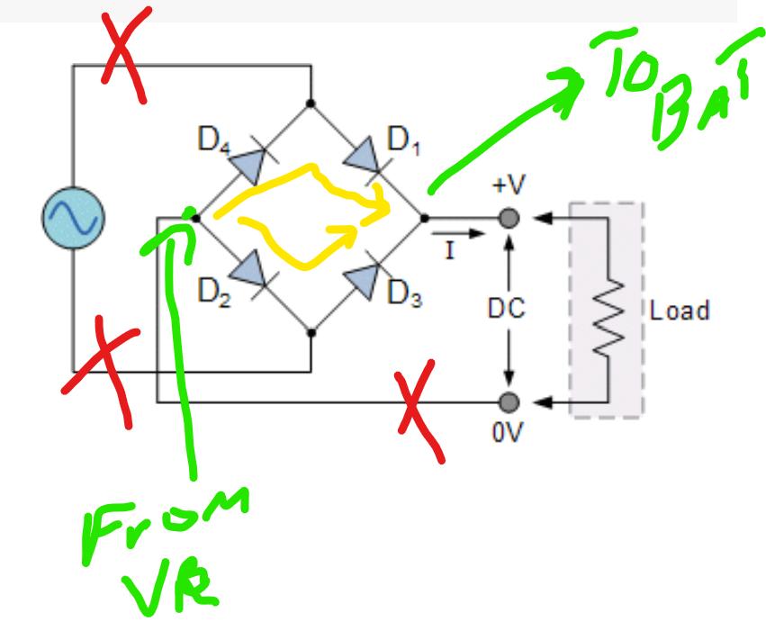

Hi GreensvilleJay, ctfjr, thanks so much. Looks like a great idea. I'll put a meter on the charging circuit and see what it actually delivers (manual says "up to 15.5V") to determine whether I need one diode or 2.
If I go the bridge rectifier option, how should that be wired in? Like this (to get 2 diodes in series)?
[Edit 1 - I didn't see GreensvilleJay's post above until after I'd put up this one. It might have answered my question here]
[Edit 2 - yes it does... I assume I bridge the 2 AC terminals too. Thanks!]

no, that won't work
try this
You will have 2 paths through a pair of diodes in each. Not a problem with two paths, you will just get a voltage drop equal to the pair with the lowest forward voltage drop (insignificant here). As a bonus if 1 diode leg fails it will 'fall back' to the other.
So your voltage regulator will connect to the "-" output of the bridge and the battery (+) will connect to the "+" output of the bridge.
Just 2 wires. NO ground wires.

no, that won't work
try this
So your voltage regulator will connect to the "-" output of the bridge and the battery (+) will connect to the "=" output of the bridge.
Brilliant, thanks!
