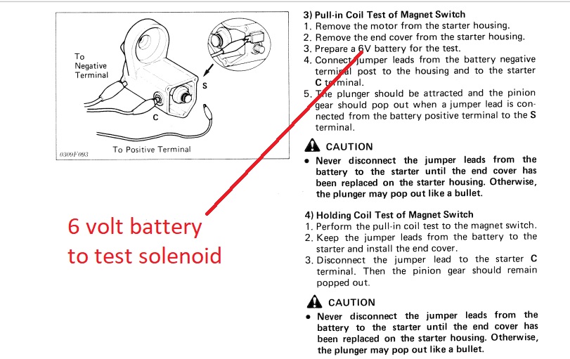

I was surprised to see the WSM has a 6 volt battery used to test the operation of the starter solenoid.

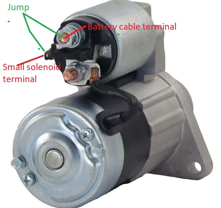

Have you tried jumping the starter to verify it itself is not faulty?
The jumping needs to be done with great care as you can get run over. Best to have someone in the seat with the brakes applied.

You could unhook the small wire from the starter. Have someone hold it in start. Use a volt meter to see where the drop is.
The terminal on the left is a pull in winding that draws a lot of amps.
The terminal on the right goes to the bottom post is the hold winding. Draws less amps.

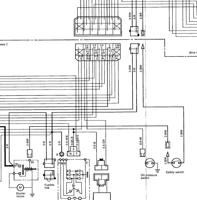

re: I was surprised to see the WSM has a 6 volt battery used to test the operation of the starter solenoid.
According to the wiring diagram, the starter solenoid has a 'tapped' coil so only 6 volts is needed to 'pull in' the solenoid. Once the plunger is down, battery +12 is applied to the coil to keep it fully down ,while the starter is spinning.
ANY resistance from the battery---?ignition switch--->safety switches-->solenoid will reduce the current to the coil. The JD 'system' is a 'bodge' to get around replacing bad ign switches, corroded wiring and funky safety switches. Replace all that stuff could cost $200+ so a $10 relay is a good deal.
