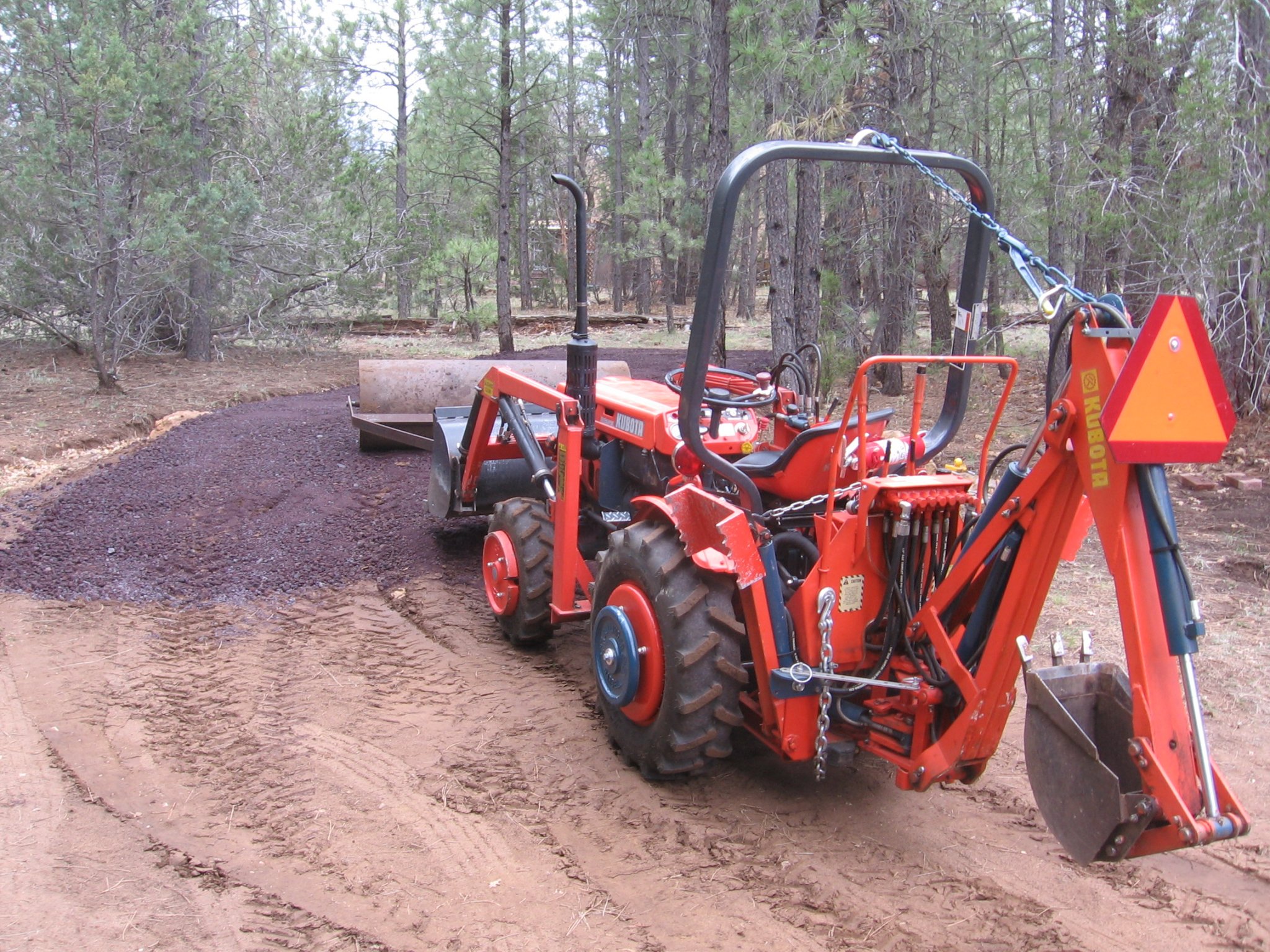

Lil Foot, what is the chain going from your ROPS to the backhoe boom. A boom locking device?
Correct.
Every B670 BH I have ever heard of will slowly drop to the ground, even after a fresh rebuild.
All the weight of the BH is help up by two tiny o-rings, about 7/16"OD, .050 thk. No seals, just not adequate. 1970s design.
Most folks just leave the PTO engaged, and every 20-30 mins reach back and grab the boom lever & lift it back up. Beside the unnecessary wear on the PTO & pump, I got tired of it, and did a proof of concept test with a ratchet strap. When that worked, I dug in the stash & built the chain/load binder setup pictured above.
You can also see a chain restraint between the outriggers, a swing lock, and the always attached pulling chain.
Roller is 60", 920lbs, and OLD. Guy I bought it from said 80+yrs. Easier to drag it, but much better steering control for those tight spots when attached to the front.
