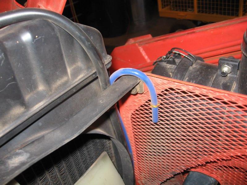

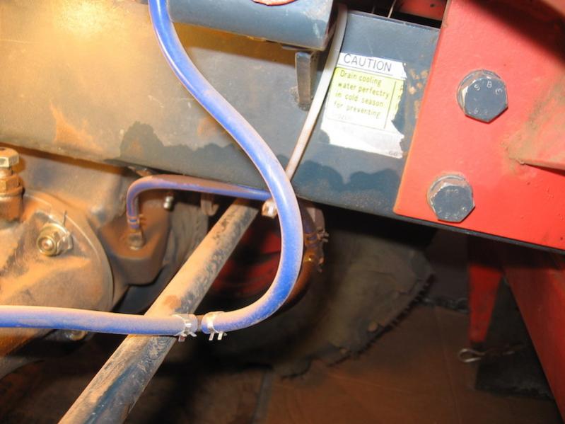

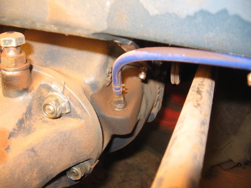

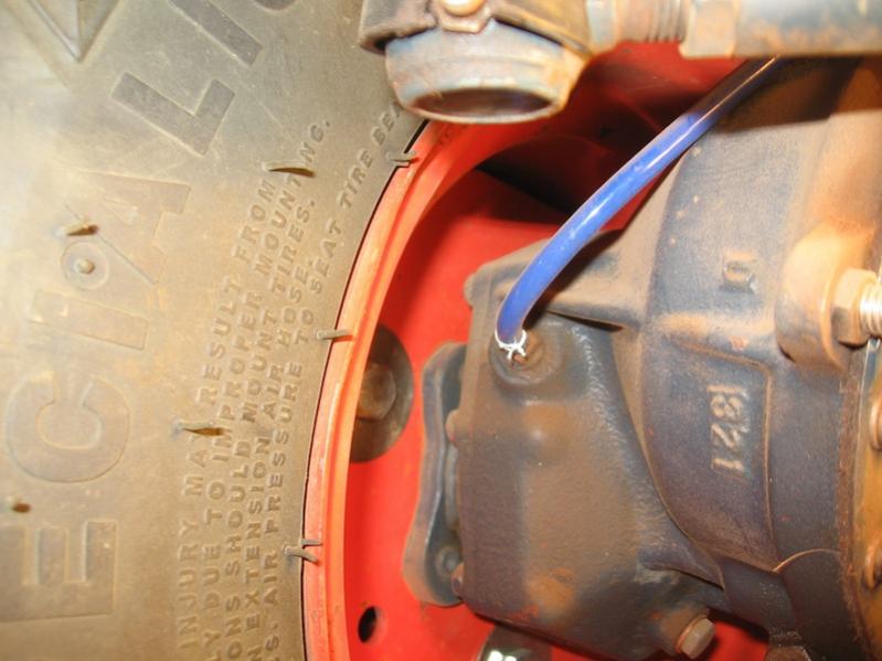

Axle vent-drill and tap for a hose barb fitting. Attatch and run hose upwards toward air filter and tie wrap to air filter housing. A small engine gas filter will help with dust intrusion.
The bota used at my past job was in the water submerged front axle at least 6 times/ year.

As i mentioned, near air filter. Some vehicle manufacturers vent at same height as air cleaner, i guess if it goes that deep its done anyway. Vent caps can difficult to get, a good gm parts guy may be able to locate. Those serm to be the most common ones on a hose.

i have been looking for a vent and there are small ones available thru our local NAPA car parts store but the styles i think would allow water in if the tractor was left out in the rain. I know the vent line up to the air filter would work but i dont think i would like the look of that and the line flexing with the axle might rub and the line would have a good chance getting caught on branches or something. My tractor axle never goes under water as im sure many others do not also. What i have found may work for me is a electric motor oiler filler. This is small and has a spring cap. It needs to have a threaded pipe soldered to it and a small foam filter put under the cap for dust. I still have to make sure the tractor filler plug can be drilled thru, but as of yet it looks like the best option.

I dont think it matters what you do, an ill- mannered branch is determined to remove your protective measure. A simple downward facing elbow would keep water out.
Some careful routing will get a hose up and out of the way, periodic checks are necessary regarless what is there.

I'm not sure what type of filler cap you have if it's the plastic one like Tooljunkie says, it's not hard to do just find a barb fitting (I got one at a Ski Doo dealer it's for the primer on the older sleds and I used plastic primer line for my vent hose) If it's the screw in like on a BX2230 Kubota sells one.

If you have a retail parts supplier that sells Fairview fittings they should be able to help you. Be sure not to drill in the middle of the cap, you want the hole beside the measuring stick screw in the barbed fitting install the hose and hopefully no more seal problem. We have 3 BX's since installing the vents we haven't replaced one seal, before we usually did at least one a year.
