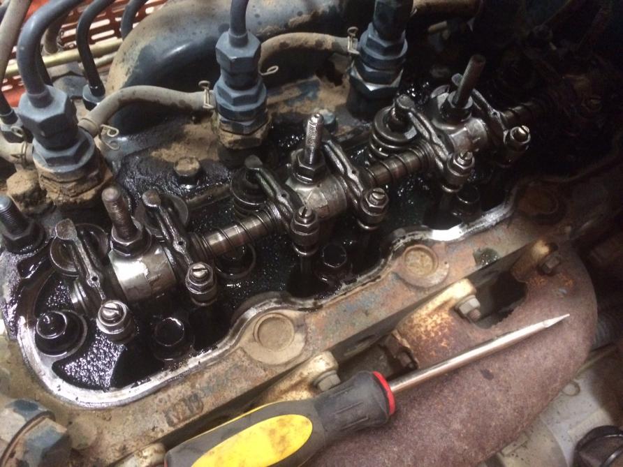

Been putting off checking the valve lash and finally got "arountuit" today. It was interesting in that three of the valves were excessively loose in the neighborhood of 0.025". These three were near the "radiator end" of the engine.
The three farthest from the radiator (at number 1 and 2 cylinders) were a hair snug so loosened them to get the 0.006" feeler gauge to slide easily. I used the mark on the flywheel to verify that the number one and then the number four cylinders were top dead center when adjusting according to the WSM.
I'm wondering why so loose on some and snug on others. The rocker arm jam nuts were all tight. I did check the rocker arm assembly mounting bolts to make sure they were tight.
Looking forward to working the old girl to see if setting the valve lash makes any difference.
Any ideas why so much variation?

I'm not a mechanic by any stretch but tried to follow the WSM exactly. Some of the valves were definitely in the area of 0.025" gap.
It seems odd that the first two or three valves at the back end of the motor were very close to correct where the rest of them varied all over the place.
Attached is the WSM page showing which valves are adjusted when the #1 piston is TDC and the ones when #4 is TDC. Sorry for the "sideways" on the pic.
I do appreciate your feedback.
