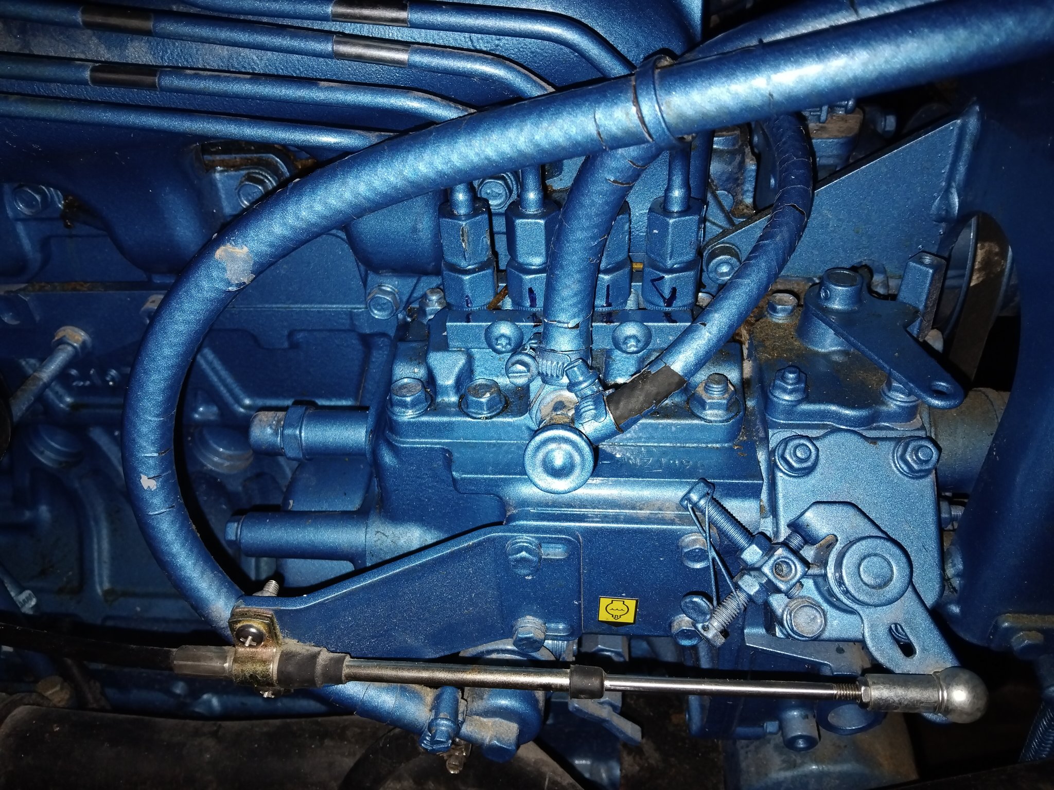

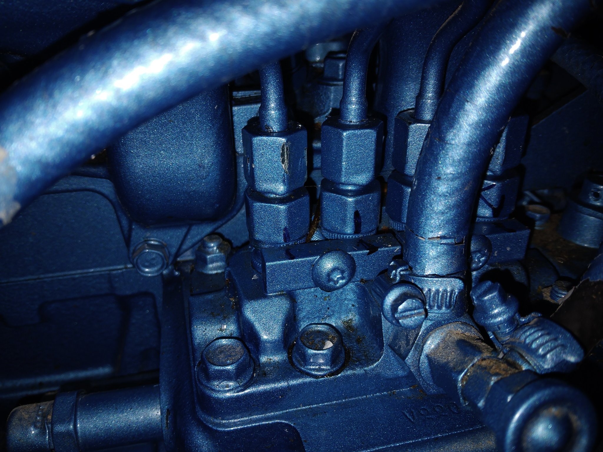

Ugg, those numbers didn't help me to help you.
Can you take a picture of the injection pump and the injectors?
33,035
8,468
Perfect, yes that should give me the answers I need, let me do some digging in the manuals and get you some info shortly.
